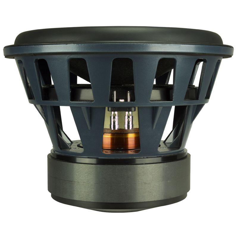

Hi thanks a lot for the very helpful advice. I think that there is a lot to be learned from the very best cabinet for subwoofers out there 🙄
When i look at what kind of beasts are some woofers ... the cage for them must be designed and built with very high standards indeed

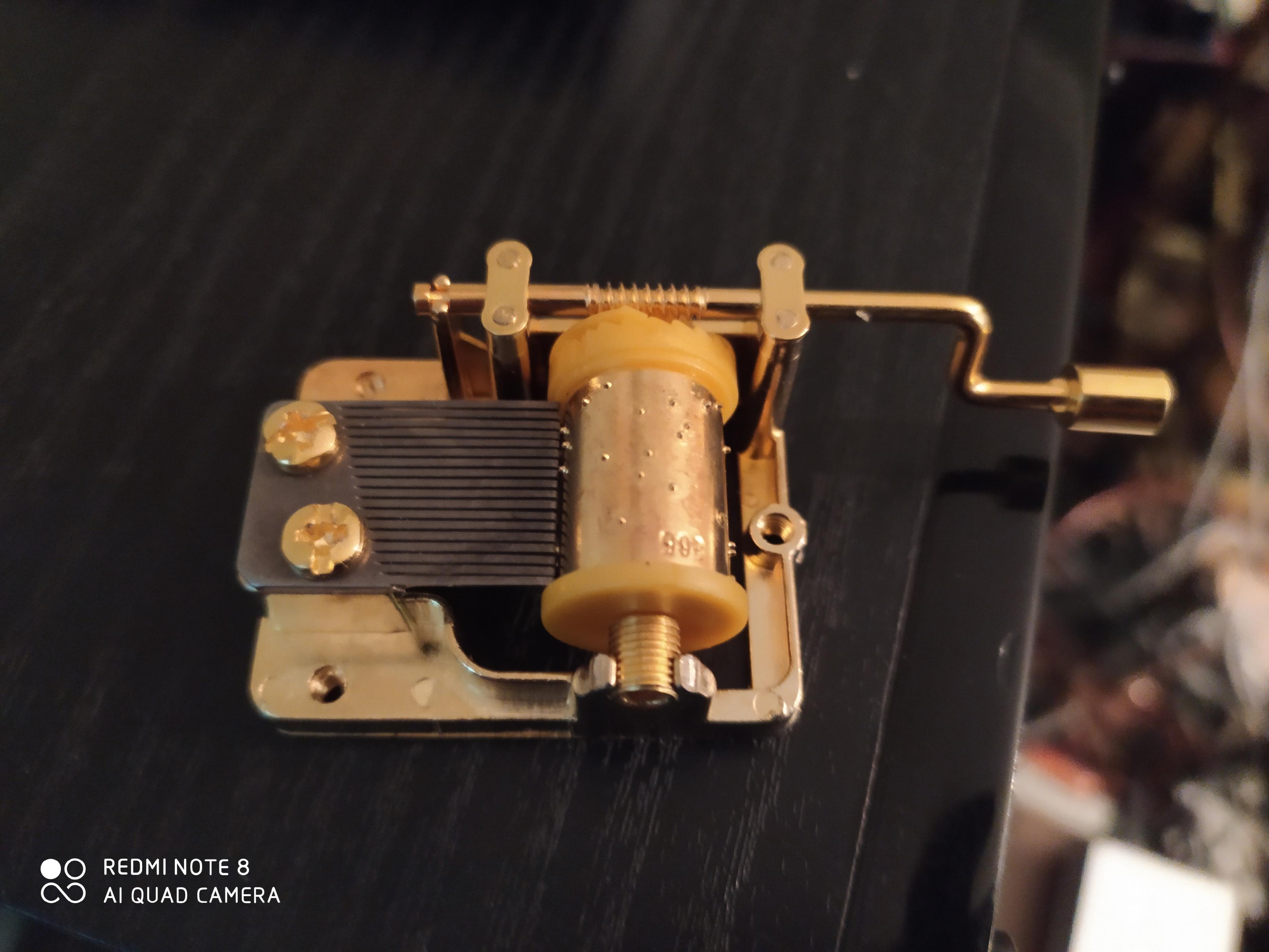

Hi ! some years ago i was at an audio fair and there was a man from the German speakers manufacturer Fischer & Fischer
FISCHER & FISCHER – High end loudspeakers made of natural slate
showing the non-resonant quality of their speakers cabinets using a mechanism similar to the one in the picture
Out of curiosity recently i bought the one in the picture
When actioned in open air its sound is barely audible
Then i placed it on my bookshelf speakers ... it sounds like placed on the top of a classic acoustic guitar 😱
Is this a very bad thing like i suppose ?
Needless to say that a similar mechanism placed on a speaker from Fischer & Fischer was sounding almost like in open air ... very impressive performance.
Quoting from their site
Building loudspeakers with natural slate cabinets is most logical. Due to its flaky, layered structure, its negligible re-sounding or re-echoing qualities and its extremely high mass, the material boasts extraordinary acoustic properties. The vibration-sensitive wooden loudspeaker cabinets customarily used deplete the loudspeaker chassis of energy because they incite the cabinet panels to vibrate. In slate cabinets, on the other hand, the entire energy of the loudspeaker is available to incite the surrounding air.
Amazing isn't it ?
