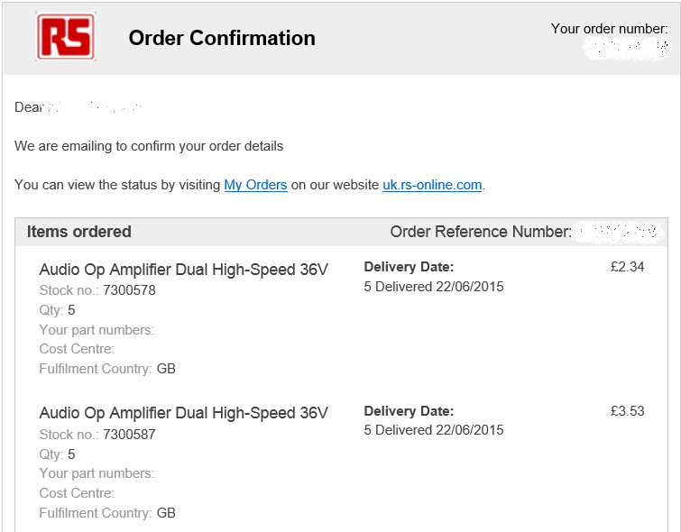

I couldn't resist having a play. I ordered 5 of the SOIC outline... I have a nice little use for those upgrading the opamps in a Sony Mini Disc recorder. I also ordered 5 DIP outlines for a play as and when.

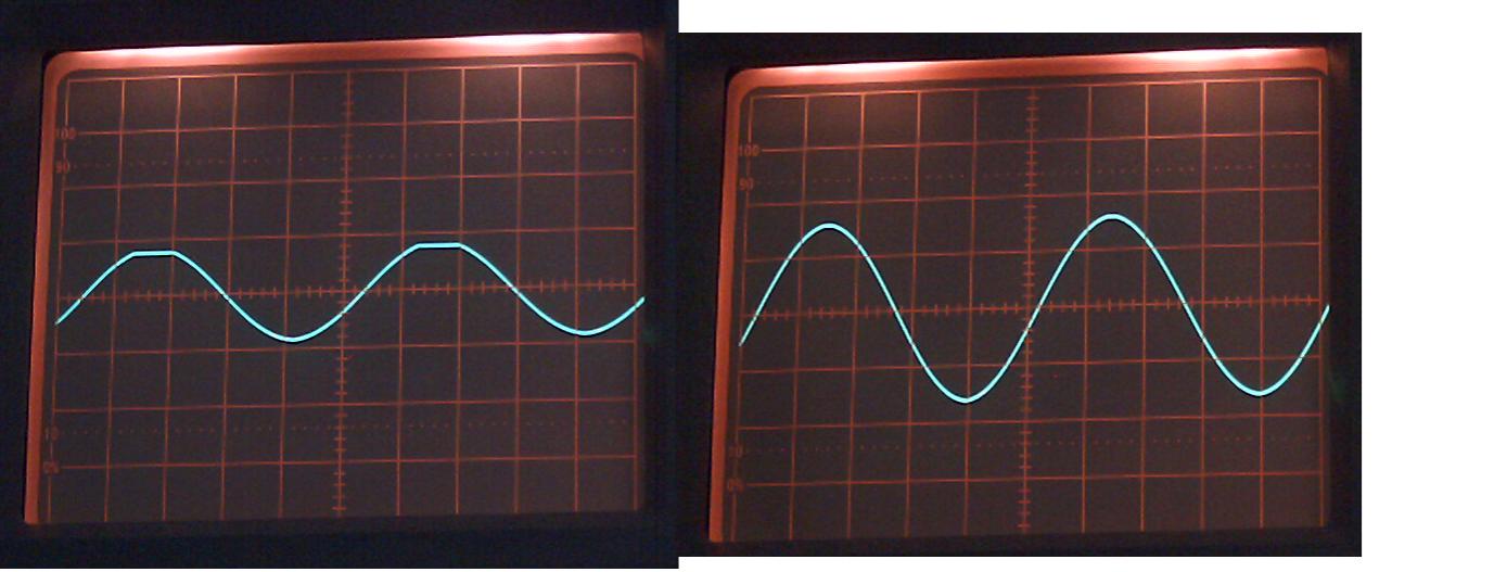

I've been very pleased with the smd devices I fitted into the Sony MiniDisc recorder, but this cropped up today.
http://www.diyaudio.com/forums/chip...32-power-amp-thoughts-anyone.html#post4390787
and this is the difference between the original 833 and the new quasi complementary offering. A remarkable difference in drive ability. Scope is on 5 volts/div
