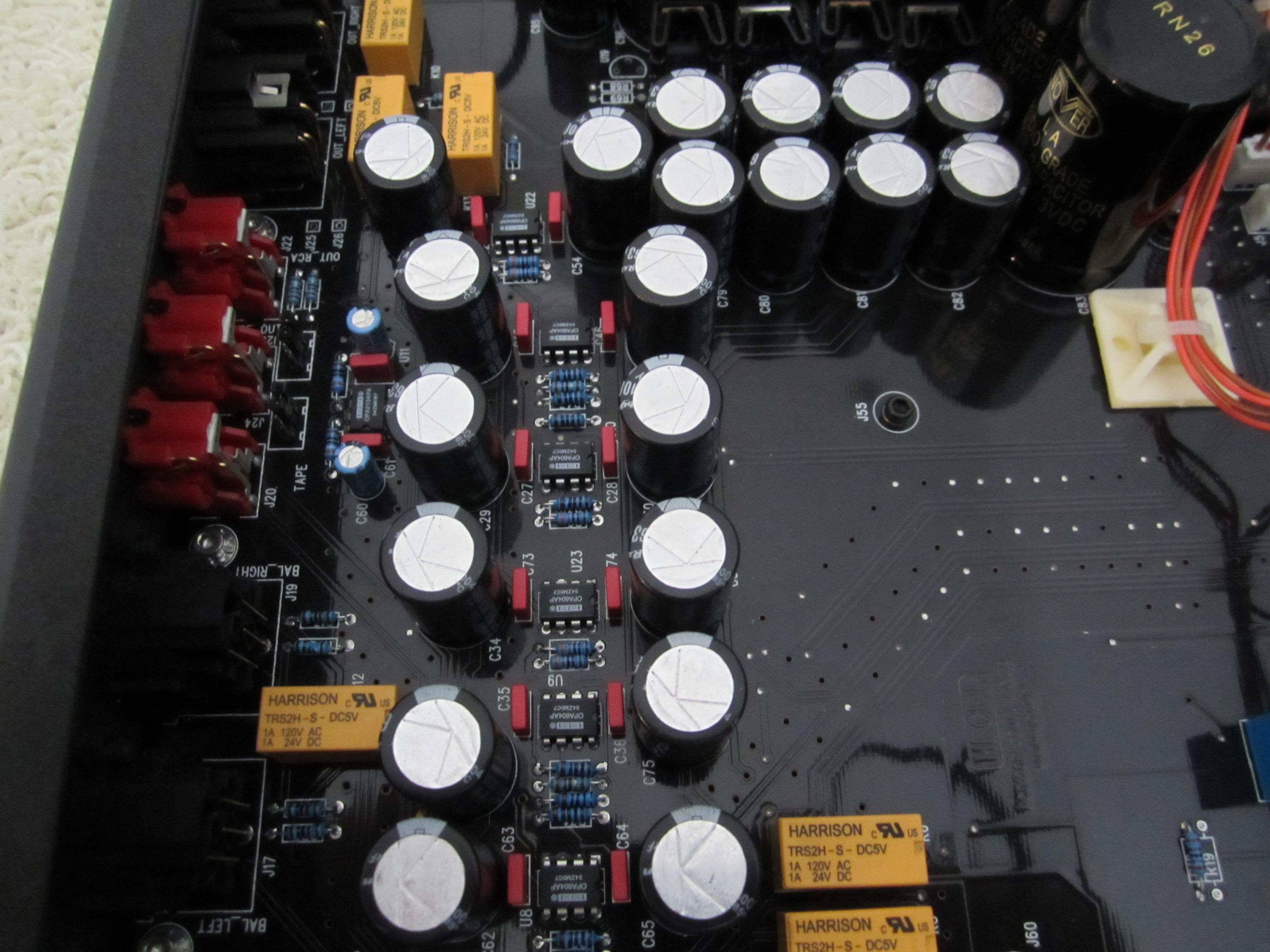

reading around i found this intriguing comment about using high value of uF very close to op-amps.
Ok .. maybe 6800 uF is a little on the high side.
But i see very few uF used normally. I have listen to a preamp based completely on opa604 with 2x1000 uF close to the opa.
It sounded both clean and not particularly solid-statish ... i would say very good indeed. Clean as solid state can be but also not hard or harsh.
What do you use normally ?
Thanks a lot, gino
I cannot agree with using 6800uF and you don't have noise. Noise is mostly from the input LTP that depends on input resistance and current......yada yada.......We all know that!!! That has nothing to do with power supply filtering.

You sure it's not sneak oil? Sure those people are not from the tube world? There is some truth that different tubes have different sound as they are really mechanical devices also.
Worry about ripple on the supply rails, after using 22ohm and 100uF, use a scope set in AC, crank to 2mV/div and to look at the rail. If there is no ripple, it's sneak oil.
Pay more attention to make sure you have bypass caps point to point at the supply pins of the opamp, have a good ground plane, make sure you have point to point connection at the -ve input pin, that's the most most sensitive pin of the opamp. If you drive coax, make sure you have a 200ohm( at least 50 to 100) between the output and the coax to avoid excess capacitance that kill the phase margin. Use a pull down resistor from output to -ve rail to keep the output in Class A.
All the talks, more than a few times when I looked at the layout of opamps on pcb, I laughed. It's the layout!!!! All the talks is going to be ruined by a bad layout. Then they turn around and blame on everything else.
