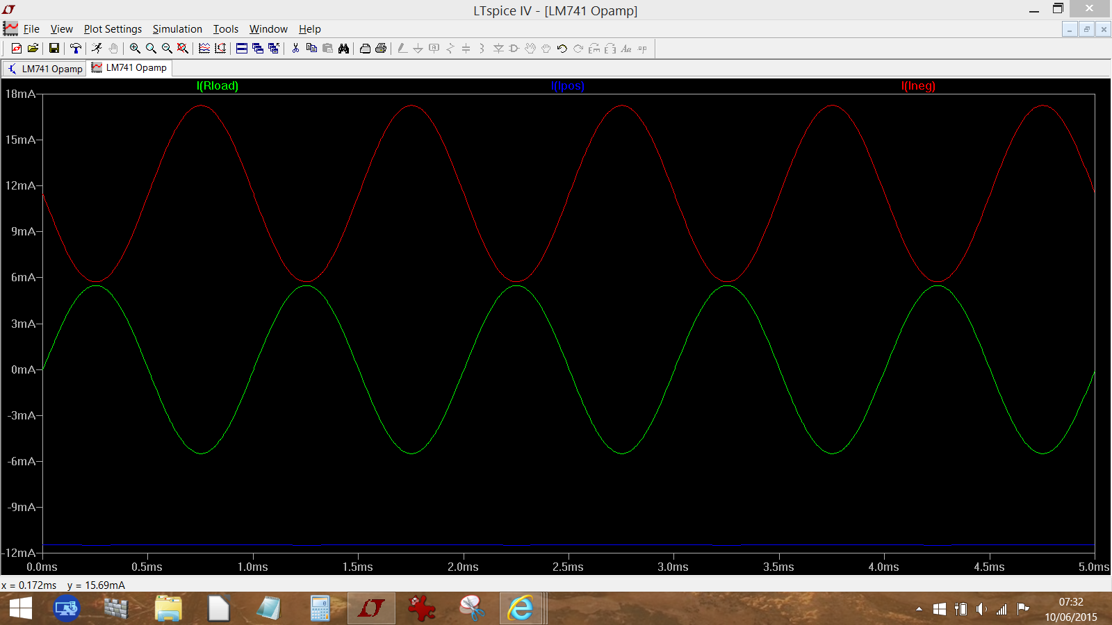

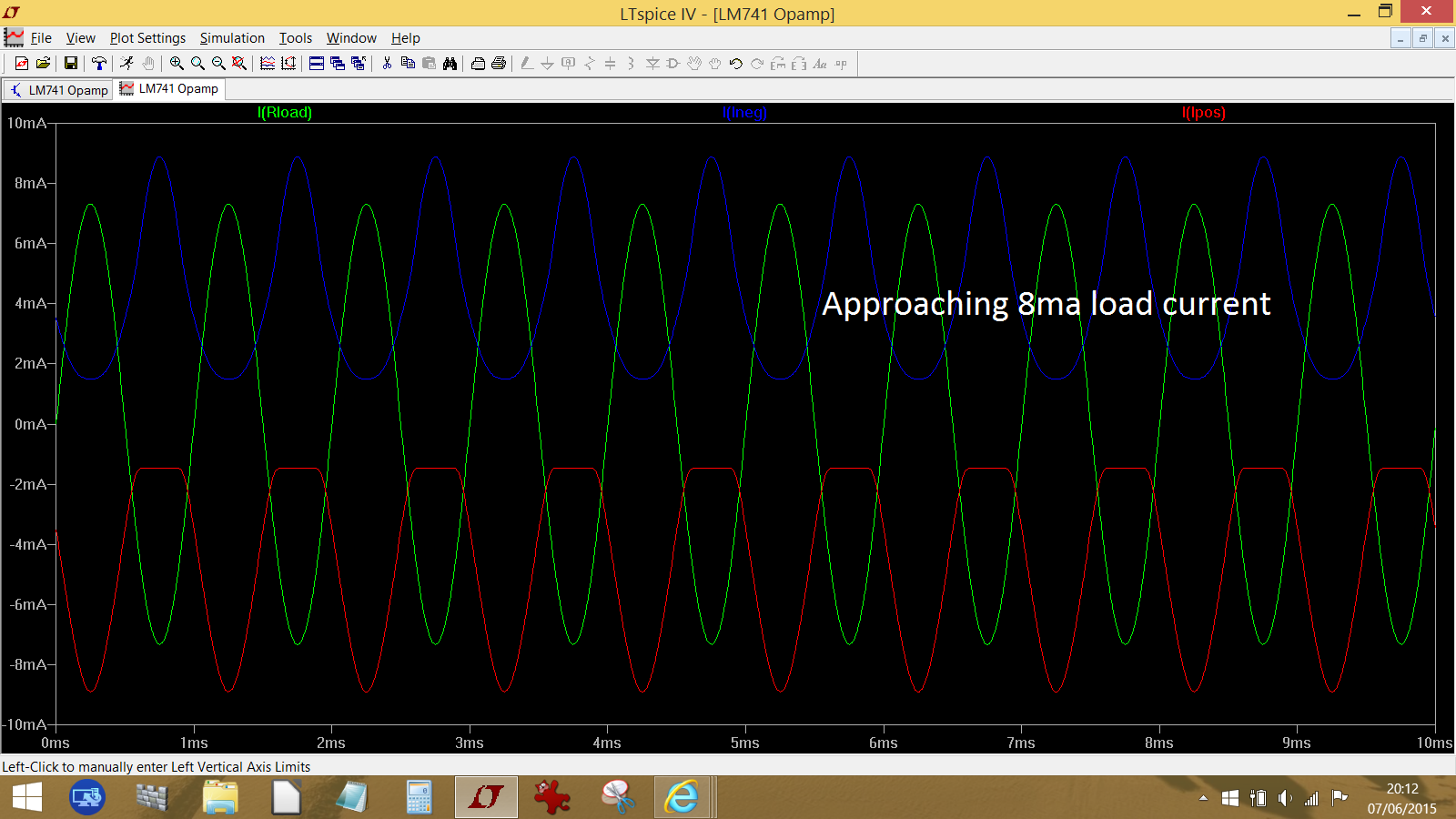

notice the visible 2nd harmonic in the supply rail currents in the middle pic ( approaching 4mA load current, is this = twice bias current?)
Hi Mooly! Thank you for reply.
I think you've got a good result, similar pictures I saw on my oscilloscope.
My result for AD843 (4 ma class A capability, hens 2 ma bias current) approximately corresponds to your middle picture.
Sure, the method is not accurate, been based on visual estimation of sine distortions (that item I started my post with). Nevertheless, it was useful for me, it turned out, the bias current was the small part of chip quiescent current, vice versa it takes place in ordinary (not chip) amplifiers and as I previously supposed.
By the way, is it really more easy to change load current changing the load, then the input signal level (I'm not guru in spice models, I use my own one's)?
It was an interesting little exercise and its always nice when simulation agrees with real measurement.
Erm... no special reason I did it that way other than hazy thinking that perhaps currents elsewhere could alter slightly if the level was altered. Decreasing the load seemed a safe way of pulling more current while all else remained the same.

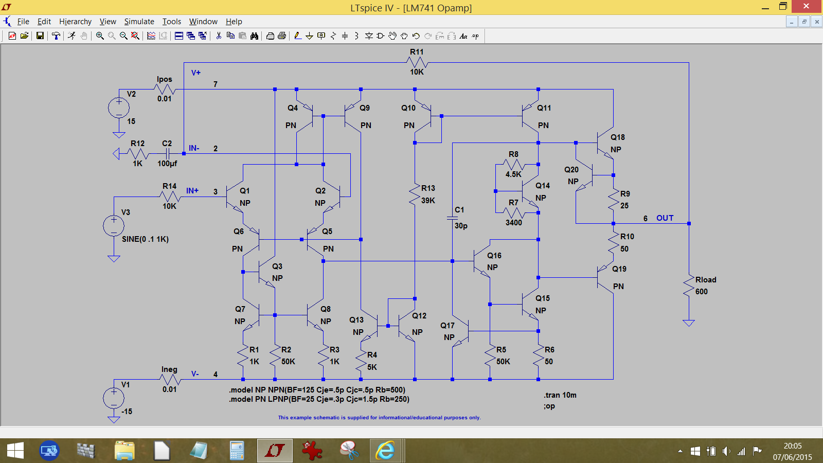

Nice sim. Shows when class A stars to turns to B. You could have just shin the output emitter currents, almost the same thing.
Thanks 🙂
Also works on power amps.
Yes it does, I tried it on Doug Selfs 'blameless' and it worked as expected.

On the 741 sim we can do the old trick of adding a current source (or sink) from either rail to the output to force the stage into class A.
This shows the effect of a 10ma current injection, first from pos rail to output and then the neg rail to output. We are now delivering 6ma peak into the load while still essentially remaining in class A.

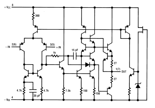

Re lateral PNP transistors - there was a case for preferring discrete component operational amplifiers in the days when design and manufacturing technologies were less than ideal in relation to today.
Problems with lateral PNP's were due to an inability to apply various masking layers with adequate precision.
40 years on this and diffusion technology has improved and ways have been found to avoid the use of PNP laterals where it might affect results.
The Texas Instruments LM833 has an all NPN output stage and apart from the absence of dead-band crossover distortion, it has symmetrical current source and sink characteristics, and an outside the box CCS is not advisable.
I can't see a reason for not using a CCS on the output of the LM833 - it looks to have the usual slow lateral PNP. Here's the schematic (from the TI DS) :
That is the original circuit given by National Semiconductor. Here is the link to Rev B from October 2014 http://www.ti.com/lit/ds/symlink/lm833.pdf the datasheet is long the circuit representation is on page 13.
I see a completely different output stage there - so then does this suggest the original circuit in the DS I found was incorrect? I can't believe they would change the design down the road.
<edit> there's one glaring error evident in this newer one - a MOSFET symbol is being shown (where there's bound to be really a JFET) in the biassing arrangement.
