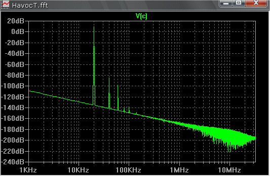

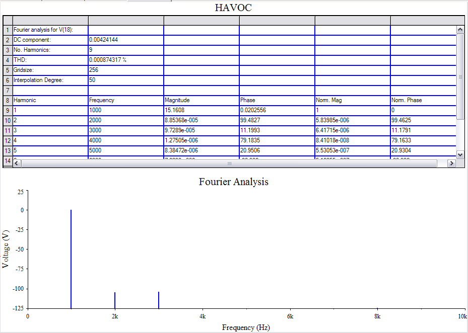

I'm liking the way this one looks in simulation. It has stronger H2 than H3 and not much above -125db for higher order stuff.
It has very good PSRR.
I would like to try the thermal trak NJLs as drivers, with their diodes looped into the Vbe multiplier. Something different.

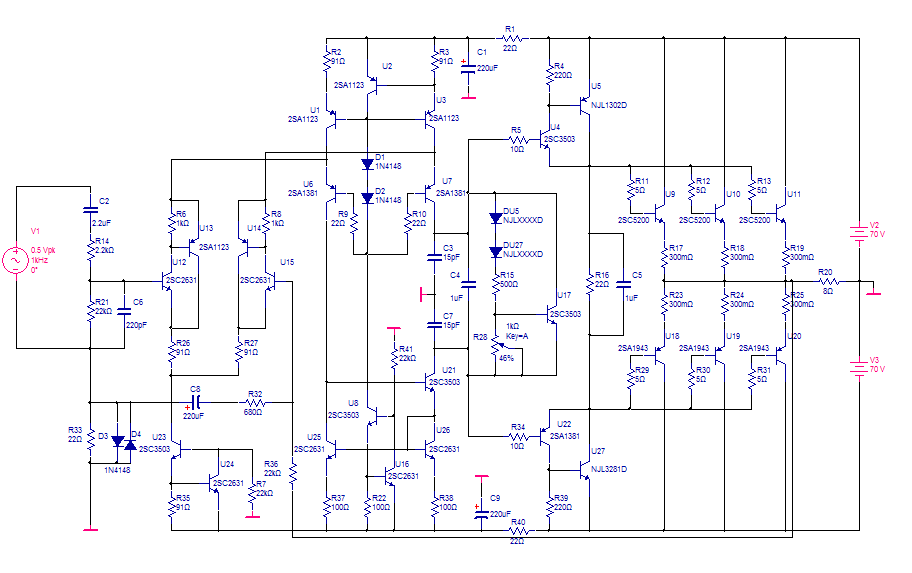

I'm a little confused about what you are referring to. U2 is bias for the VAS CCS (U1 & U3).
I have shifted things around to make things more clear:
Besides, I have a 50-0-50 I need to use. 🙂
Best so far !!
Hi , john. I need some "havoc" in my life. 😀
I simulated it. Very , very good.
The only changes I made was a triple for the OPS , just
a led for U2 (your active source on negative rail does all the work)
H5/7 were -140db .. wow ! 😎 and Psrr was -100db.
I was going to do the VSOP (another folded design) but yours
beat it. (I also have seen it in completed form 🙂 )
OS
is R33 needed? The diodes pass the fault current and the NFB ties the inputs to the output.
What happens if you reduce R4 & R39, to increase the pre-driver current to somewhere between 5mA and 7mA? 82r to 130r?
Are the integrated diodes monitoring the correct junction temperatures?
For the CFP shown the bias voltage is across the pre-driver and output device base emitter junctions. Surely the temp comp should be applied to either the pre-driver and/or to the output devices.
The 1943/5200 will not like the +-70Vdc supplies. They will run hot due to ~200mA of output bias current (Pq=28W) and have a very low SOAR @ this combination of voltage and temperature.
Yes, I like the idea of using the high quiescent voltage to give clip free music dynamics, but I don't like the resulting schematic you've posted to achieve those dynamics. I see the solution as either a much lower supply voltage or a much more robust output device.

AndrewT said:Hi,
Hi Andrew,
First off, as I mentioned above, this is still a work in progress. Everything is subject to change. I'm in no rush.
R33 (on the latest posted schematic) isolates common ground from signal ground.
According to the simulator higher order harmonics increase. Whether this is accurate or not I can't say. What I can say is that the amp works fine with this current through as shown on the Abomination.
The master and slave of the CFP drivers, along with the Vbe multiplier and the entire output stage will be on the main heatsink. I see no problems.
Like I said - a work in progress. The choice of outputs is not firm yet, but I don't see a problem with the 5200/1943 here. They are 230V devices.
I'm not sure where you got the 200mA idle current figure from - the correct idle current for this amp should be 80-90mA per device.
like you said "a work in progress".
Does 200mA come to around 67mA/device?
The 1943 are down to 1A @ 70Vce.
De-rate for Tc=55degC and that 1A falls to 760mA.
The design uses up ~85mA just for quiescent bias.
That does not leave much for driving 16ohm speakers.
8ohm is going to be a severe load for 1943/5200.
When cold the 1943/5200 are 150W and 230Vce0 devices that are now 53W and 70Vce devices in this design.

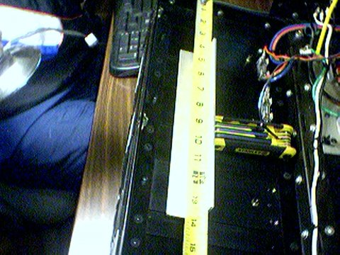

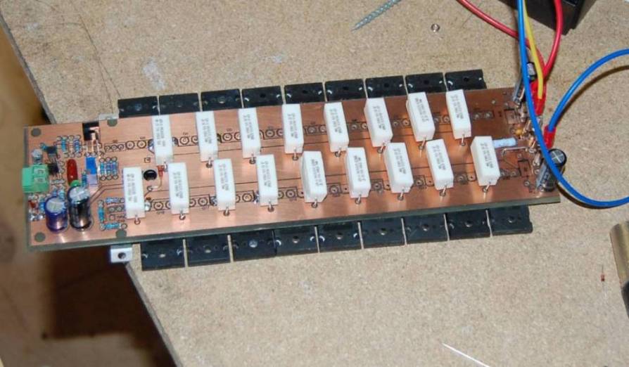

MJL - One thing I want to do is work with a different layout for this one. Something like this:
I like that style , too .. but with my HS (attached) ,I would only be able to "hit" 2 of my heatsinks with a 9" board.I want to at least
get 3 for the big amps (there are 4 total per side) and 1 for the
lm3886's.
The only option I seem to have is the 1.5" "L" x 18". I did put
U2 back in as with the led ,.1v offset was observed (you got it
right the first time, U2/1/3 act as a balanced current source/cm).
Do you have abominations still playing around your house ?
How do they sound ?
OS
lm3886's.
How do they sound ?
OS
I have one complete Abomination that I listened to shortly after it was built. My problem here is that my main speakers are active, so I had to use an older one that has a substitute tweeter - not the one the crossover was designed for. Sound quality is very high in my estimation.
The layout would be best used directly on a large heatsink. I have some ideas for either making it extremely narrow or excessively wide. I need to finalize the circuit first though...

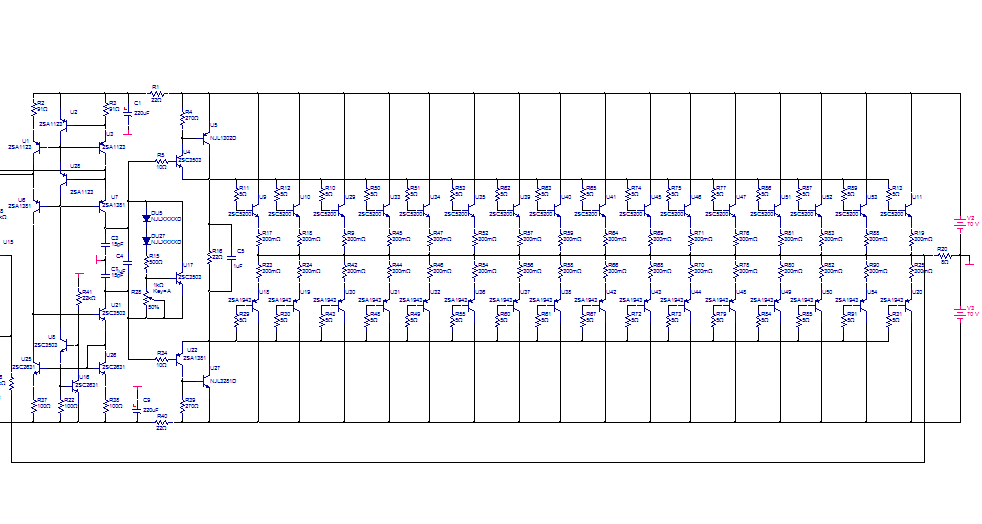

It's not a matter of using the transformer - it's how I see this amp. Zero clipping potential, that's what the high voltage gives. If I didn't have a 50-0-50, I'd be looking for one.
BTW, I have a new AndrewT version brewed up. SOA aplenty!!

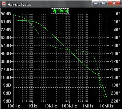

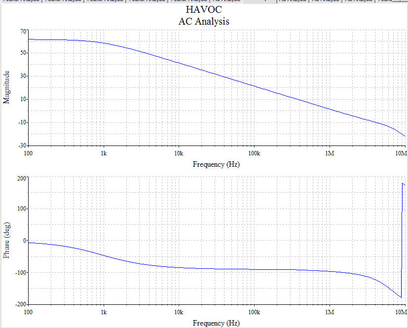

That's funny.. 🙂 One thing.. have you checked the OLG ofBTW, I have a new AndrewT version brewed up. SOA a plenty!!
this thing ? It is 90Db + with unity at 8mhz !! (too much).
that is with U2 which acts like a typical self CM doubling or tripling
the loop gain !
What is blowing my mind is that it still IS working at this level
with little ringing or oscillation.
OS
ostripper said:
That's funny.. 🙂
16 pair!

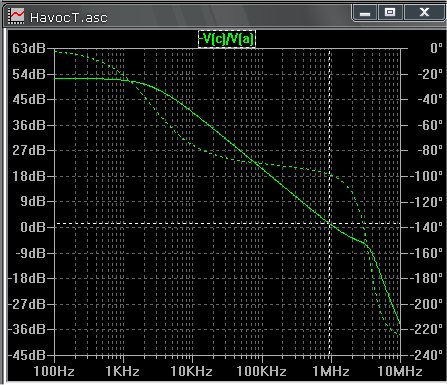

I'm not sure how you got the OLG plot, mine (done last night) looks like this:
I'm not sure , either. I am using fairchild KSC1845 models for inputs (too much gain?)
My slope is the same as yours (89 degree phase/flat to UG)
but the UG is 8mhz and total gain is 88db with your 91r degen. 😕
OS
OS
My pick for small signal are the 2SC2631 and the 2SA1123 both of these the "R" version with Hfe 130-220.
I don't have models for these but used the 2SA970/2240 as a good substitute. Both of these have medium gain.
