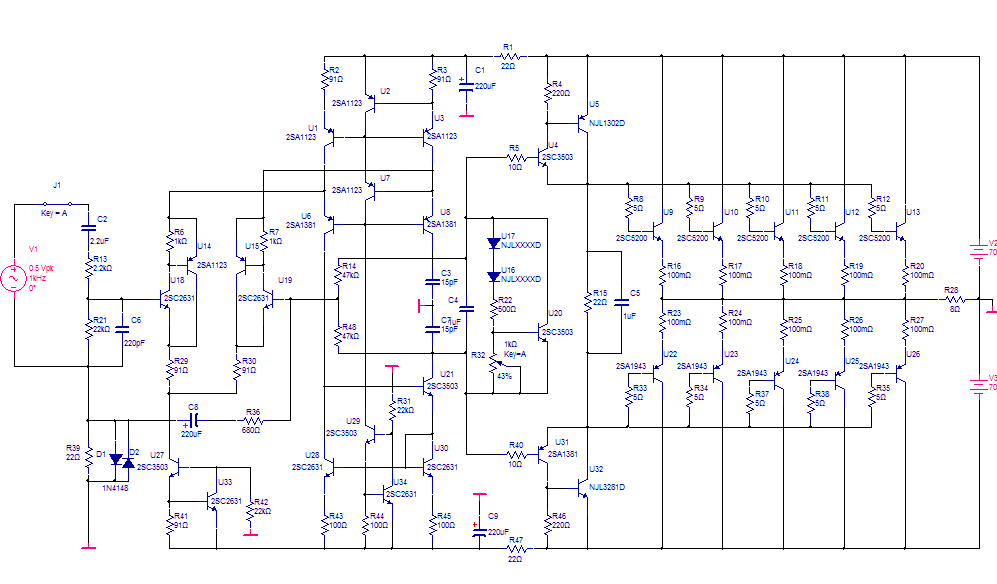

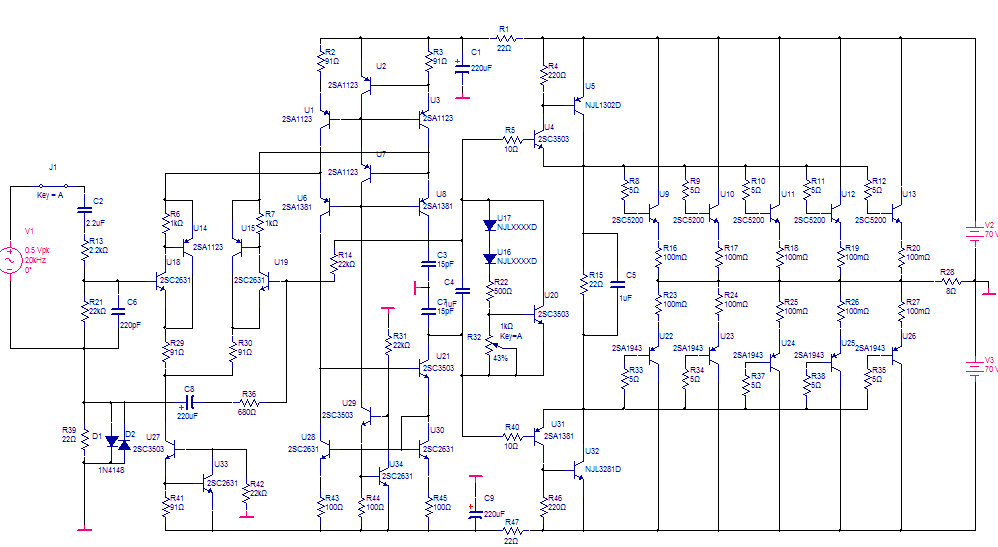

You are on to something... quickly done - feedback shifted to VAS, 3 output pairs. 0.1 ohm re's:

post 251 looks nice, but it's going to need an almighty heatsink to get rid of that ~150W of output dissipation.
Yes, it's true, lots of heat to get rid of. Yet, there are degrees - how much distortion is acceptable? Dropping the idle current down to ~80mA/device has the total dissipation at 50 watts and the distortion at 1k is still less than .01%. Choices...
This raises the question: is it worth this to eliminate global feedback? Will the benefits be heard or are they just assumed? Is global feedback that bad?
Surely, for quiet listening the fact that the amp will be effectively operating class A should be an improvement.

Triple EF version. Performance is no better (in simulation) than the CFP one, but I had good results with it on my big sub amp - stabilized it after I tried the CFP there.
I have reduced the OS to 4 pairs. Distortion looks good at reasonable idle current.

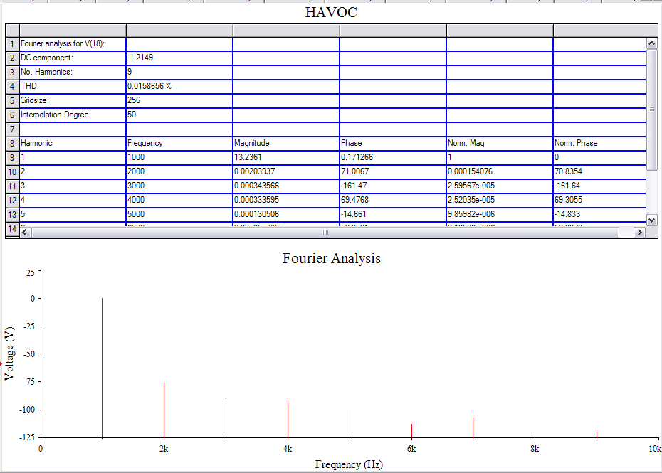

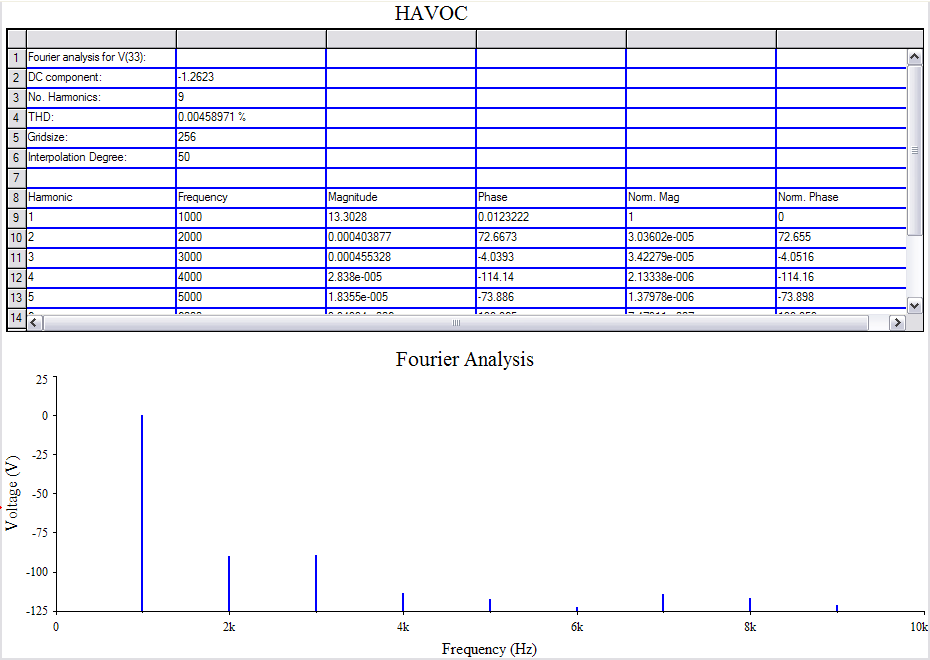

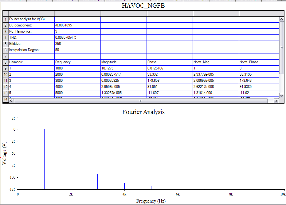

I have done some more playing with the HAVOC circuit and I've settled on this for now:
Sticking with the no global feedback (for the heck of it :) ).
I still need to do some fine tuning before I prototype. I've changed the outputs to the MJL4281A/4302A. These are in the schematic for simulation but I will probably use the MJW21193/94.
Here's how the 1k Fourier looks at ~90mA/output. I could live with this...:)

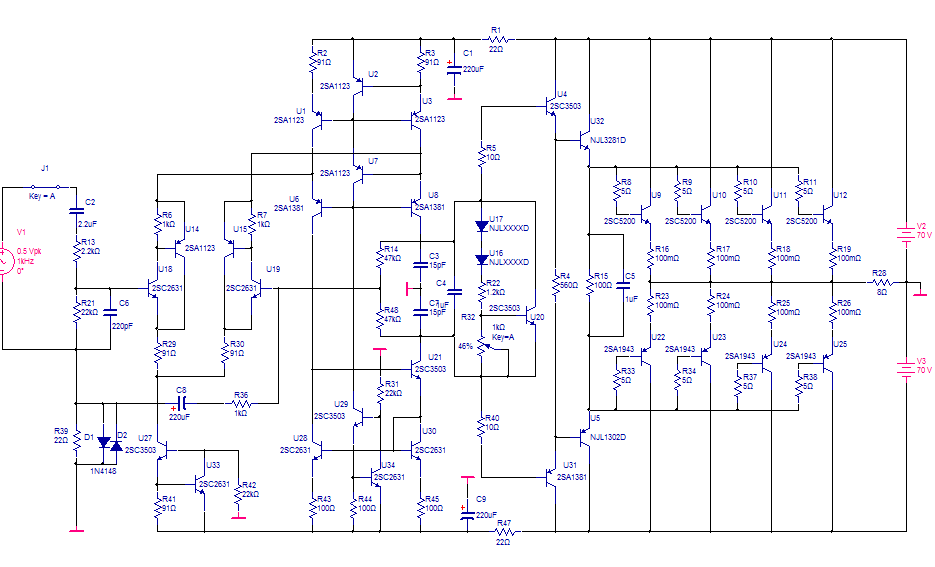

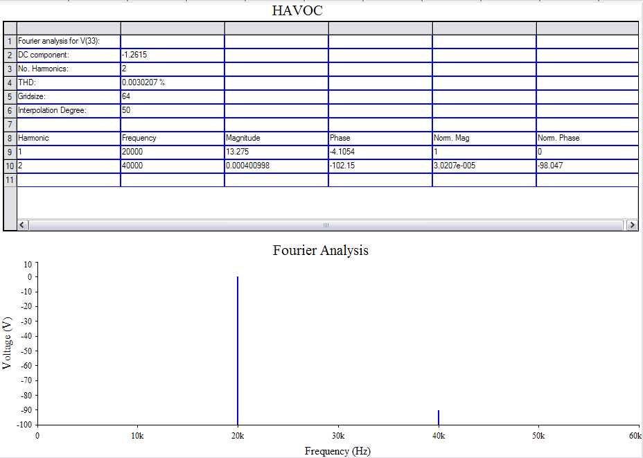

roender said:
You need at least 150mA/output pears, optimally 180mA ;)
Hi roender,
I have 90mA/device so 180mA per pair...or did you mean per device?
I'm getting good distortion figures in simulation with this idle current. I will need to build it and test it to see how it is in real life. I have the feeling it's going to be good.
I lowered the current through the CFP drivers and I also increased the current through the front end (and lowered the VAS current to ~2.5mA) and this shifted the harmonic content to higher H2 and lower H3.
Made a change to the CFP input - replaced the 2SA1123s with higher power 2SA1381. Too much dissipation for the TO-92.
