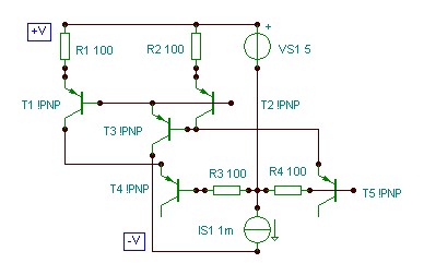

AndrewT said:no emitter load on the U1&5 drivers.
HNY Andrew,
This darlington configuration will not work? I wanted to play with an R between, E to B.

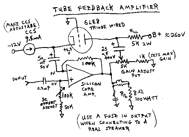

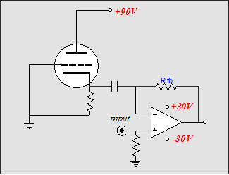

how about changing fb loop with some twist of 6GM8 (low voltage ) triode...
in this way the amp could be switched from pp to se.....2nd harmonic dominant..
since 6gm8 is low voltage, you don't think about HV.. you may have to shield 6GM8 on actual pcb..

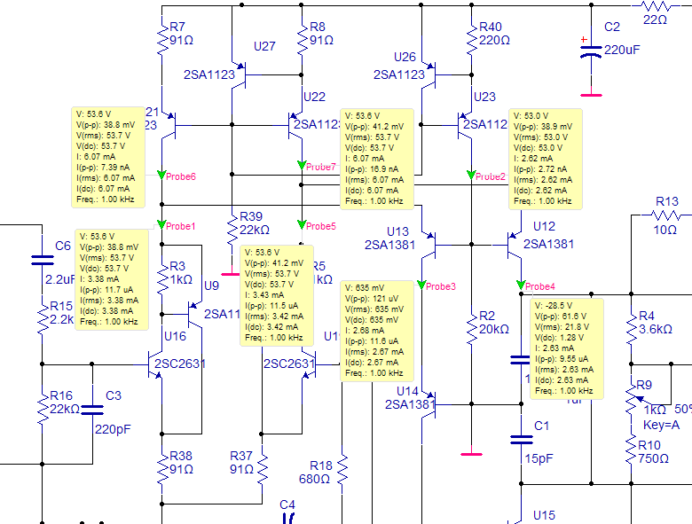

Fixed up the schematic:

KLe said:Nice John 😀 ... as you would say, keep it simple![]()
Hi KL,
Me being a minimalist again 😀
This only uses two more transistors (total=28).
The question is, is it a better amp? I have massively improved PSR, but below a certain value, this won't be a discernible improvement (IMO).
I have about the same 1k THD. Spectrum of the harmonics I don't trust, but both amps simmed show 2nd stronger than 3rd, with not much up higher. I haven't tested 20k yet.

Lumba Ogir said:MJL21193,
correct application-without explanation.
It's not clear to me how this is an improvement. Your change lowers the current through U21, U22. Too low and reducing R7, R8 will not be enough. I end up with insufficient current through the VAS.
