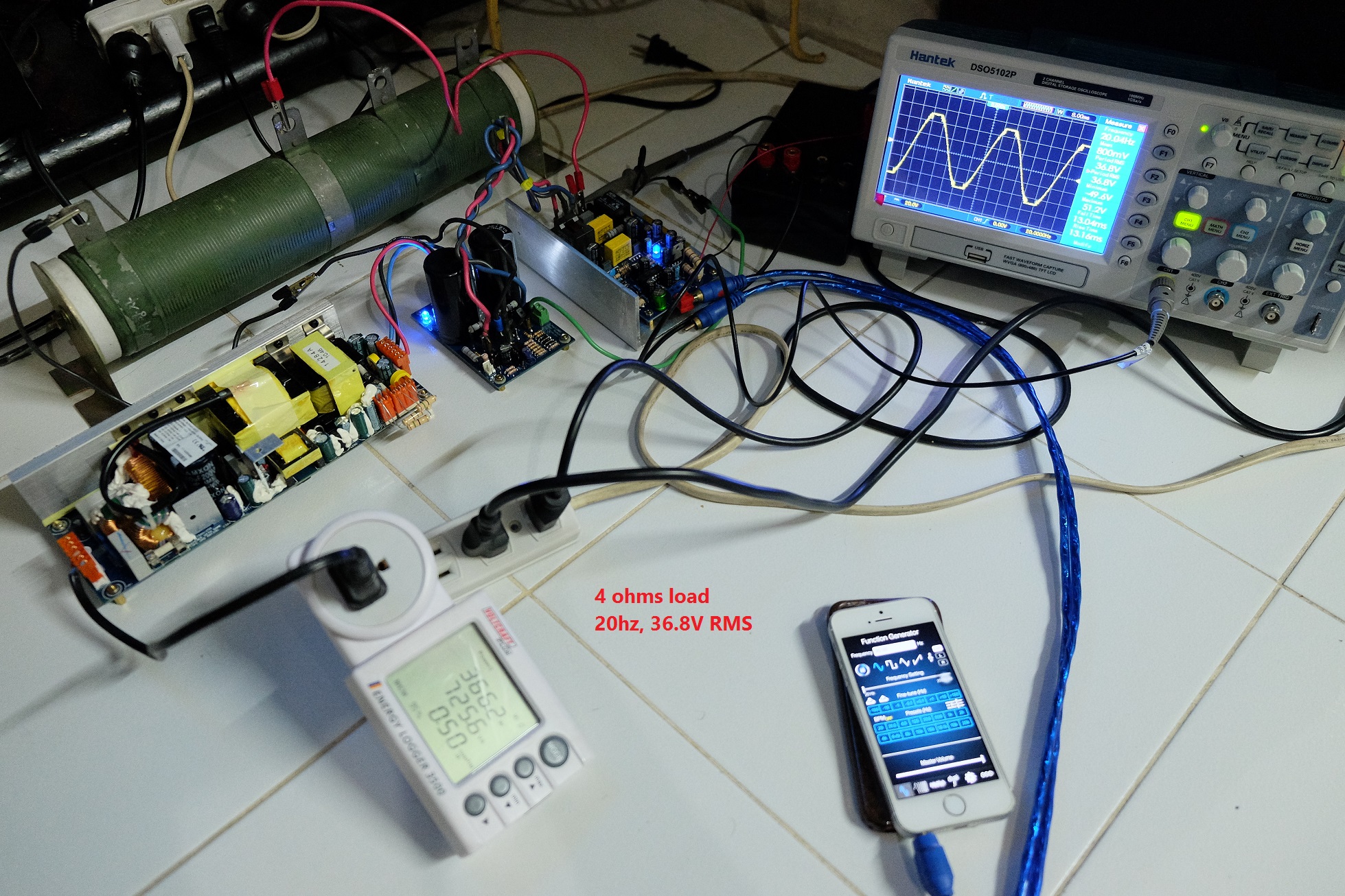

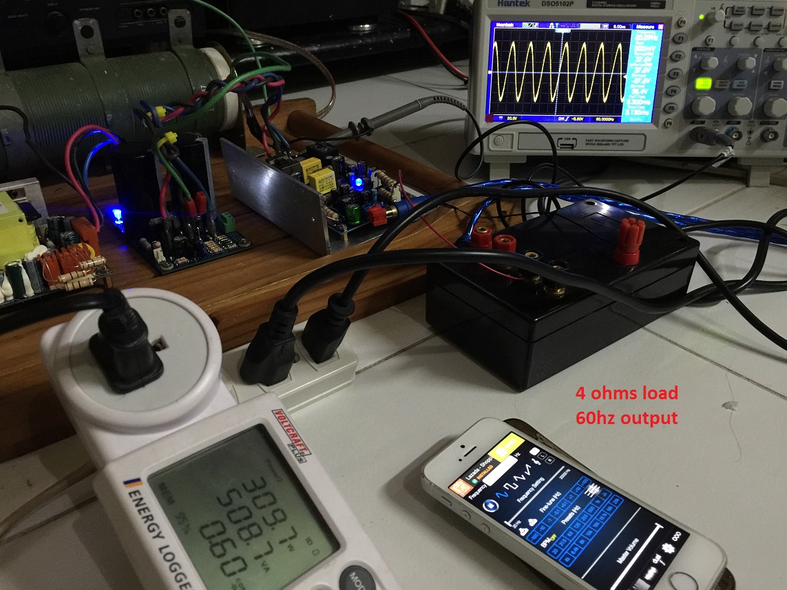

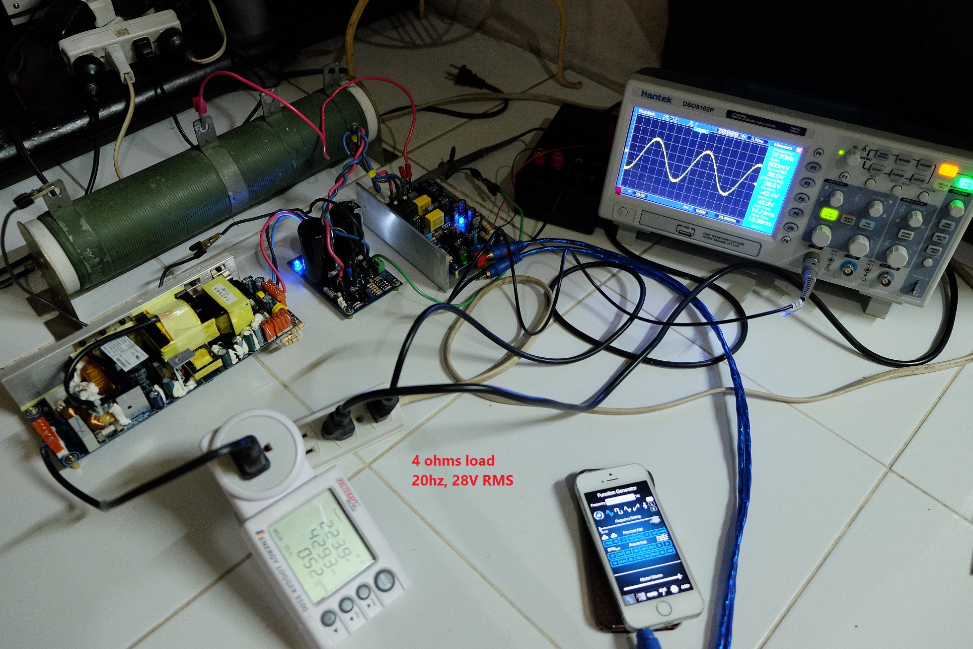

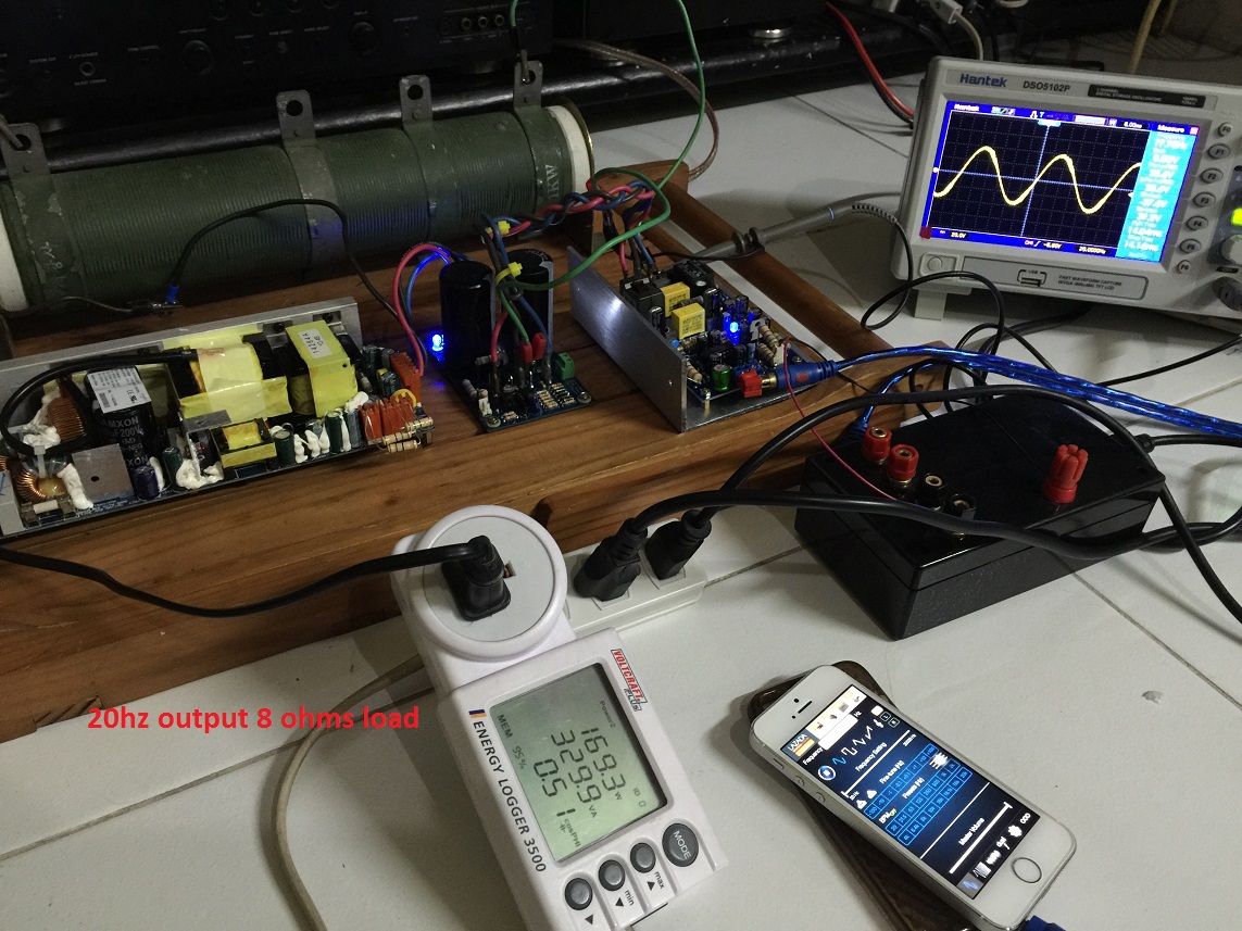

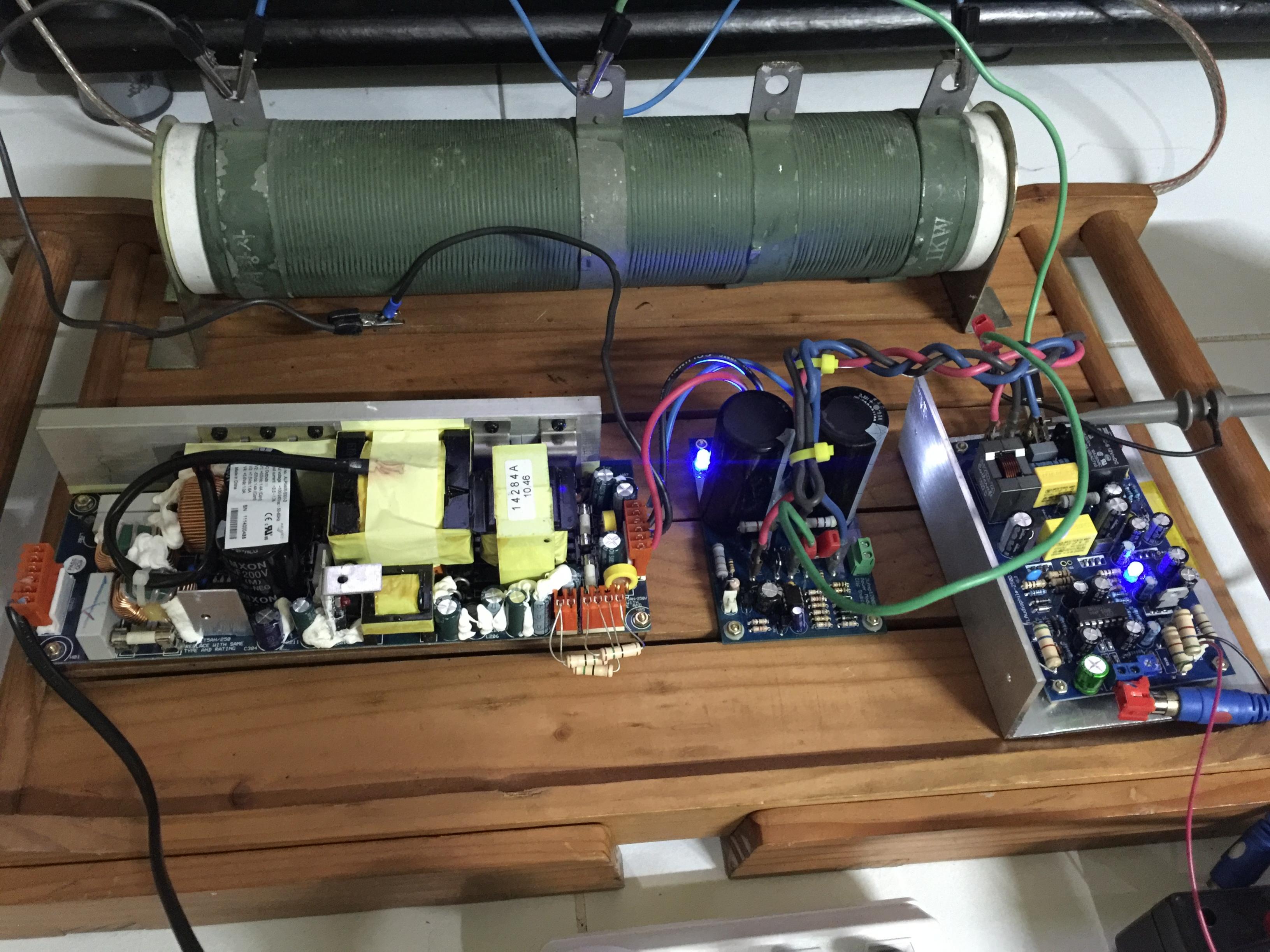

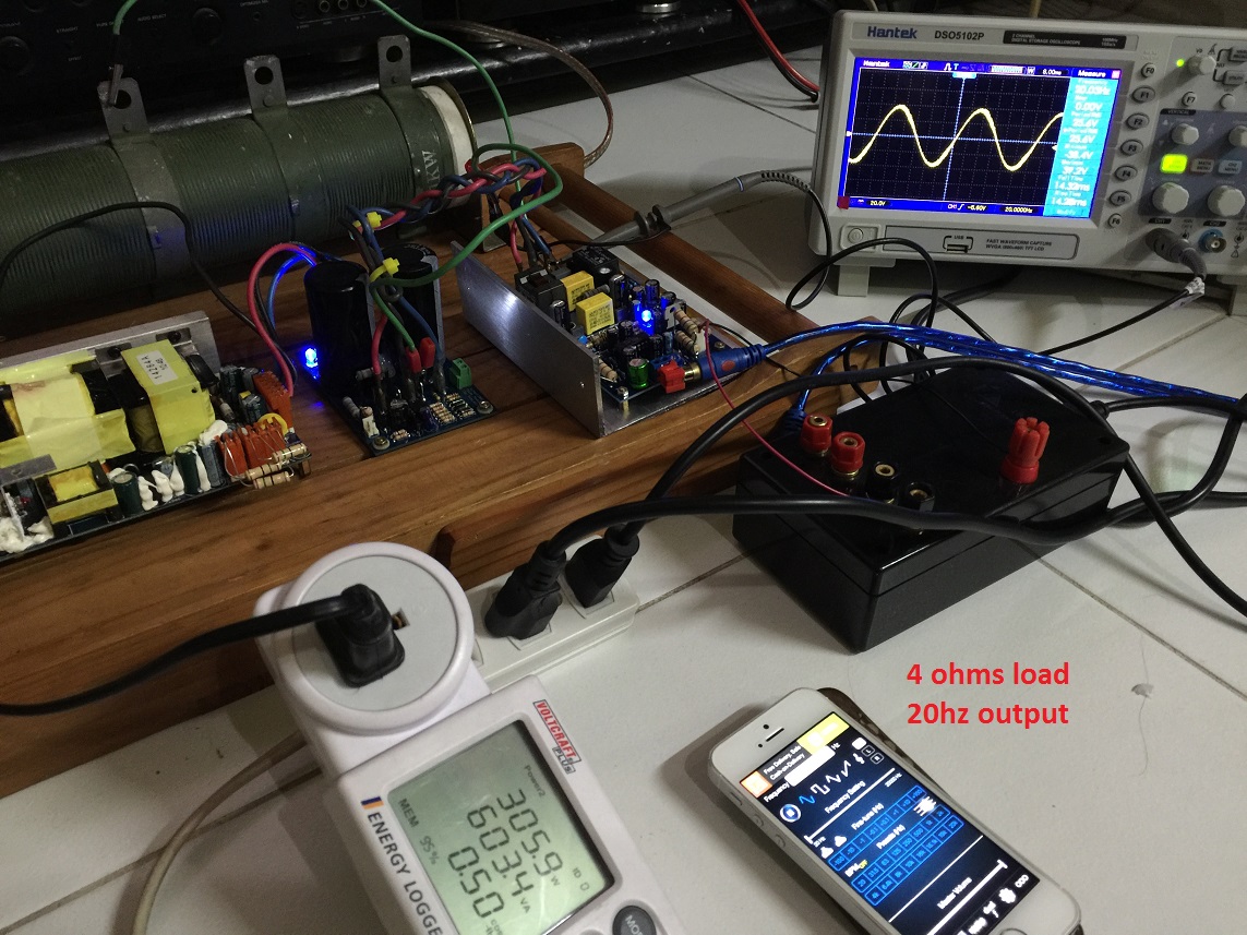

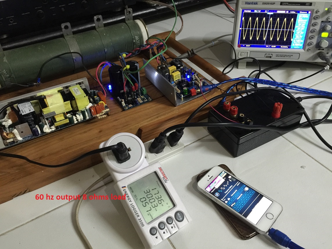

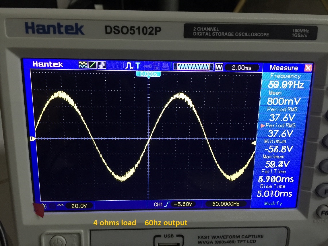

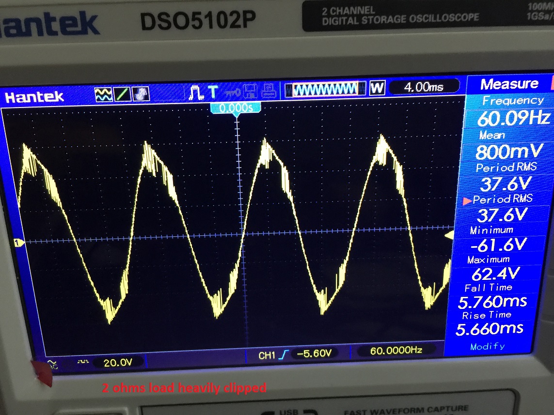

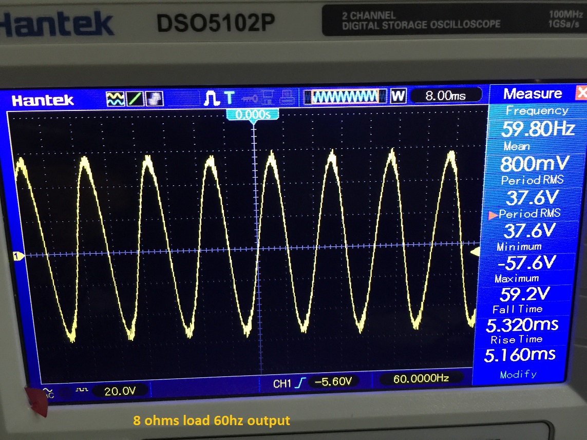

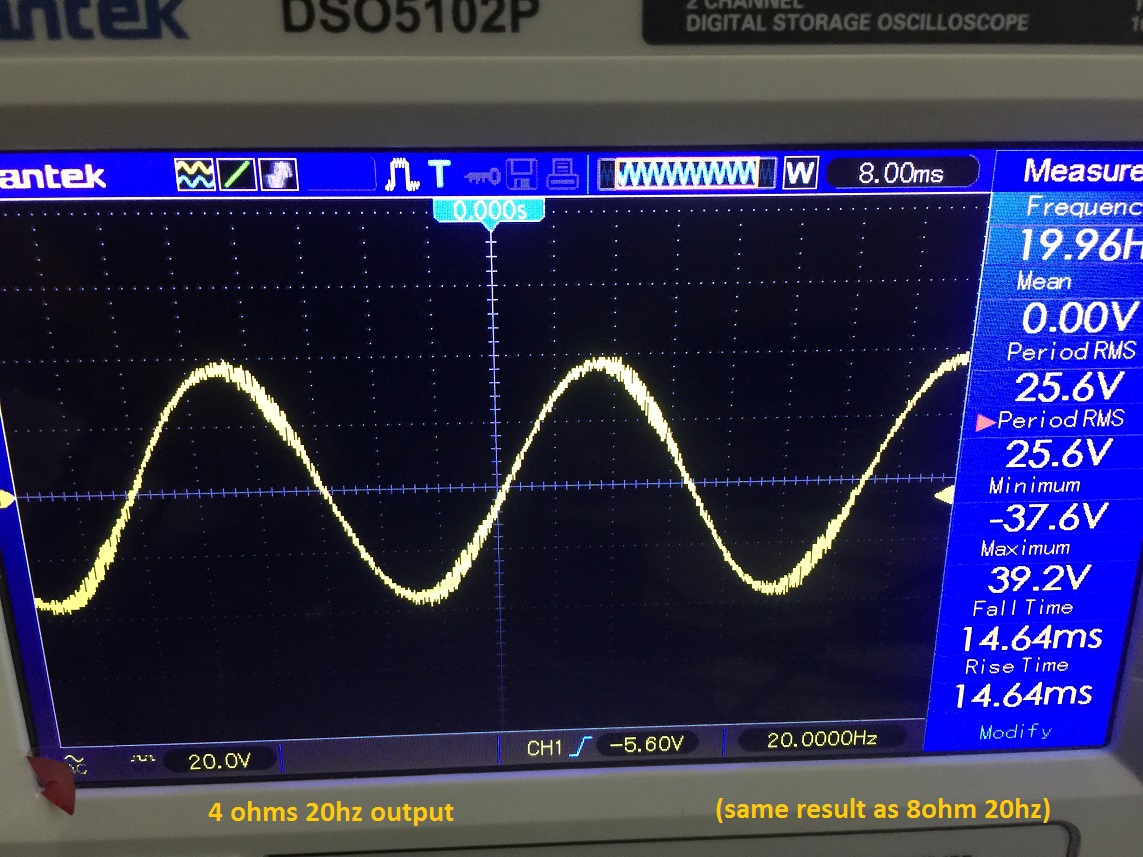

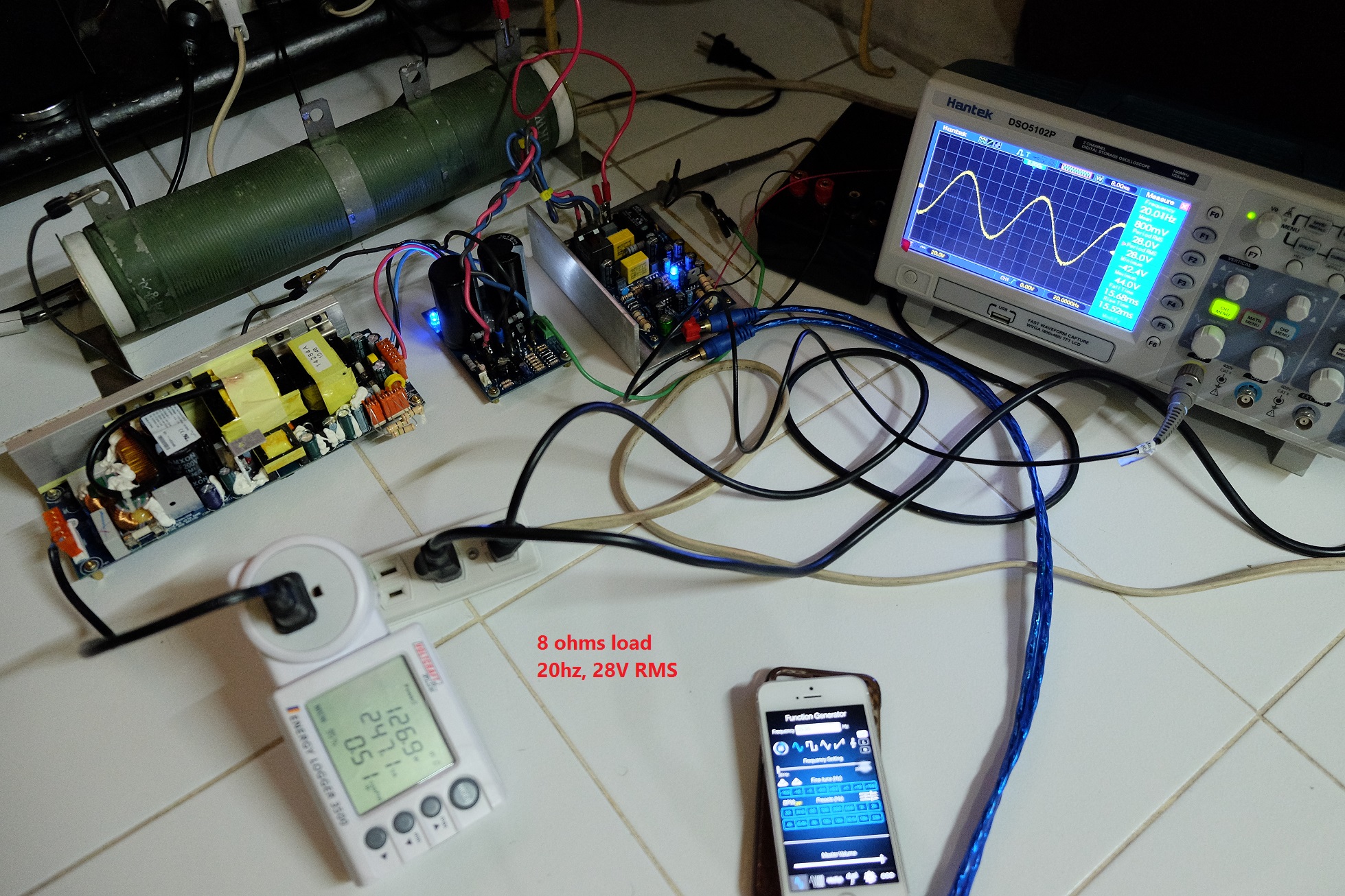

As I have suspected, running at 20hz makes the rail voltage go as high as +/-58V DC before the protection kicks in.
So I've put 10000uf per rail and the amp was able to output 20hz.
Weird thing is that the waveforms are not clean at high power when the amp outputs 20hz. At 8 ohms and 4 ohms, cleanest output that I can get with 20hz was only 25.6V RMS. At 2 ohms load, only 20V RMS (see attached pics). With a linear supply, I can get cleaner waveforms with 20hz at higher power output.
Good thing about this amp is the regulation, unlike linear supplies, rail voltage does not sag.
Attached pics for data.

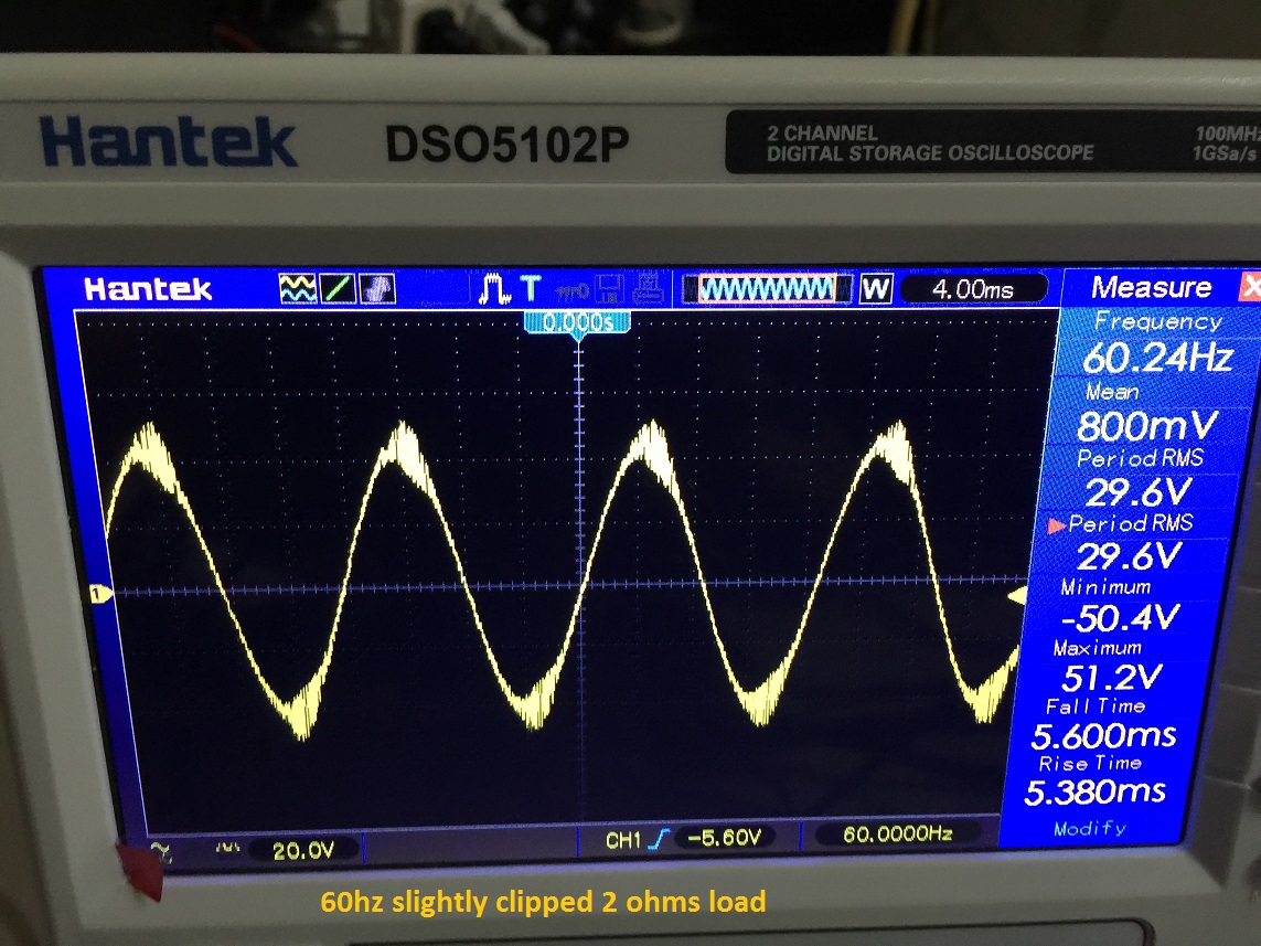

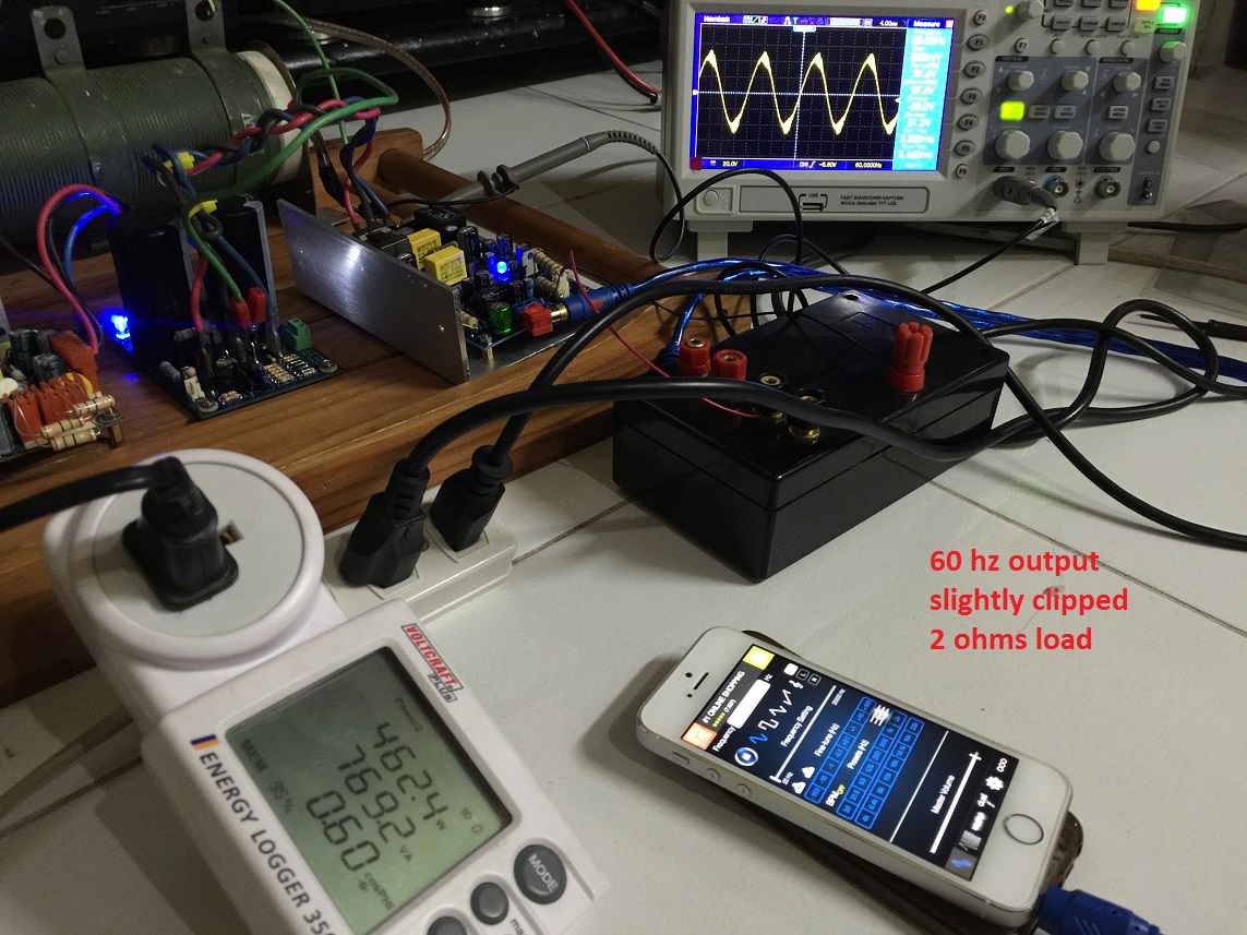

Total system idle power consumption is around 20W (JLA-250 module idle is around 5W)

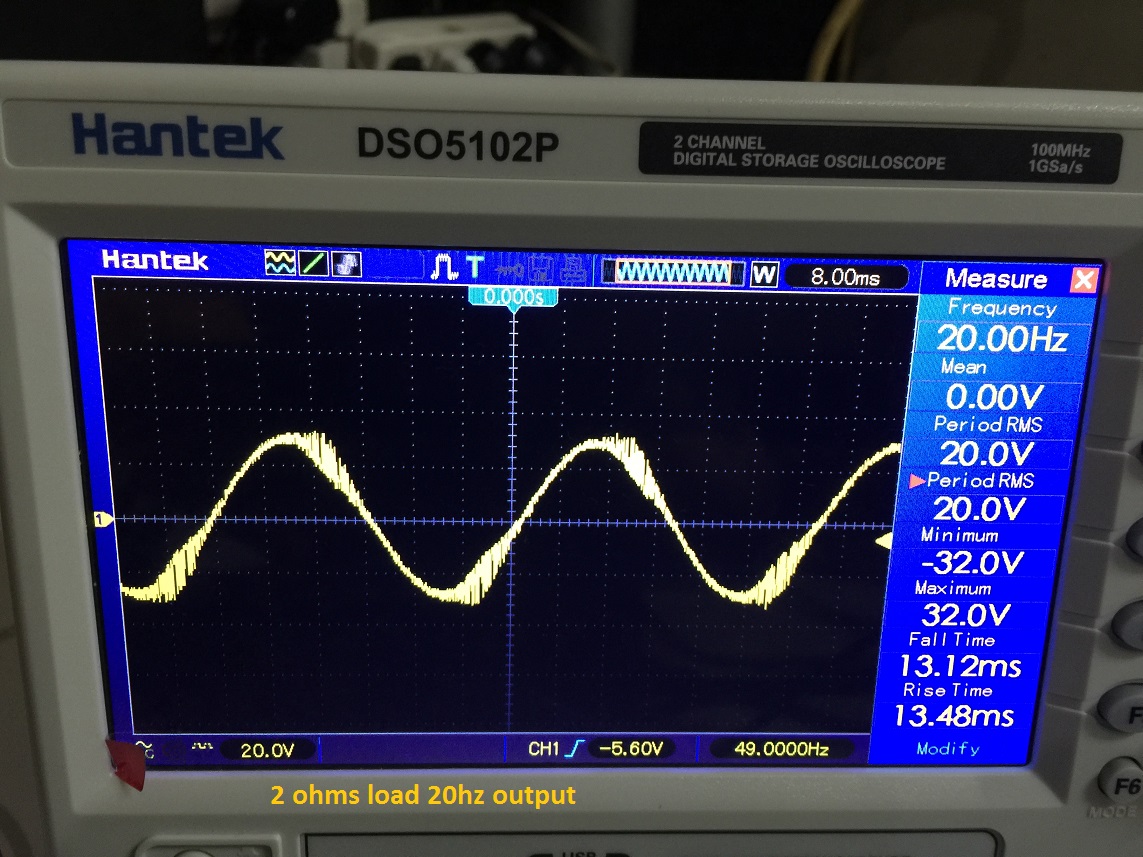

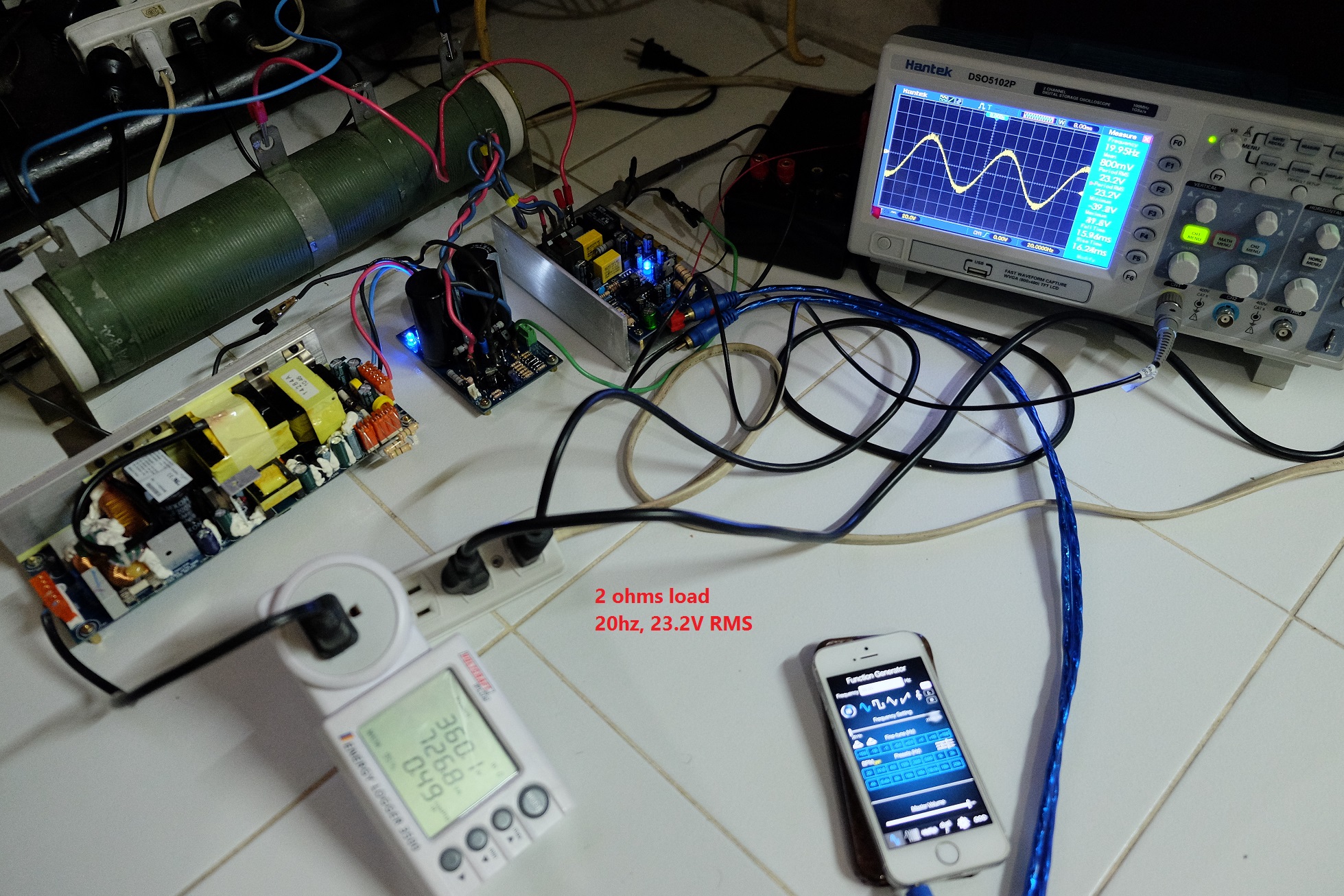

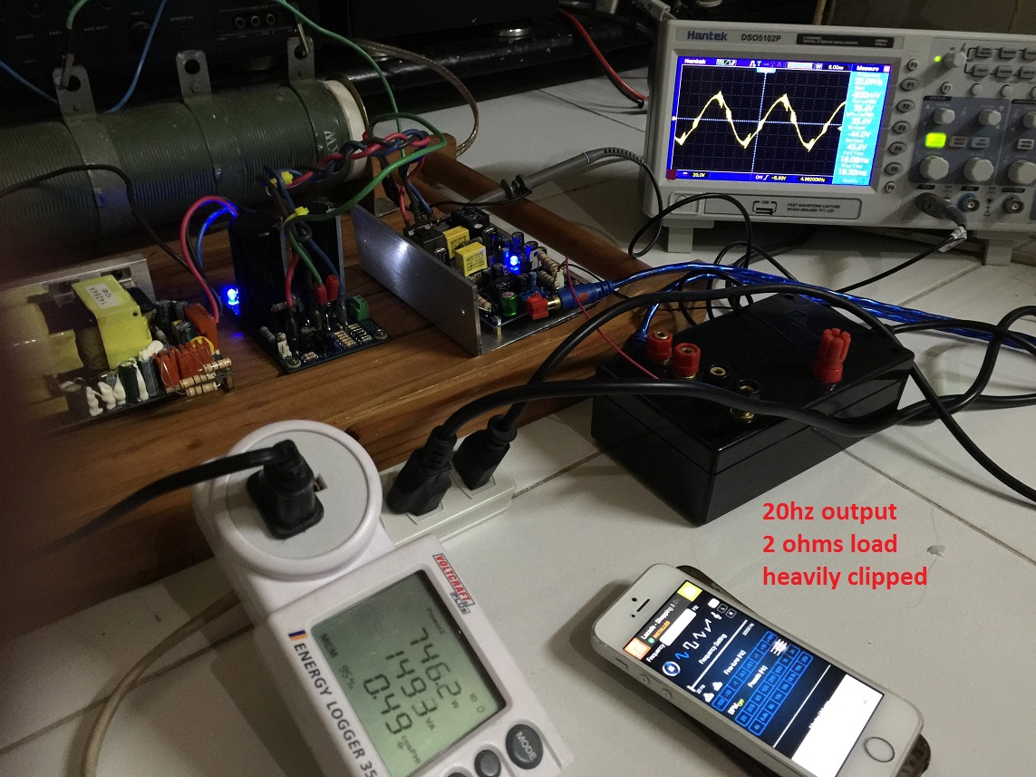

More data at 2 ohms load. See attached pics
Overcurrent protect kicks in when energy logger shows 800W.
I used my module JLA-250D V1.2 +/-85V Max voltage, uses IRFB5620, VER2923-223 inductor.
@jlester:

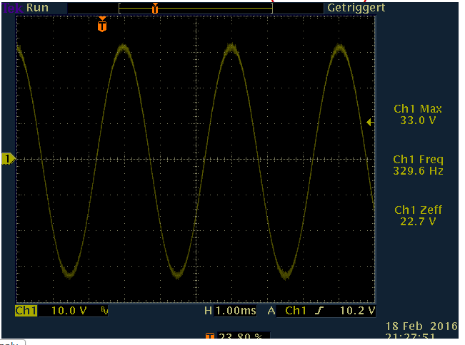

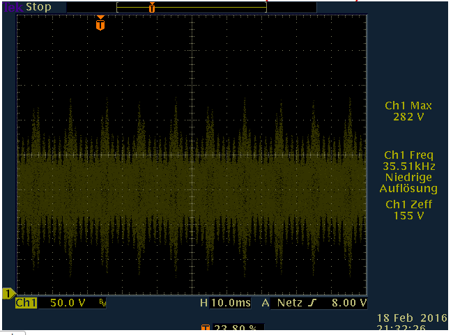

What in your opinion is the source of the higher frequency noise/junk superimposed on top of the waveform? Do you think that this is the power supply going into distress, or does it have something to do with the amplifier? How about the reaction of the power supply to the large capacitor on the output? I thought that was not a good idea in general for an SMPS...
Could you try changing this to a low pass filter by adding a small value power resistor, e.g. 0.22R, 25W+ in between the PS and your cap bank? This would give a first order low pass with corner frequency at 72Hz that might remove the junk if it is coming from the PS. Note, when drawing current the power dissipated in the 0.22R series resistor would be:
power (VA) / current / resistor power dissipation
100VA / 1.88A / 0.8W
500VA / 9.4A / 19.6W
1000VA / 18.9A / 78W!
Not sure how you are getting the PS to output 1000VA... Apologies if my numbers are off, but you get the idea.

I captured those waveforms at the onset of clipping, with 3V to 4V RMS lower, the waveform is clean. Though the residual of class-d is cleaner when I am using a linear supply. When I use this supply, there is a slight blip on the 480mV residual.
With the addition of 10000uf caps, at power on, the SMPS emits hiiissssst sound for about half of a second, then the LEDs of cap supply module is slowly glowing. In comparison, when I am using a transformer + rectifier, the LEDs will instantly glow.
OK, I see. I somehow got the idea that the waveforms you showed were indicative of all output powers. Thanks for clarifying that this behavior is only found at or near clipping.
I'm sure the SMPS is not happy turning on to a near dead short (the discharged cap bank)!
You pretty much hitting the smps inductors current vs. inductance. Would guess it's saturating at charging the 10mF cap + suppliing your amp. This does alot of stress to your secondary rectifiers, i wouldn't do that. The 10mF wouldn't help on 20Hz either to keep the rails stiff, it just dampens out subharmonic oscillation of your supply - so you'd better change the compensation at the control loop.
Have you scoped the voltage at the rectifiers and fets with/out the big cap?

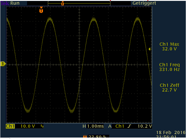

This is from my LLC supply, connected to an amp at 235Wrms combined into 5R and 6000uF bulk capacitance at 330Hz. This plot shows the voltage at the resonance-capacitor. The high current peaks are due to the high secondary capacitance.
This is same with only 100uF Polymer at same levels:
Same performance, less stress for the switches + rectifiers.
Output performance with 6000uF:
And 100uF:
Any different? 😀
So if you want to increase capacitance, do it on primary side for Q=C*U reasons.
(Measurements and plots taken by @voltwide )

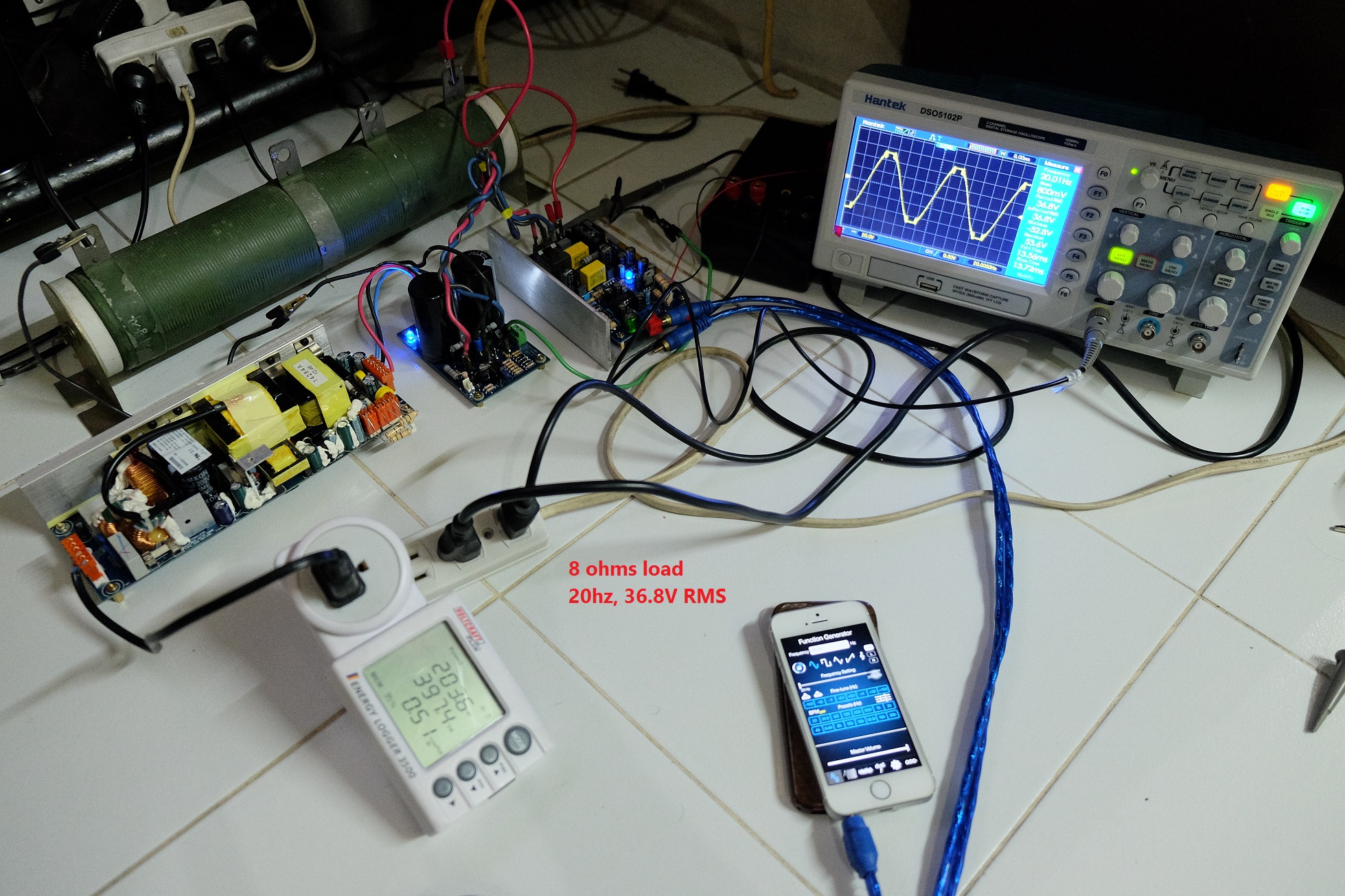

The problem with this abletec supply is that it's not capable of sinking current from the half bridge class-d.
When I tried to output 20hz from the amp, without the secondary capacitors to absorb the current, the supply voltage was being pumped up which is why the abletec goes to overvoltage protection.
Bus pumping is being aggravated when the class-d amp has higher current and lower frequency output. In case with this SMPS + jlamp combo, bus pumping can be observed at 120hz and below.
I rewired the setup such that the ground of resistive dummy load is on the capacitor bank, as pointed out by troystg. Also, my probes were not properly compensated yesterday hence the location of clipping in the previous shots is not on the peaks of the sine wave. Waveforms at 20hz went normal much like when I measured it 60hz or 1khz.
I think this SMPS is only good for 4 ohms 250w subwoofer. Personally, I'll use this on my GB150D module.
2 ohms near clipping
8 ohms hard clipping
4 ohms hard clipping

PS: I managed to destroy the fuse on the negative rail in my 2 ohms, 20hz full clipping test. Good thing the amp and smps both survived.

I see this a little differently.
At 8 ohms clipping can clearly be seen on the scope (picture labeled with 8 Ohms, 36.8Vrms). At this RMS output voltage the peak voltage is 1.41 times higher, or over 51V (assuming sine wave with non-clipped peaks). But the SMPS rails are only 53V and your output devices have a few volts drop in them, so you are running out of VOLTAGE in this case, and not POWER (or current) from the SMPS. The V^2R power into 8R at 36.8Vrms is only 170W - this means you could connect several more amps like this to the SMPS before you use up the available current capability. I'm thinking of general full range audio, not low frequency specific use.
Likewise, for the pic showing 4R load at clipping at the same output voltage the amp has reached its maximum output for these rail voltages. V^2R is now about 340W. I don't see why you could not connect additional amplifier modules since (at least on paper) the SMPS can supply 450W and more for brief peaks.
As an example that I have mentioned before, I have three 2092 based class-D amps (one IRAUDAMP7 and one L15D) running off of a single AbleTec PS and I have experienced zero problems - there are two 8R drivers and one 4R driver (4R is the tweeter) reproducing music signals. Sine wave testing is really not all that indicative of performance on music signals except for subwoofer duty only. One doesn't need to do sine wave testing to know how many Watts a single amplifier can produce when powered by this PS before you run out of rail voltage... you have simply measured this behavior.
On the other hand, I strongly agree that bus pumping is a problem with the SMPS for high power (>250W) low frequency signals, but only with Class-D amps. Class AB amps, like your GB150D design, do not pump energy back to the PS. Bus pumping is only encountered with half-bridge class-D amps.
