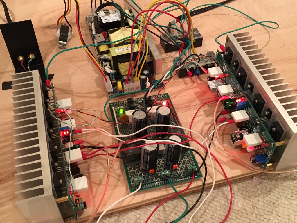

Here's a pic:
Imgur: The most awesome images on the Internet
Ignore the labels written on the bottom of the base as I had it labelled wrong. Use the diagram from the previous post.
Here's a pic:

Using my custom CRCLC PSU filter after the Abletec, I get 1mV ripple now. That's 20ppm ripple (51v rails). 😀
Sweet - the speaker is as dead silent as I have ever heard it without a source playing.
This is the CRCLC design shown above:
In the crclc circuit what is r5-8 for?
Sent from my iPad using Tapatalk so there will be spelling mistakes...
When the AC mains power is removed you want the PS caps to slowly lose charge over 30 seconds or more. Using resistors of several kilo Ohms and a couple Watts (e.g. 5W) rating is often included in the circuit used for this purpose. They tend to get warm...In the crclc circuit what is r5-8 for?
You can make out two 5W sandcast wirewound resistors on each side of the circuit board in the picture.
R5-R6 are bleed off resistors and are 2.2k 2w these happen to be metal film resistors
R7-R8 are snubber resistors used with caps and are also 2w these happen to be metal film
R1-R2 are the 5w sandcast resistors (actually two 6.8R in parallel) and are 10w total - and they do get hot as all the current for the amp flows through them. They work with the big caps as part of the CRC filter.
