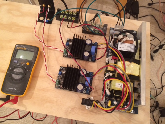

I finally had a chance to mount my IRS2092 (200w) and the Abletec onto a proper amp setup. Listening to it now on my XL-S speakers. Sound is excellent - very clean and bass authority is very good.
The pre-made wiring harness for the Abletec makes this very much more convenient.

I'm powering a L15D-Pro, IRS2092 amp which is driving a single 12" sub. When I play a 20Hz tone, the power supply shuts down before the sub even breaks a sweat. If I had to guess, I'd say the sub is seeing maybe 60W, which is fine for every day listening, however I bought 4 of these supplies thinking that they would be comparable to my current linier PS, but in a smaller / lighter package. I usually power the same amp and sub with a 450W, linear power supply which drives my subwoofer to ridiculous levels.

I decided to measure the output myself. Hopefully someone can correct me if my testing method was flawed or skewed in any way. I'm learning as I go 🙂
I don't have much for test equipment, I just wanted to see what voltage I could get into a resistive load... I built a 2.4Ω dummy load with 5 paralled 12Ω / 100W resistors mounted to a fair sized heatsink (that's all the resistors I had on hand but I figure that should be more than sufficient for this purpose). The test amp was my modified JLAmp (It's an IRS2092 based class D amplifier that is 2Ω stable and can put out well over 400W into a 2.4Ω load.
I tested with both 60Hz and 120Hz tones and slowly increased the gain (measuring output voltage) until the power supply cut out... With a 120Hz tone the power supply cut out @ about 22v (That's about 200W into this load) With 60Hz tone cut out at only 12v (about 60W)... This test was done with 200Hz resistors loading the 5v & 7.5v outputs. With the same setup, but using my linear power supply (+/-42v) I ran out of gain before before I was able to max out my power supply (29v into 2.4Ω and 350W)

Let's see... using V=IR we have:
R=2.4 Ohms
V=22 Vrms
what's the current?
Rearranging, Irms=Vrms/R (resistive load so no phase angle to worry about!)
Irms=22/2.4=9.16A (rms)
Ipk=1.41*Irms
Ipk=12.8A peak
Perhaps the PS is not so happy when there is this much current demand?
Looking at the spec sheet, this PS is rated for 1.38A continuous, 4.13A peak (up to 5 min) and 16.5A for 10milliseconds (so forget about that one, because your frequencies are low). I think that this is per rail, so double these number. This would put the peak rms current at about 8.4Arms. Your test is drawing another Ampere or so above this.
I think that you are exceeding the current draw that the supplies are capable of, causing them to shut down. Not sure exactly why this is happening at a much lower voltage with a 60Hz input.
I would try to repeat your test with a higher impedance load so that current demand is much lower, e.g. 8R. Then you should be able to reach the full rated power (or that is my hunch). If you are driving a 2-ohm nominal driver with this PS, then this is NOT a good choice because much more current is needed. Is that why you chose the 2.4 ohm test load by any chance? Also, keep in mind that a real driver represents a reactive load and this can jack up the current demand at some frequencies.

Good catch with Ohms Law there CharlieLaub. I use them with 8ohm speakers and have not had any shutdown issues.
Indeed. The numbers add up and this makes perfect sense... I just tested @ 4Ω and I was able to push 28.5v @ 120Hz / 30v @ 240Hz but again the low frequency capabilities was much lower, giving up @ only 18v. Longer sine-waves, I suppose?.
This really clears things up and I suppose it should have been obvious that I'd run into current issues with such a low impedance... 8Ω, stereo seems to be the best matchup this power supply.
