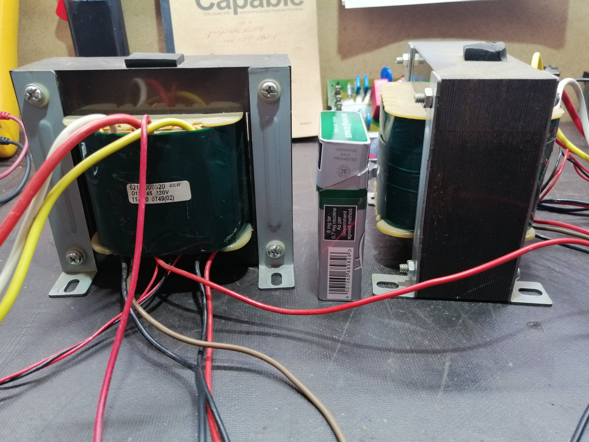

Hey Jannas , I remember Rudi preferring smaller PSU caps in Class AB designs when transformers are over-provisioned . I believe he said it made the amp fasterI will be building another one, this time for myself, will be using these two 500VA trannies, going to be a heavy nipper !
