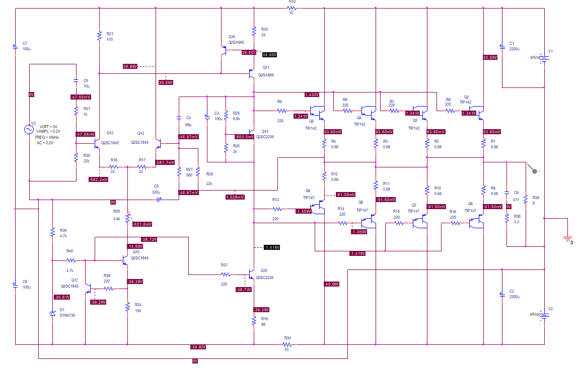

To all punters out there who have actually built this amplifier, what sort of output offset are you seeing? I ran a sim on the current circuit I showed in post 1319 (though I had to sub 2SA965 and 2SC2235 for the VAS drivers and VBE multiplier due to availability of models - they are TO-92L devices similar to the ones used in the original design), and I'm finding it hard to get below around 100mV output offset, and the input diff pair is out of balance. Simulated distortion at 0.2V input (8V output) is around 0.007%, with very low odd-order content, so that's a comfort, at least.

I ran a sim using the Vpulse function of PSpice at the input (10 kHz square wave, 100ns rise/fall, 0.2V amplitude), and as a major consolation prize, the amp appears stable, with no ringing or other monkey business.

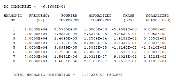

I fixed some bonehead **it in my PSpice schematic, also reverting to the original biasing scheme for the diff pair and lower VAS (getting rid of a surface mount part in the bargain). I'm now getting around 1 mV of output offset - no surprise, as the PSpice models for the input diff pair assume identical devices. I'll run a scan when I get back in to work tomorrow to check distortion now that the input diff stage is all nicely balanced out. Yes, I will be matching transistors for the input diff pair and thermally coupling them together when I finally get around to laying out and building this thing.
