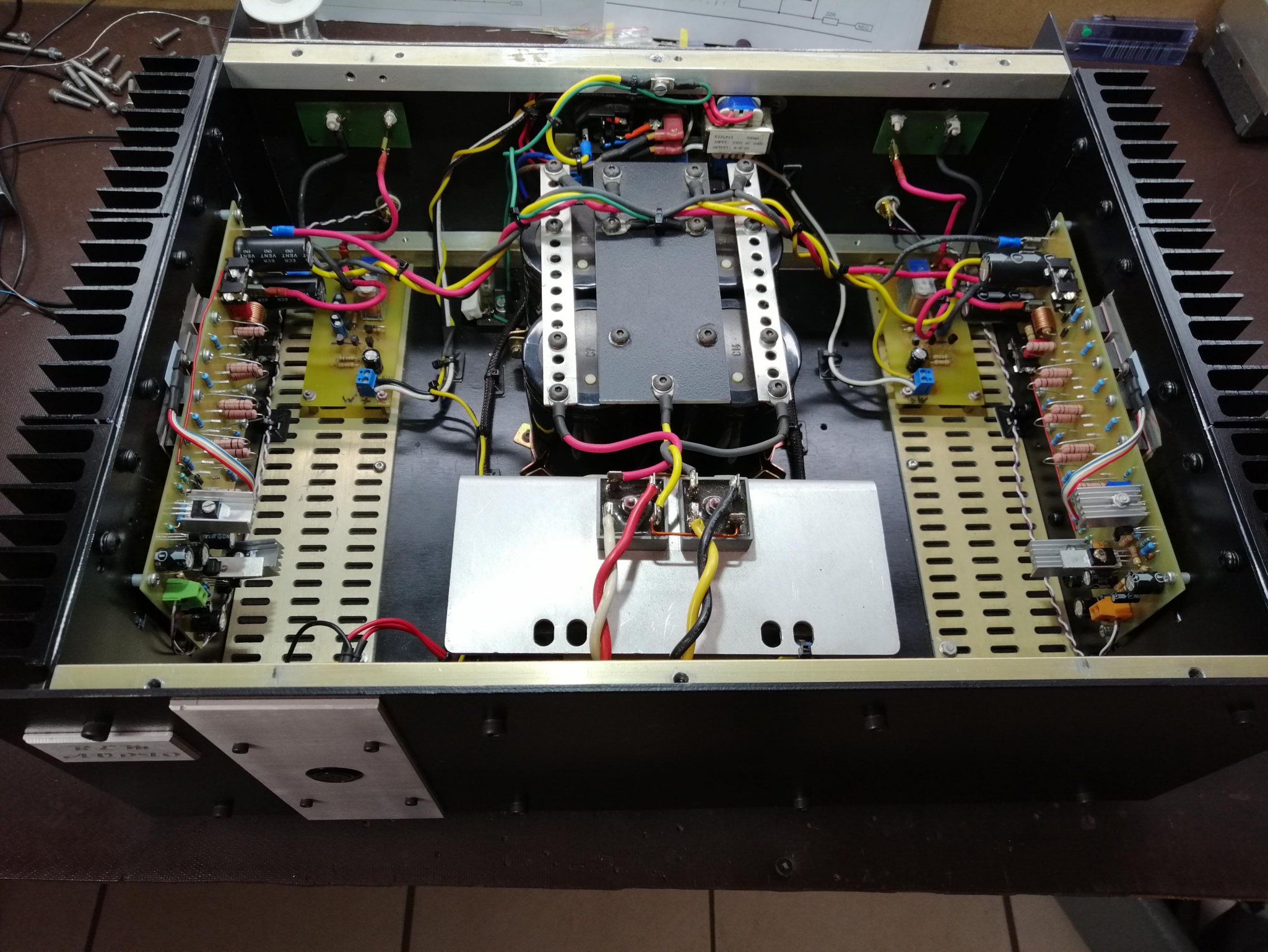

This was my build, a really great sounding and very solid amp. Thanks Mr Pass for the design and osscar for the help. !!
Still doing its job on big PSB bookshelve speakers of my son in law.
And thanks for Prasi for his PDF files ..
