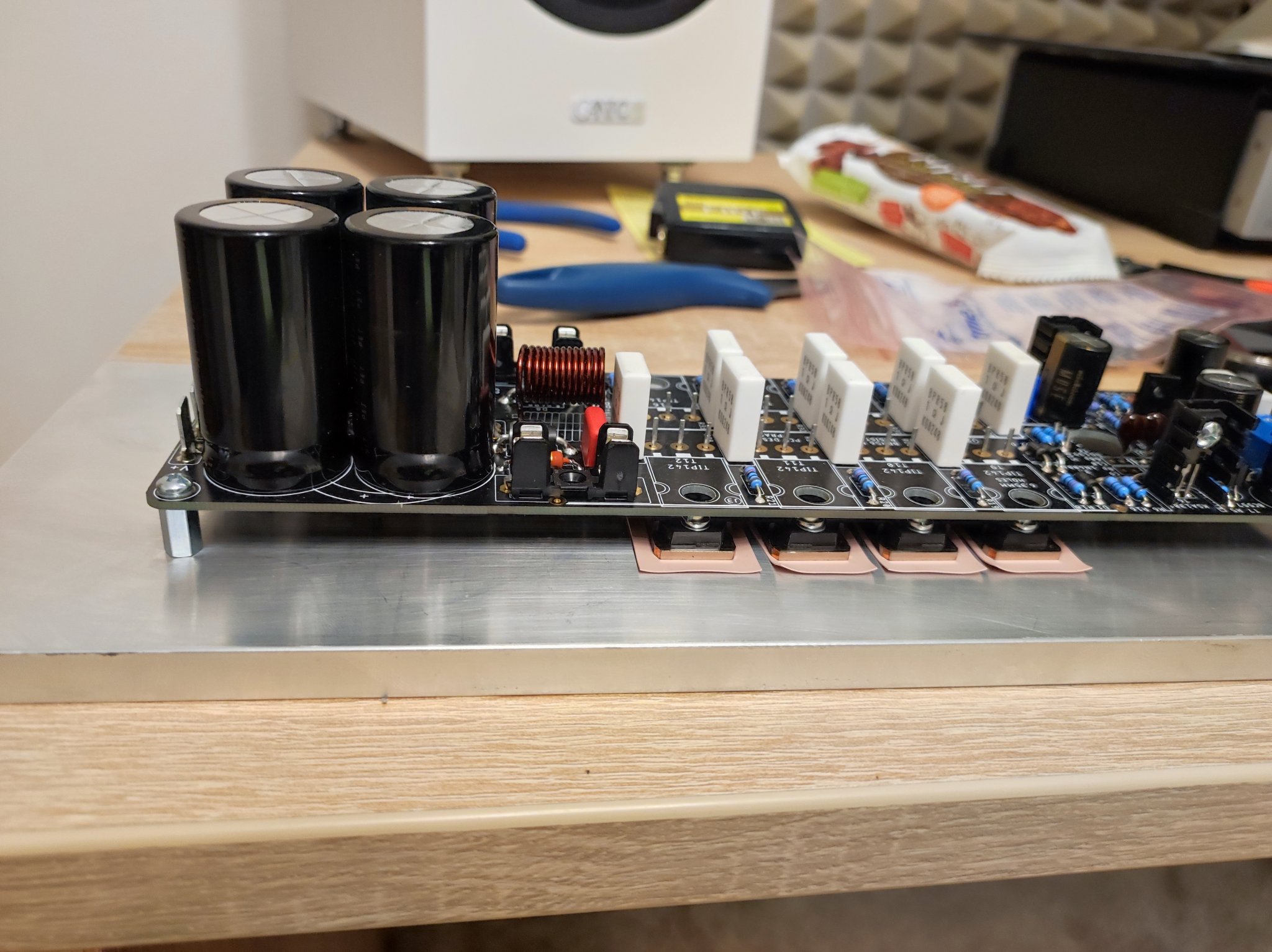

Complete AB100 board with SANKEN transistors on the test heatsink.
Just assemble the power supply and we can proceed to the tests, ... 😀
I couldn't stand it and had to do the first sound tests, ..
I've only listened to the mono, but my first impressions, but I expected more from the AB100. The bass is very decent, certainly the extreme filtration in the 67.000 uF + 225W toroid power supply has its share in it. The presentation of mids and highs doesn't sound as clean to me as on my Audiolab 6000A. But you certainly can't compare strereo vs mono...
I'll revive the second channel, throw it in the mudushop 3U box and then compare again.

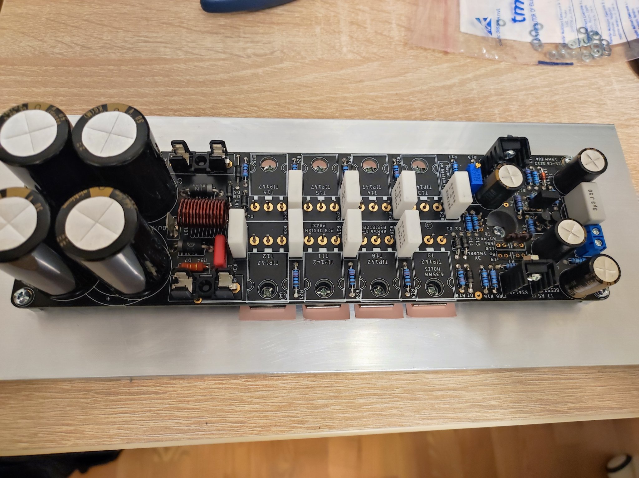

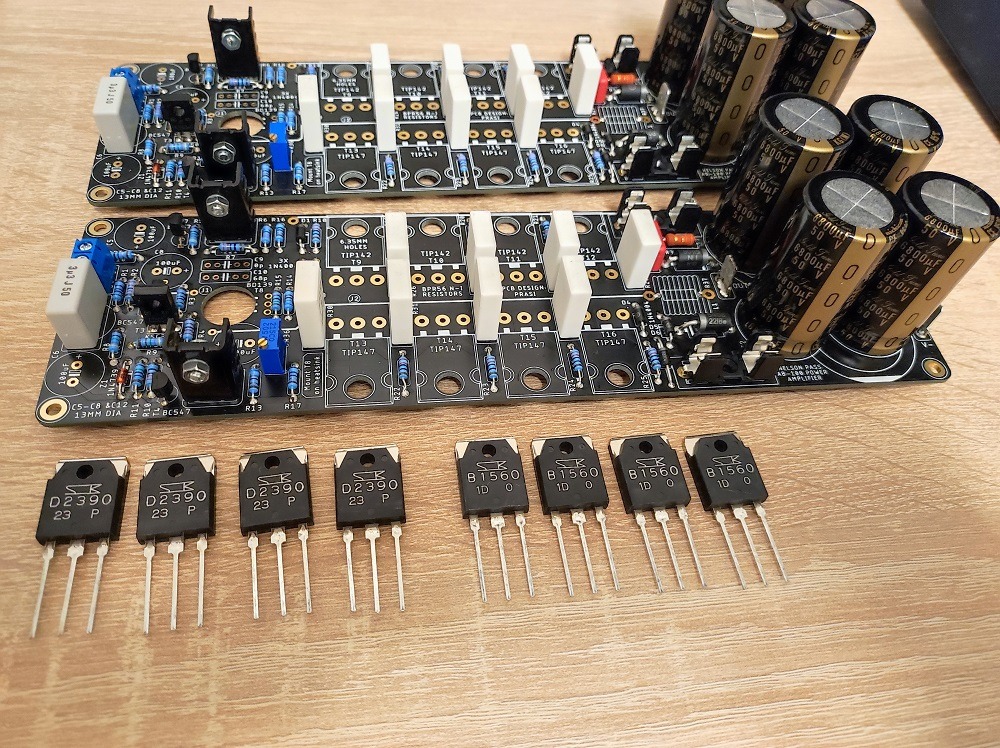

Friends, my AB100 boards are almost ready, ...equipped with Nichicon (4x 6,800 uF) from the KG series. I'm only waiting for small capacitors ELNA (100uF) and ceramics from Charcroft Silver mica.

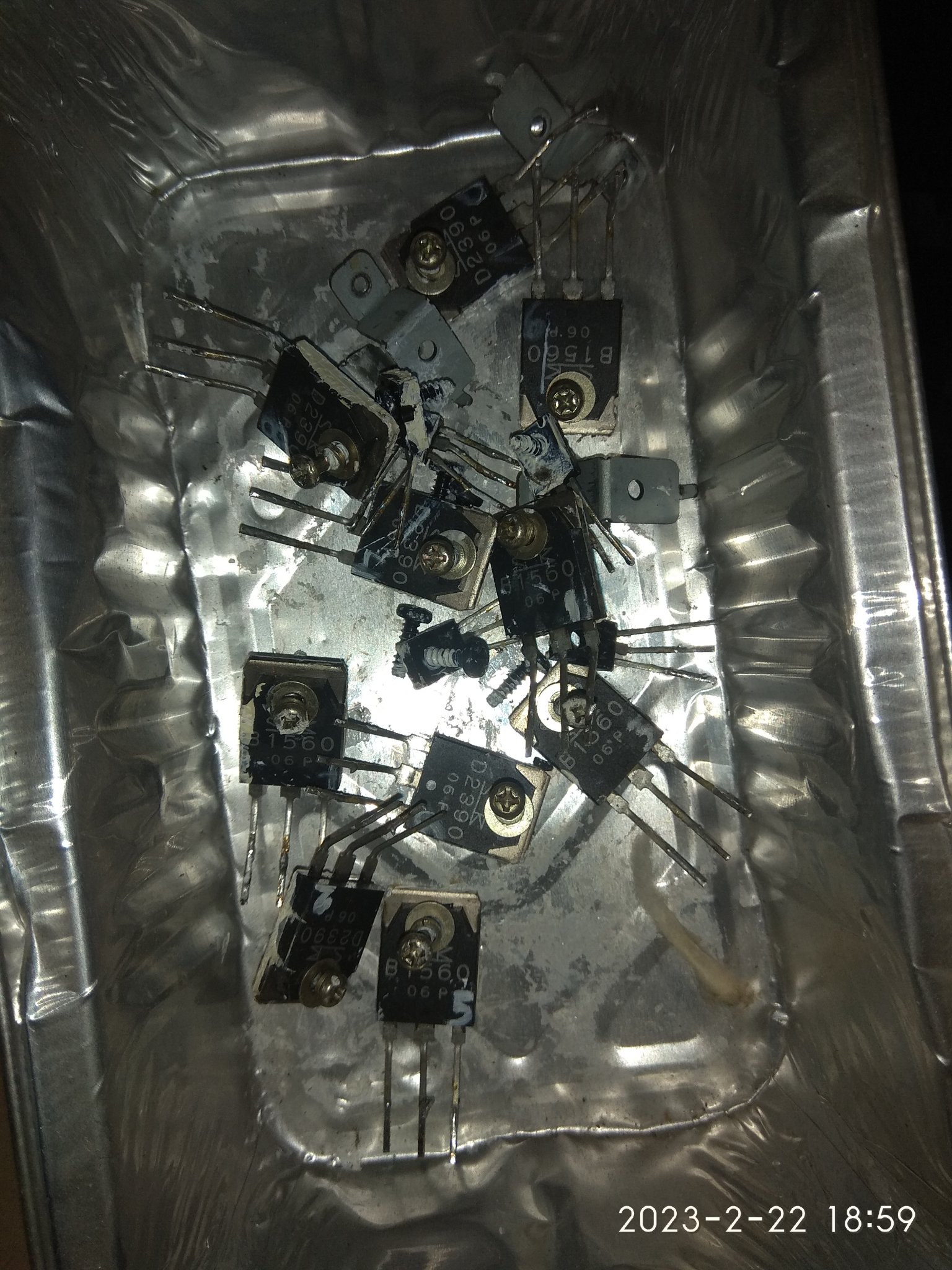

I am going to use sanken 2SB1560/2SD2390 transistors. Have any of you used anything other than the TIP142/147?
At the moment I'm going to install parts for the SSR protection 🙂
The whole amplifier will be designed as dual mono, 2x toroid, 2 power supply (4x 10.000 uF) in a 3U box from Modushop.

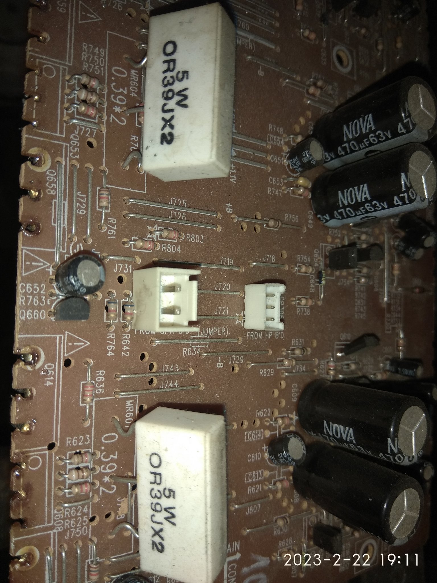

From a salvaged THOMSON A.V receiver..

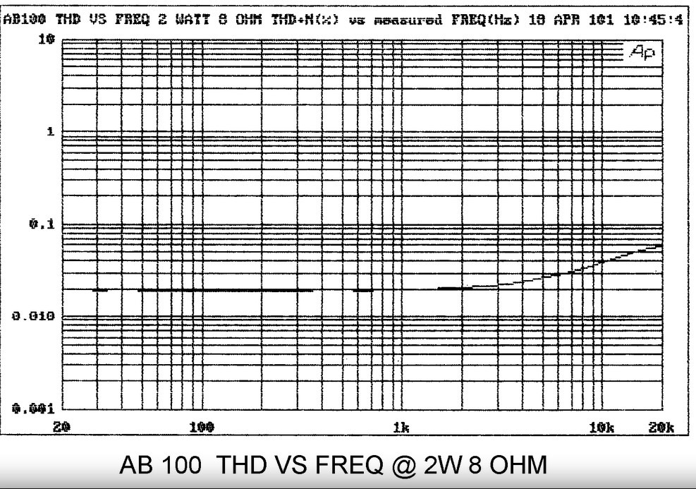

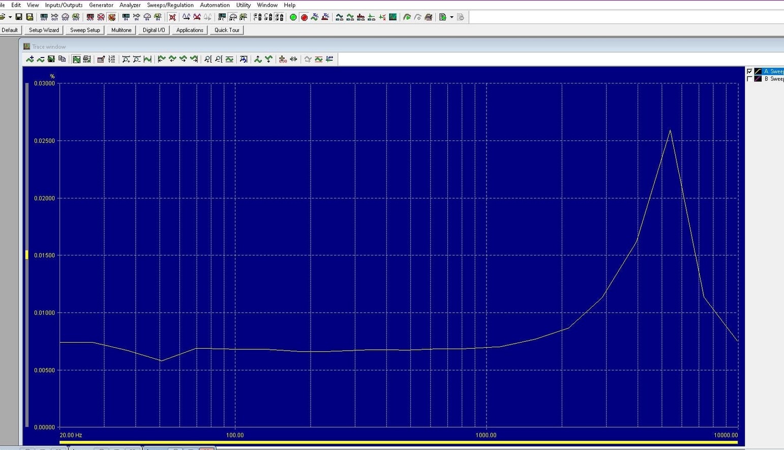

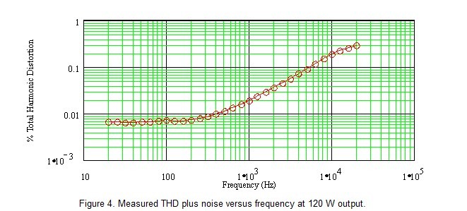

I only have a Leach amp (green background in the picture) from class AB amplifiers, but its THD at higher frequencies rises more than the AB 100. I found only one Audiolab measurement on the internet (blue background in the picture)...but it also has a higher THD at 10KHZ. ..if you extend the curve....Of course, everyone perceives sound subjectively....
