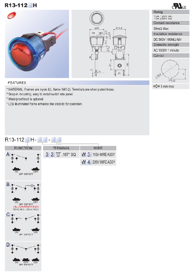

Coulomb said:On a side note this is the switch I just ordered for my Front Panels.
The units I ordered have a black cap not a red one. The blue ring iluminates in a glowing blue aura.
Contacts rated as 16A @125VAC or 10A @250VAC
