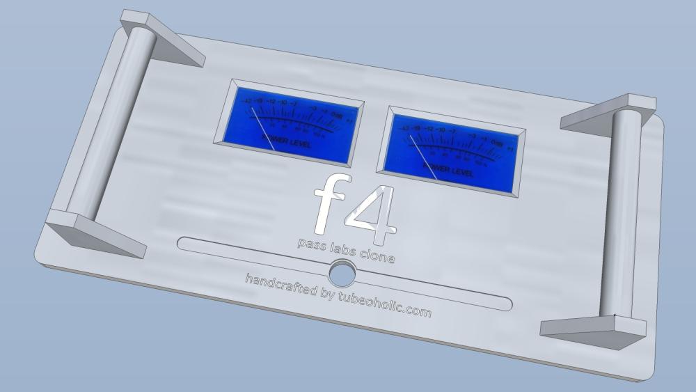

Got a shipping quote from modushop: 45EUR per case for 20 pcs. I did some drawing for front panel. Will do the back also this week. After that I'll have a better picture what the total price will be.
front plate F4 - freehand
front panel F4

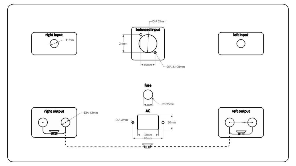

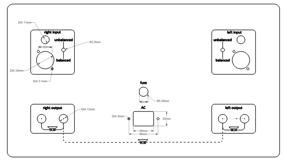

I am waiting for the final price from hifi2000. In mean while I've made two versions of the back panel for there reference, and one version of the front panel based on my specs.
Any suggestions are welcome.
I'll like to standardize the back panel to only two versions. Front panel is sticky proposal and it'll be up to builder to go wild. 😉
I have asked for the milled handles as standard in the price.
