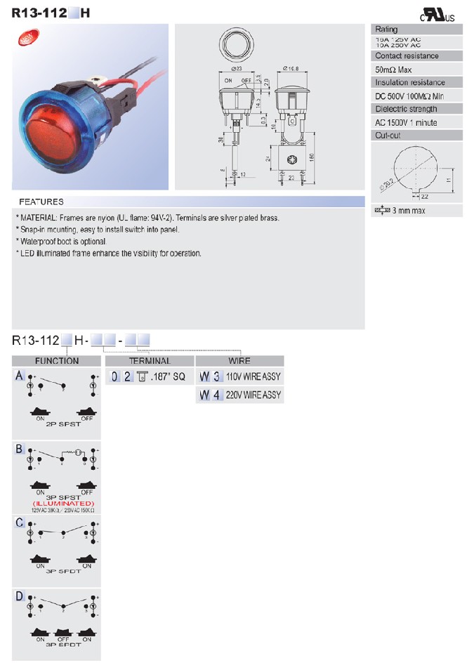

On a side note this is the switch I just ordered for my Front Panels.
The units I ordered have a black cap not a red one. The blue ring iluminates in a glowing blue aura.
Contacts rated as 16A @125VAC or 10A @250VAC
Click on image, you may get a cursor to click on to enlarge to full size for better image.

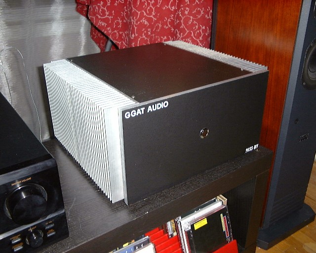

I will make a drawing and post it. In the mean time I refer back to this photo when I give the dimensions.
Dimensions for LARGE Chassis (4 heatsinks required)
Internal Roughly 14" long x 11" Wide x 8" or 10" High
- From the Front plate to back plate is approx 14"
- From one side to the other is approx 11"
- From the bottom of the unit to the top is just under 8" or could be just under 10" with bigger heatsinks
Overall Exterior 14.5" Long x 17" Wide x 8" or 10" High
- From the Front plate to back plate is approx 14.5"
- From one side to the other is approx 17"
- From the bottom of the unit to the top is just overr 8" or could be just over 10" with bigger heatsinks
Dimensions for SMALL Chassis (2 heatsinks required)
Internal Roughly 7" long x 11" Wide x 8" or 10" High
- From the Front plate to back plate is approx 7"
Overall Exterior 7.5" Long x 17" Wide x 8" or 10" High
- From the Front plate to back plate is approx 7.5"

The dimensions for the SMALL chassis can be adjusted as the ones I have picked may not suit every one. The front to back measurment would be fixed at 7" as that is the width of the heatsink. The hieght of the chassis is fixed by the length of the heatsink.
The dimensions for LARGE chassis ar defined by an imaginary box on a stereo rack 17 x 16 x 12 this allows for the Speaker terminals protruding out the back as well as the side to side and top to bottom aspects of a typical shelf.
