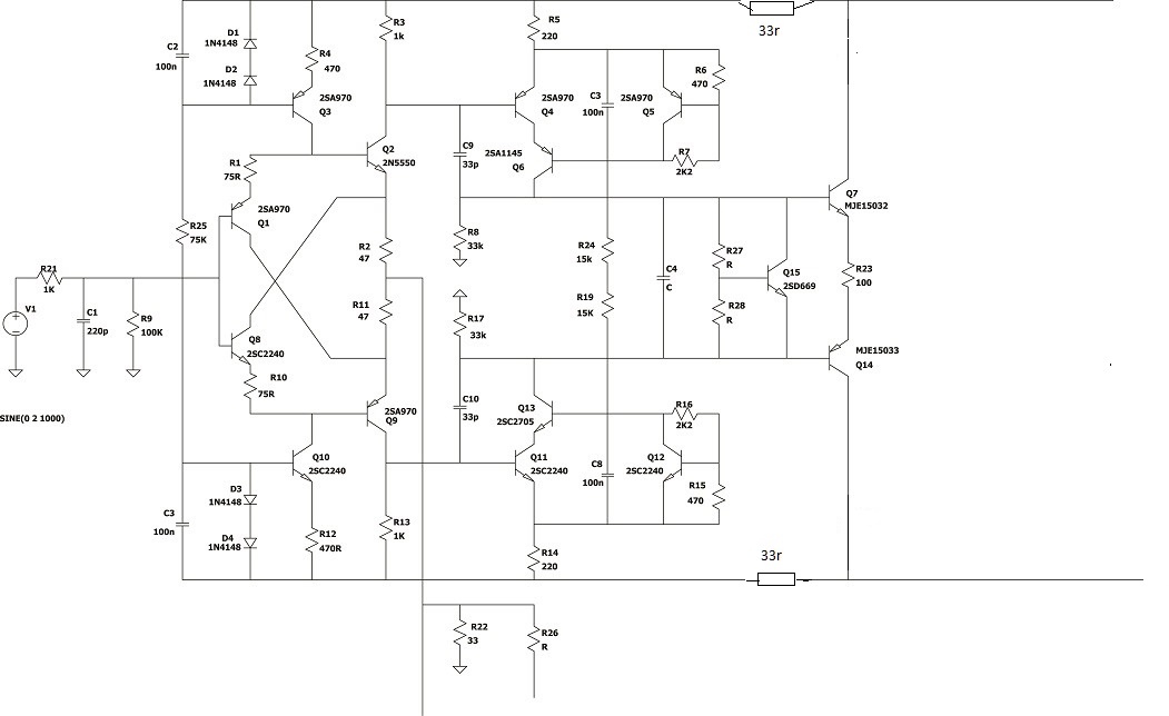

Hi Berlusconi, Parahod4, and that's it! He depicted the diagram as they say from nature. There may be bugs. Correct. The scheme is in Proteus, I post it in Jpeg. Who needs it in Proteus format, write your email. I would be glad if the diagram is useful to someone. I have not yet defeated the noise even on the breadboard, if you press your ear to the speaker, you can hear something similar to 50Hz. If you solder the IN-GND jumper, then there is no noise. If the cable is a meter long and all the conductors are short-circuited at the end to the ground, there is noise.. USB-Oscilloscope with Aliexpress did not help me (low sensitivity and ADC bit depth). I want to buy a device from the USSR (everything will be fine there with metrology, minus the age of the device).

You have made a great schematics. I have made it too but without some details. I will publish it later on so you can compare them. I will do that too. I have also made a draft of LTSpice simulation. I also plan to publish it soon.

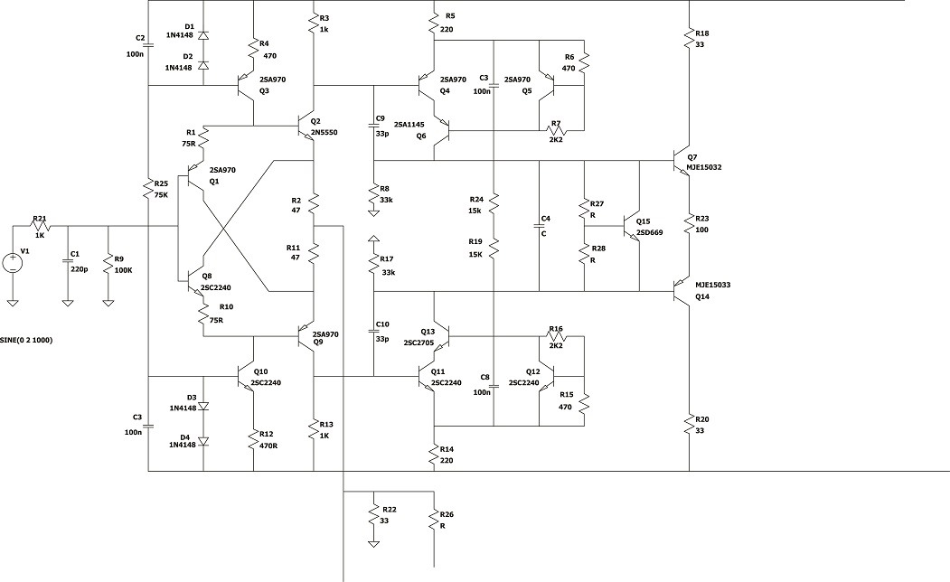

Here is my draft of LTSpice simulation. I will compare it to your schematic. Please re-check, there might be some errors. I have made it from the bare PCB. Should be accurate. Your is pretty and complete.
Zdravo Slavko,
Yes there are some missing data and perhaps some errors. I will verify everything and get back to you with even more data.
What I want is to help VMK2002 to complete his schematic, which is indeed clear and well organised. Then I would like to make a final draft of LTSpice simularion file and publish it so more experienced members may work with it and getback to uswith a working simulation file.
Could you please join our efforts? Any help is welcome indeed.
Regards
PS: R18 and R20 are both 33 Ohm, near the right edge of the scheme.

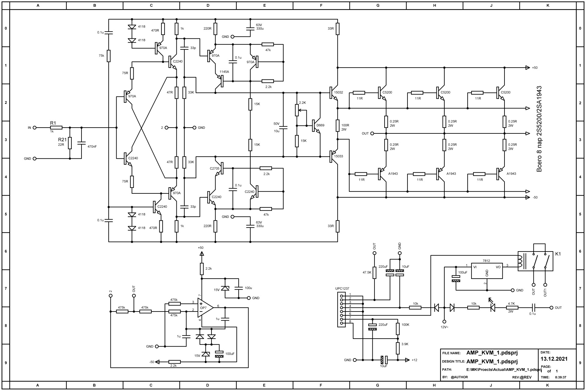

Over the weekend I will try to compare your version of the scheme and mine, I will make amendments. I already see different values of the input signal divider at the input. By the way, it seems to me that the transistors 2sa970/2sc2240 are excessively amplified, since I set the lowest volume control level on the preamplifier and already get a not quiet response in acoustics. Have you paid attention to such a moment on your motherboards? I associate this with the power supply of the amplifier from a 36V transformer. In my main amplifier Marantz PM80 MK2 SE, the power supply of the output transistors is +/- 24V in class A, and +/- 50V in class AB. Most likely +/- 50V is a lot for class A.

Meanwhile, I have installed Proteus on my PC. I have bare boards so I can verify the schematics but I think you're 100% accurate, mine is faulty and incomplete.
Please, publish your Proteus file, I would like to use it and simulate.

A proposito, quasi dimenticavo la cosa più importante... Link al progetto in formato Proteus:
