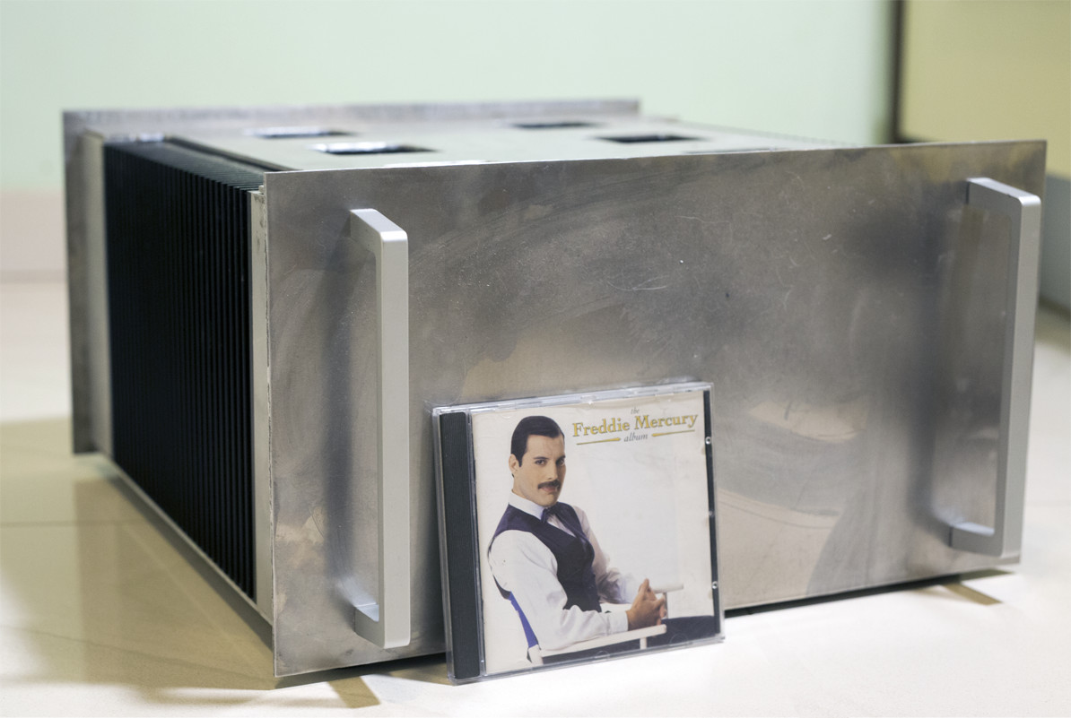

Me, Erlend, I am already building an adequate chassis. H=200 mm, W=420mm, L=460mm. Heat sinks 0,31 C/W.Thanks Berlusconi . Anybody wants to build a huge Class A amplifier?
For time being it is in raw state: not polished and without connectors, LEDs and switches. I named it "The DoubleDecker". It has enough room to place transformers in the basement and capacitance in the first flor. It has plenty of room for a real beast.
Otherwise, A60 delivers the first 20W of pure class A with quiescent current adjusted to 50-60 mV. After about 12Vrms it goes into AB mode.
Have a pleasant week end.
