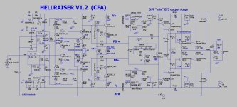

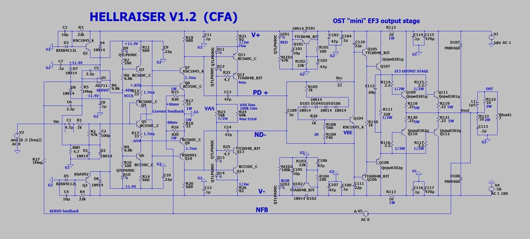

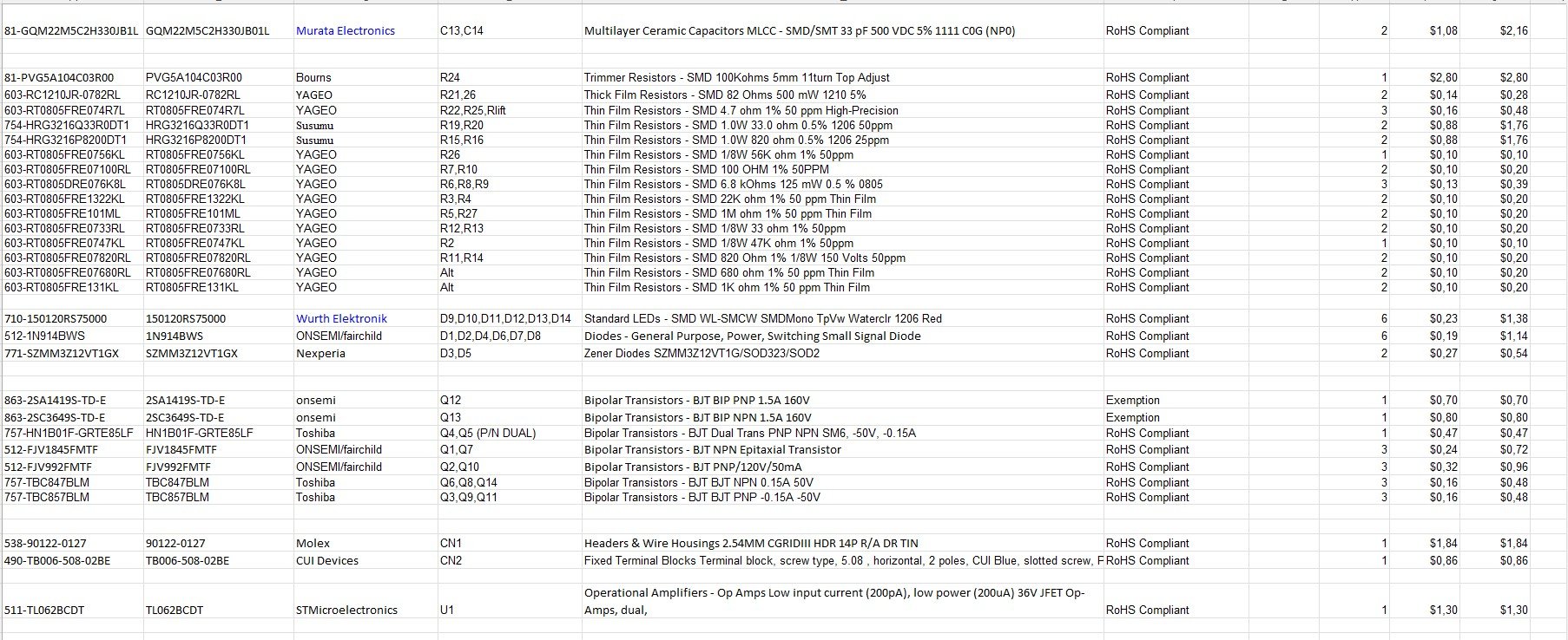

ok ostripper I'm now understanding that it's a highly performing product...I actually don't need a modular system: I would like to create a version of this power amplifier developed on a single PCB (stereo version) . So, confirm if I understood correctly please. The attached bom refers to the entire input stage: servo, vas, CF etc. , so at this stage there should be all the information I need to redo a diagram with kicad. The entire bom relating to the medium and high power stage would therefore be missing (from Q101, Q102 onwards so to speak). if everything is correct, where can I find it? Thanks again and sorry if I haven't understood correctly yet. un saluto Ros
forgive me, I forgot the attachments . I'm going in Pausa Caffè 😉

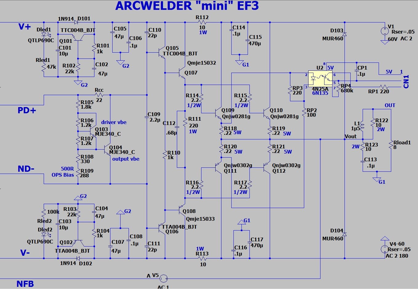

Here is the "standard" EF3. Slewmaster/Wolverine/my new stuff ...
There is at least several hundred of these working nice on the planet.
Including my old amp , the HK680.
2-3 output pairs use to-220 drivers. 4 + use to-3p sankens as driver pair.
Sanken 2sa1294 /2sc3263 are 35-40mhz with lowish Cob , better than some to-220 drivers.
Run 10 pairs , 1KW superamp.
For a sub amp , even 3-4 pair @ 50V rails can approach a KW.
OS
Reactions: inyashd
well, thank ostripper, it seems we are starting to get there; I hope to start schematic in kicad soon.
Now I'm also looking for the BOM of this final stage and the documentation of the cn1 output.
Can I bother you again if I have any doubts? for the moment thanks ostripper, a good day to you and all the other guys.

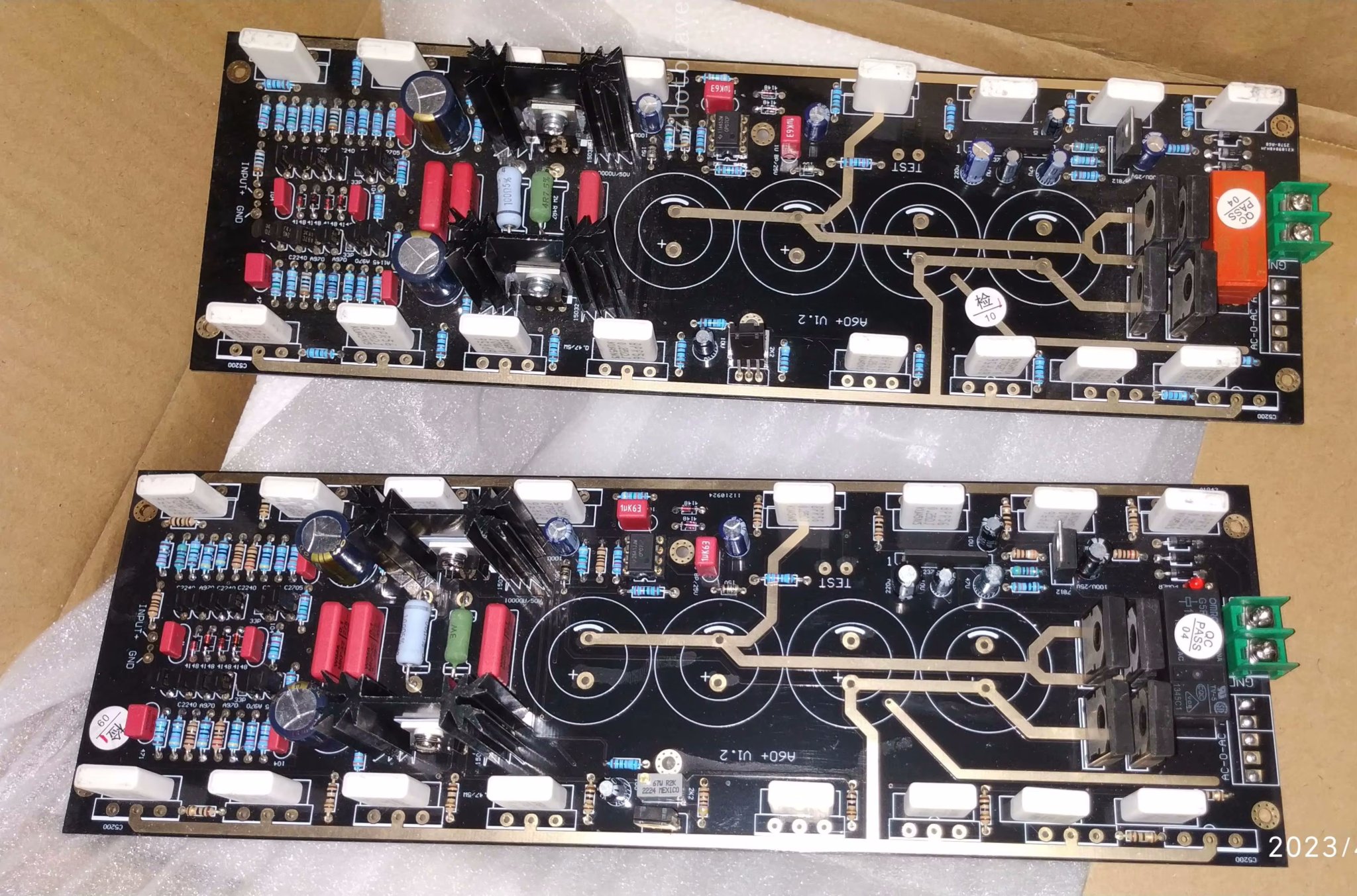

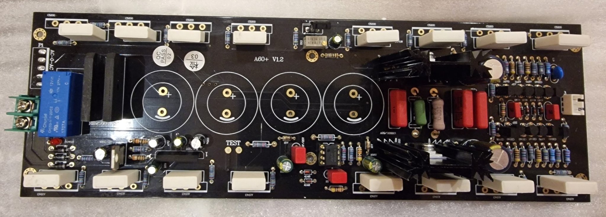

Dear Forum Members,
I received A60+ amplifier boards from a seller on AliExpress. The attached photo shows what I received. The board is completely different from the description and the photos provided in the seller's listing.
It lacks visible high-current traces, Omron relays, and even soldered connectors for transformer power input.
Do you think requesting a refund for these boards is justified?
I think there's nothing to worry about. On your board is printed V1.2, In the ad they show boards V1.0 and V1.1. I would be happy to receive the newest version.

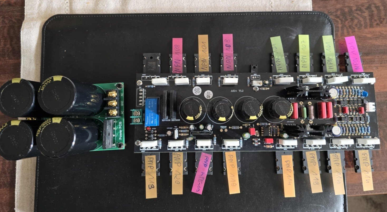

You are absolutely right. After a thorough analysis of the components on the PCB, I have to say that the parts are of quite good quality. Indeed, there is a newer version of the A60 board. I was expecting a board marked A++ 1.1, but instead, I received A+ 1.2. The number of plus symbols was misleading. It's time to get started with the assembly. First, I’ll measure the components on the board and pair the power transistors. Thanks for calming me down—sometimes we react too emotionally instead of taking a closer look at the problem first.
Thanks @Berlusconi . I will take a photo over the weekend when i get the heatsink. The fins alone is 10cm long on the heatsink. It was cut off a massive piece of heatsink so i think it's going to look really nice and work really nice. i just need to send it in for machine work to prep the mount area for the board.

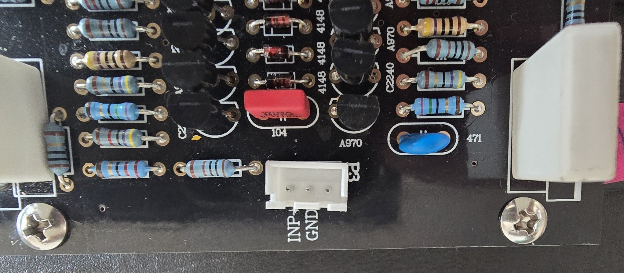

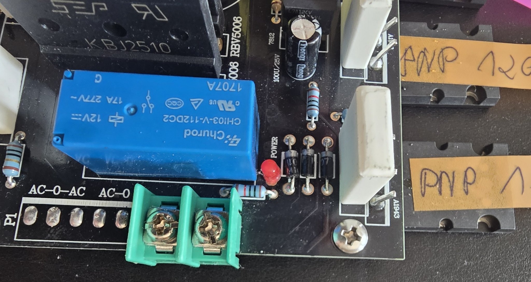

However, I still have some questions regarding how to connect the amplifier PCB. On the photos you attached, there are clear terminals for connecting the audio input to the amplifier PCB, but on my boards, someone (an idiot) made a three-pin connector—I'm not sure why. Similarly, I'm uncertain about the audio input and power supply connections. The soldered connectors seem intended for power supply connections, given the "AC" label next to them. The audio output connectors appear to be the screw-type terminals. Previous forum posts described things differently, hence my confusion. Additionally, the lower PCB was covered by the Chinese genius with some coating, making the labels that are clearly visible on your PCBs completely unreadable on mine.
I also have another dilemma, given that I'm a novice in electronics. I'm confused about how to connect the separate power supply board (with capacitors) to the amplifier PCB, especially since the amplifier board already seems to have a built-in power supply section.
Thanks again in advance for your help!

I removed the green terminals and installed the knives. The inscriptions AC-0-AC are the power supply of the amplifier itself from the transformer, example 36-0-36v. The inscription AC-0 is the 12v power supply to the protection circuit from constant voltage and the connection delay. The green block is the amplifier output to the speakers.
