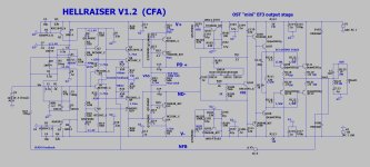

Hellraiser is born out of the CFA vs.VFA thread 14 years ago. I designed it to
stand up to the forum "best amp" (wolverine) and to dispel whether one "sounded" better
than the other.
It's actually the very coolest amp in the way it overloads , red led VAS clips nice all day.

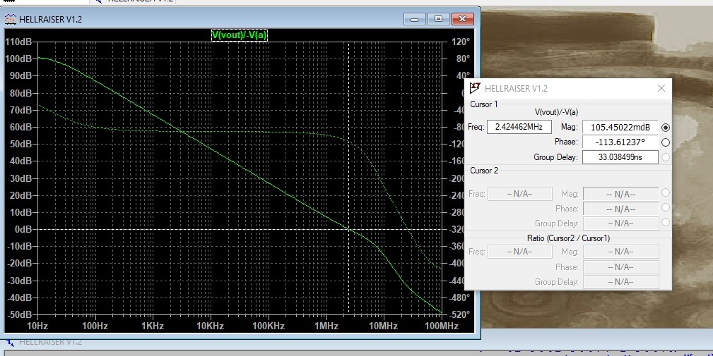

can't kill this amp. AND , it is the fastest amp @ 300+ V/uS slew rate.
Servo is ZERO offset , uses current mirrors to auto adjust bias/offset. Red led's offset tempco
in every stage. Regulated 12V input stage has -120DB PSRR !
PS - I have one of these amps , running for 14 years straight. perfect.
Cool looking input stage when it is running (below).
I actually looked at some old accuphase circuits as inspiration for this design.

good morning to all guys, hello ostripper. First of all, thanks for the reply. I've seen THE wolverine and I really like it; I would have no problem making it, but I find it demanding in terms of time (my time obviously). I would like to go with something a little simpler, like your hellriser; the circuit is beautiful: it also seems very high-performance. I believe this is the final circuit, with all the changes made, can you confirm that? with your permission I will bother you again to ask you for some clarification of implementation. For now, thanks again. A good day to all guys. Un saluto Ros ( pausa caffè 🙂
Go for it. Hellraiser is golden !

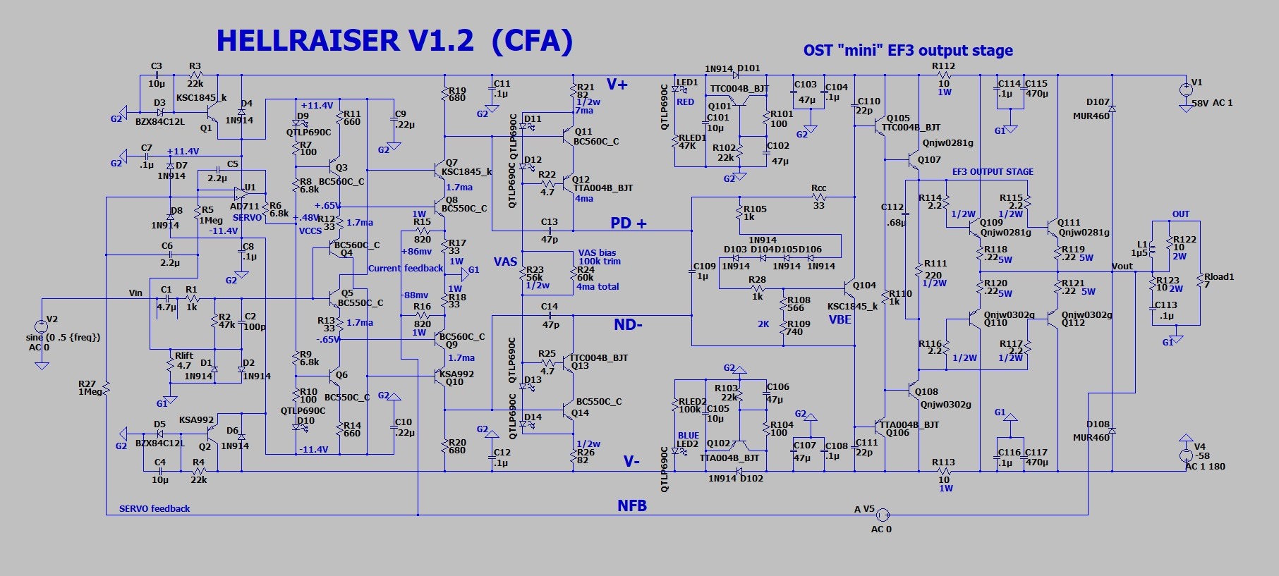

Hellraiser is the same as the spooky , except for the buffer (CFA).
As far as high performance , the Hellraiser is so fast , it can correct an underbiased output stage.
Runs cool , too. VAS is 3.8mA. The whole input stage just uses <20mA per rail.
Actually , these designs are the best tradeoff between complexity and performance.
Most sections of the design have dual uses. Like , the servo regulators also run the first stages as well
as the op-amp. The VAS will stay 3.8mA from 0C to 40C easy .. very thermally stable.
Made to last forever !!

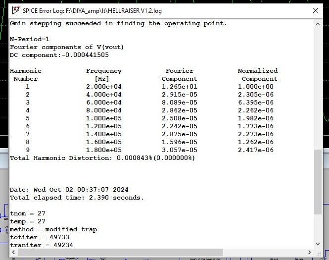

Symasui might be the king of all amps ! Can go better than topping @.1 PPM 1Khz. It is a Hitachi , Sansui , Pioneer
general 80's circuit with newer design/parts...
Strange , I also have the sim of Wolverine , can only get 1-2 PPM. The finished real world amps do .2 to .4 ppm !

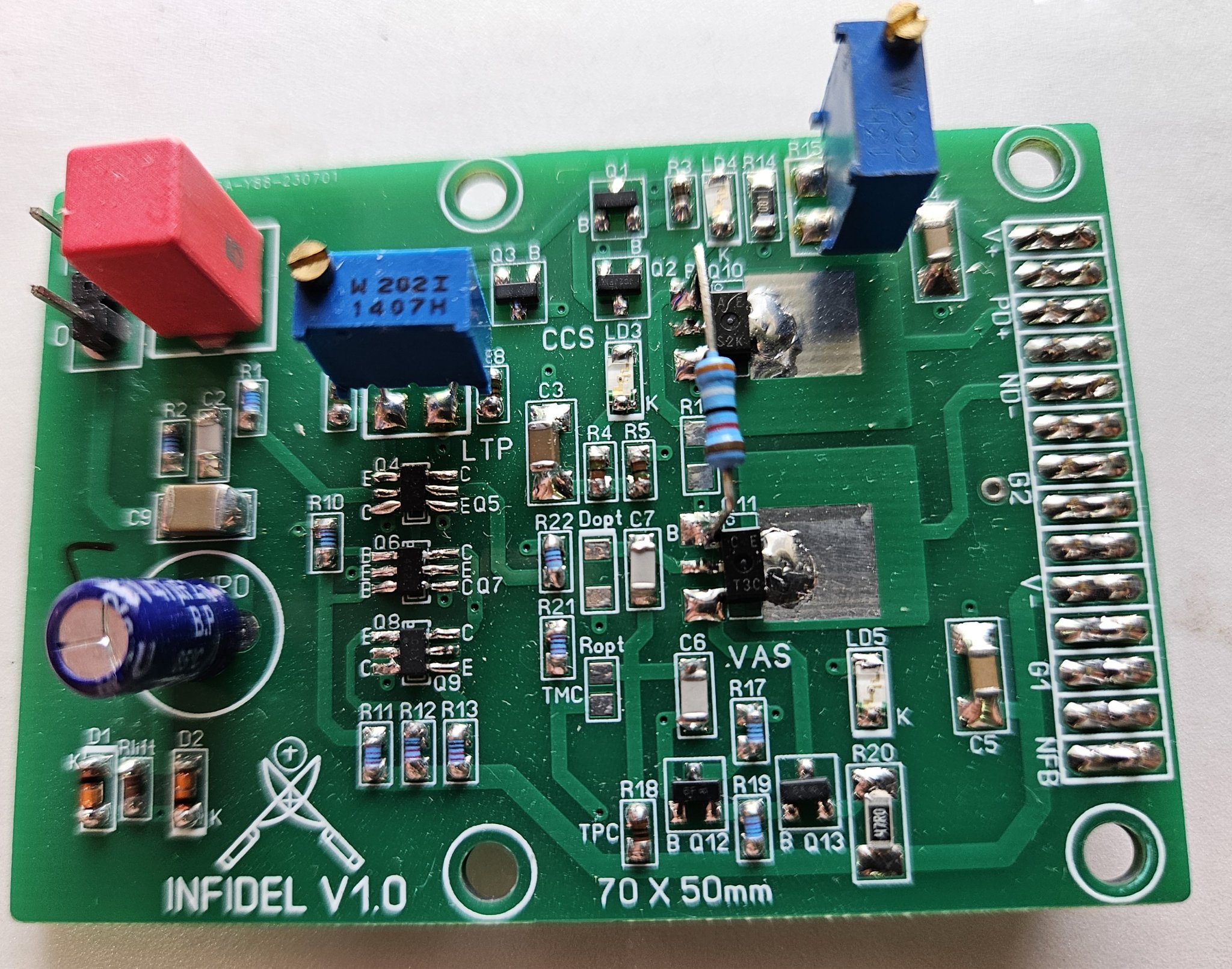

Reactions: inyashd
These are quite similar to the Wolverine.
Any of these can be plugged in to any wolverine output stage. I made everything reverse compatible.
Output stages are the refined Harmon-Kardon 680 EF3 based style (same as wolverine).
Spooky is "Leach" ( RIP ) - refined.
Hellraiser is A-60 CFA based.
Infidel is wolverine with LED CCS and cascode. your choice of feedback.

SMD IPS's can be <20$ each with the best parts. SMD silver mica's can go for 2-4$ each.
I use the 1206 and the largest SMD packages for the input stages. SMD can be small , reduce trace length (noise) ,
Most SMD is cheap ( VAS semi's = 1$) Dual packages can be pre-matched.
