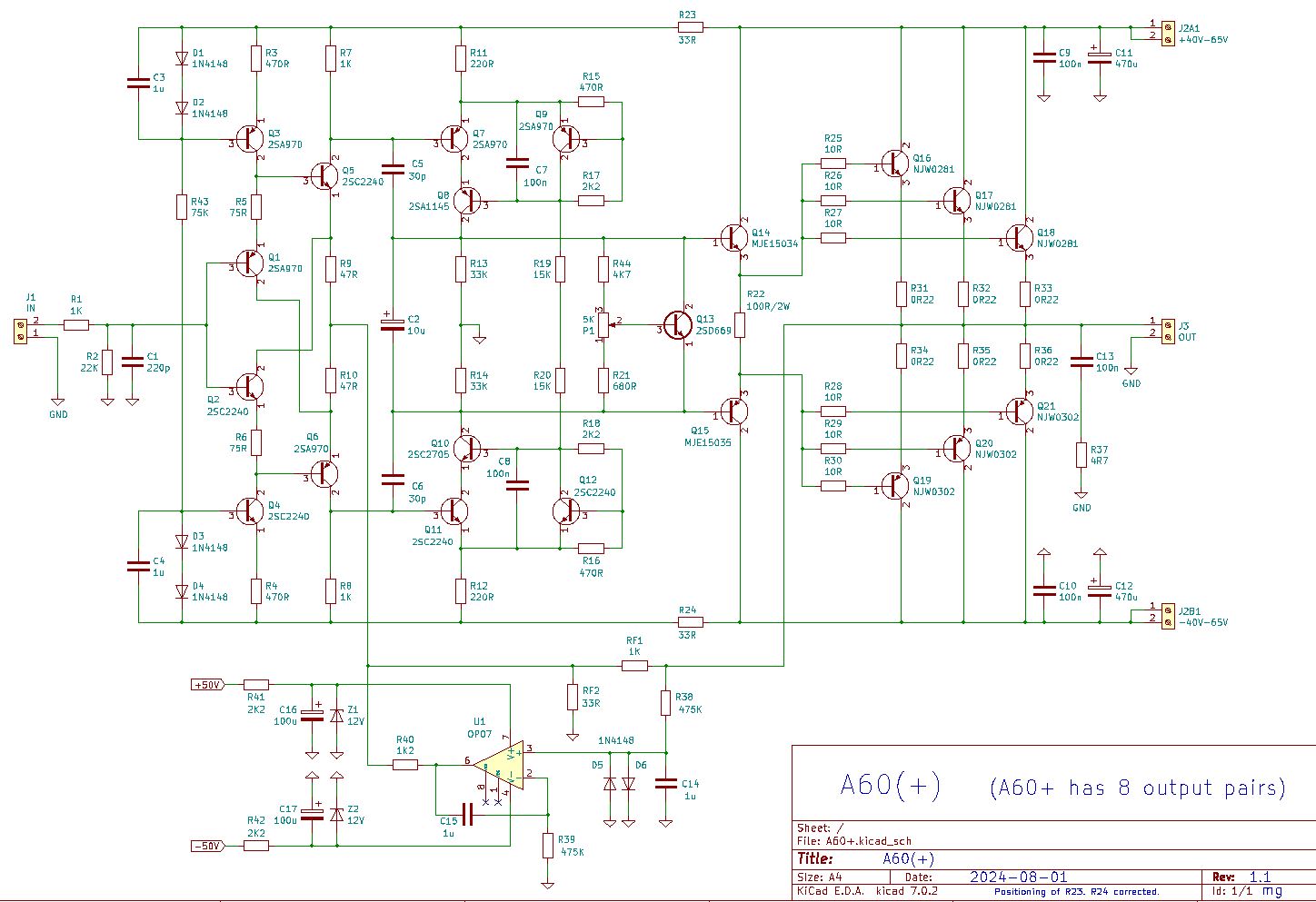

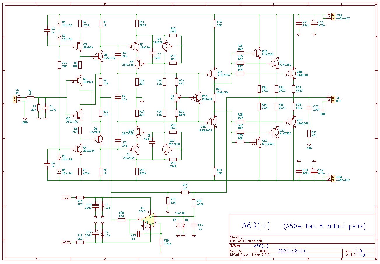

You can try TTC004B/TTA004B to Q8/Q10. Cascode stages are not very sensitive for internal capacitance. I'm using them in my amplifier, with perfect results.

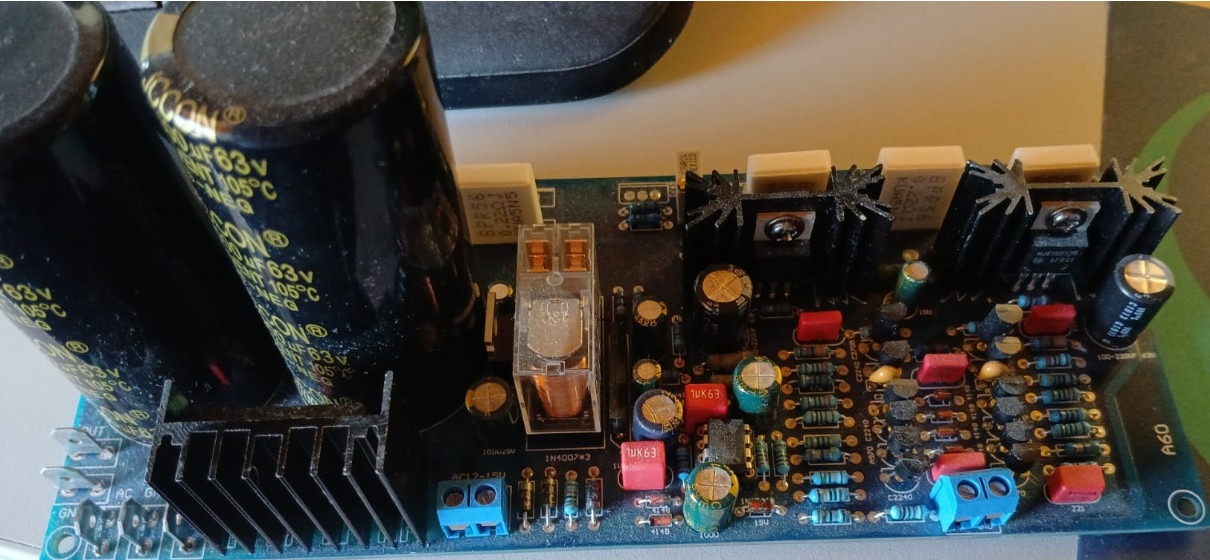

thanks for the schematic, I see that there are quite a few variations with the one I have received, for example the final resistors, as well as the transistors, the real value of the material sent is 0.25R, although the board says 0.47R, and the transistors are 2SC5200 and 2SA1943, the scheme is more like the simple A60, basically the same except the number of transistors and input capacitors, is it correct, thanks.
I have not tested them yet, I want to use for the simple A60 the box of a Luxman Avance Z504, but it does not fit if I want to use the original system of Heat Pipes, so I have released the transistors from the board to place them in the place of the Sanken, when I verify the gain of each model, I want to make an active system, the A60+ for mid bass and the A60 for treble.
in the 2 models I am going to replace the main capacitors by others of more capacity, in the A60 I have already changed them by 22.000uF unit.

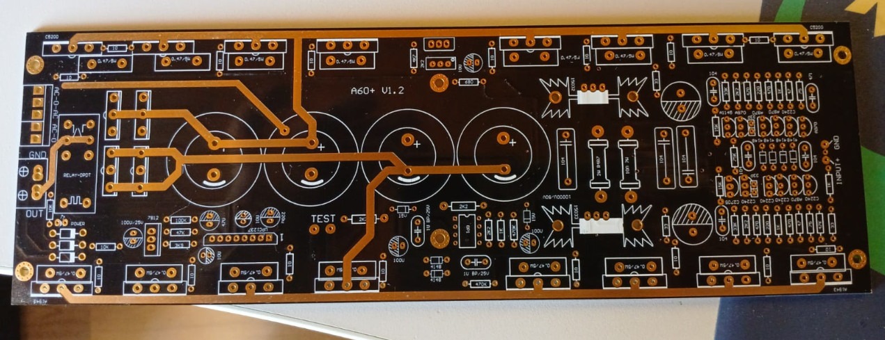

You used a bare board and a bunch of Chinese parts. Write what the sound is like and tell me about good or bad impressions.
