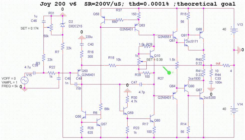

AndrewT said:C32 is too small.
It needs to be >= 22k/680r * sqrt(2) * 4u7F >= 215uF. Use 220uF.
C42 seems a bit big @ 47pF
R = 150 at output also seems big, only 8mA passing Q60 & 51.
Does the mirror load on the LTPs work when you have dual complementary VAS?
The 100 uF(still think that 47u is good) comes from low frequency ~5hz(not audible) => f=1/(2*3.14*R*C) ;= 0.16/(680*C);;;C=0.16/(f*R)=0.16/(680*47u)=5 hz.
C42 is calculated to minimise the noise band > pole at 154khz.(0.16/(22k*f)
Q60 and q51 working at 1mA ! not 8 . 2sc5171/1930 is working at 8-10ma. big input impedance for not oveloading vas => small thd . about the mirror ltp ...look at stochino's amp !
An capacitor + another R to ground will be better ? or do you want to say something else ?roender said:

Lumba, even with the simetrical amp the open loop to 20khz is still 65db
For everyone ,I just simulate most defavorable case ...
One of the input transistor with a beta common-100.
The dc output is increasing with 30mV 😉 from the original (200uV) .
Let's discuss a little abot Current feedback !
Let's discuss a little about current feedback amps .
I obtain with this circuit :
Slew rate 200V/uS . Phase margin > 70 degrees .Thd 0.0001 % .Open loop gain 137 db ; 90db at 20khz !
Bandwith 22mhz without input filter .
What disadvantages ant what advantages it brings ?
I think that the stability is one problem .
What do you think ?

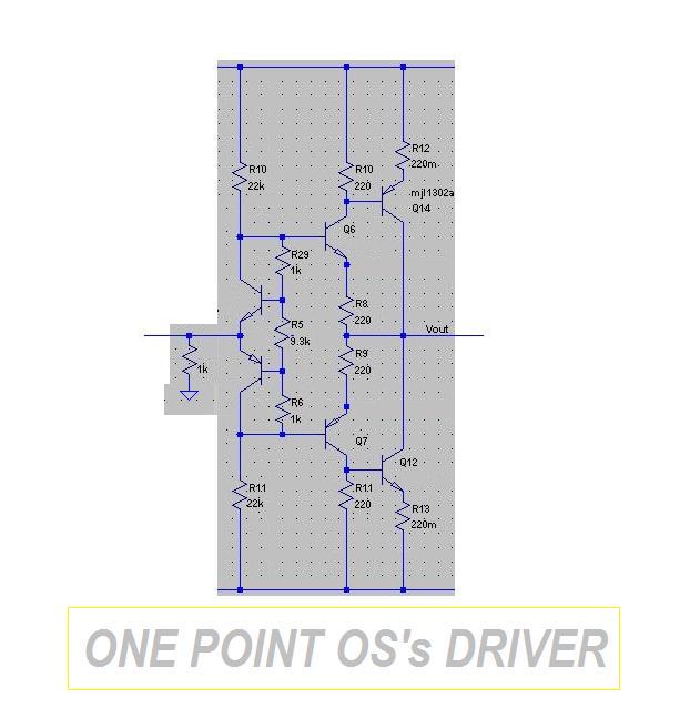

very intresting Catalin
if Q88 is 2SA1302 maybe more stable
because in CFP OS --> hFE paramenter is foundamental
between complementary in common collectors
also
have just one point to drive Output Stage... see figure
can improve stability because front-end have a common load
also
