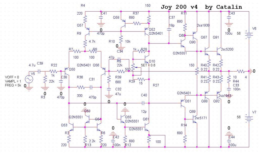

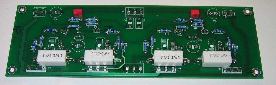

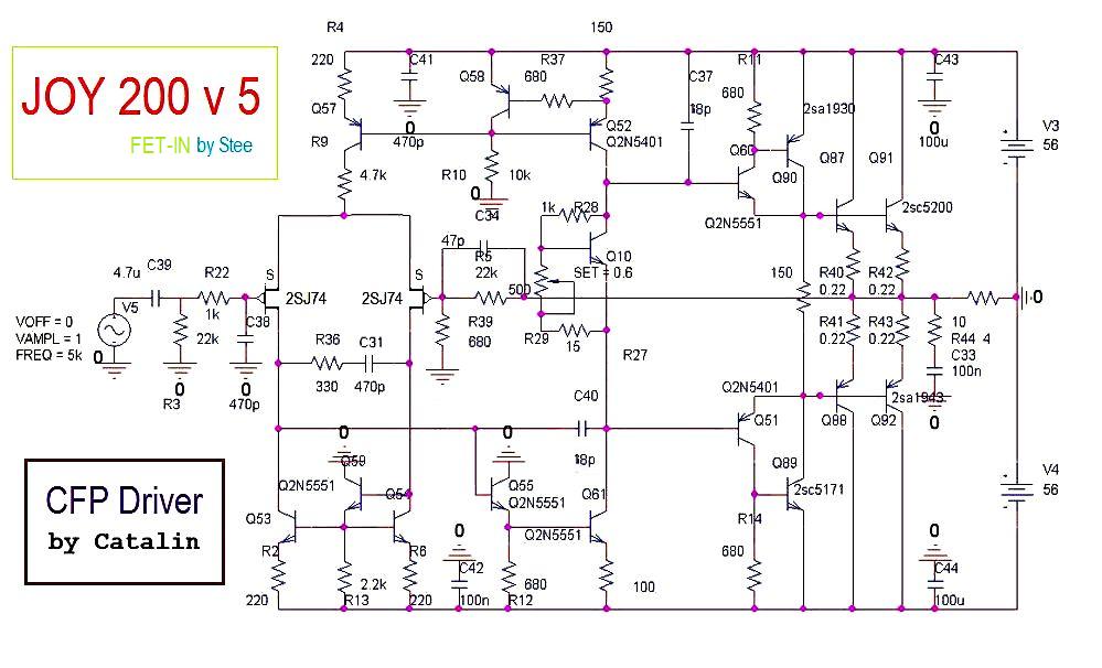

Joy 200 v4 .Testing ...
Slew rate 150V/uS ,Thd(Pout>20W,1khz-20khz,5 harm) =0.0003%
here have been improvements: the thermal regime, phase reserve, THD, slew
rate, TID, the driver failure, etc.
Outputs is still enjoying the benefits of sziklai .

Catalin you are a genius
can put a pair of FETs on input?
do you sell PCB on EBay?

Stee last year I was 2 times in Milan. 🙂 I still don't belive that is better to get rid with 47uF capacitor.The error voltage (in output ) will be splited by 22k/680 so in dc the V offset will be bigger(volts).

in my amp I always delete DC offset CAP
drift maximum 0.4V
sound much better 😉

catalin said:Stee last year I was 2 times in Milan. 🙂 I still don't belive that is better to get rid with 47uF capacitor.The error voltage (in output ) will be splited by 22k/680 so in dc the V offset will be bigger(volts).
The error voltage(dc offset) will compare the output voltage by a factor of 22k/680 since in output we don't have an voltage divider.Pls show your schematic

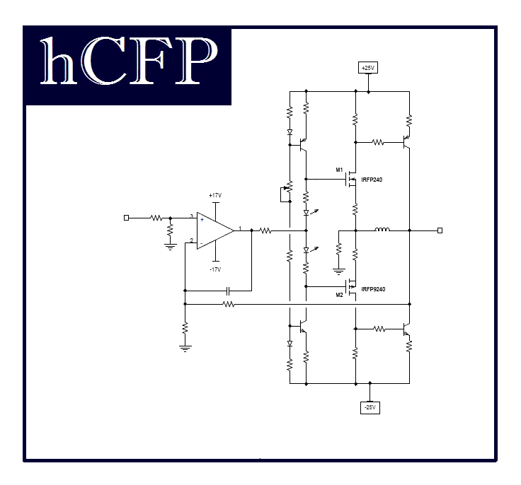

Andrew, maybe not quite on this one, I like to experiment myself with some never used ideas but obviously the theory must work.
The scheme by stee here is used by some fine very expensive highend manufacturers, let me rather say that scheme without it being a cfp. It has its advantages and disadvantages, now with a cfp it might be interesting. I use the cfp ef too but with some simple mods to further improve it, especially when it comes to crossover artifacts. The scheme by stee can also be further refined.
This might be one of stee s better ideas, Ill see what can be had of this.
Plenty current can be flowed, if I can give you one reference look at eletrocompaniet outputstages, theres something they do very well, loads and loads of powerful clean bass. I have 2 nemo s and 2 aw250 amps, for bass I havent heard any amp of any price be better at low frequencies.
I can supply a schem if you want to have a look.

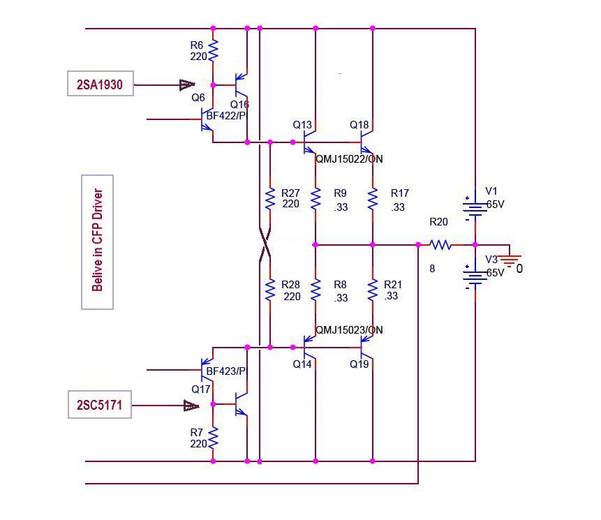

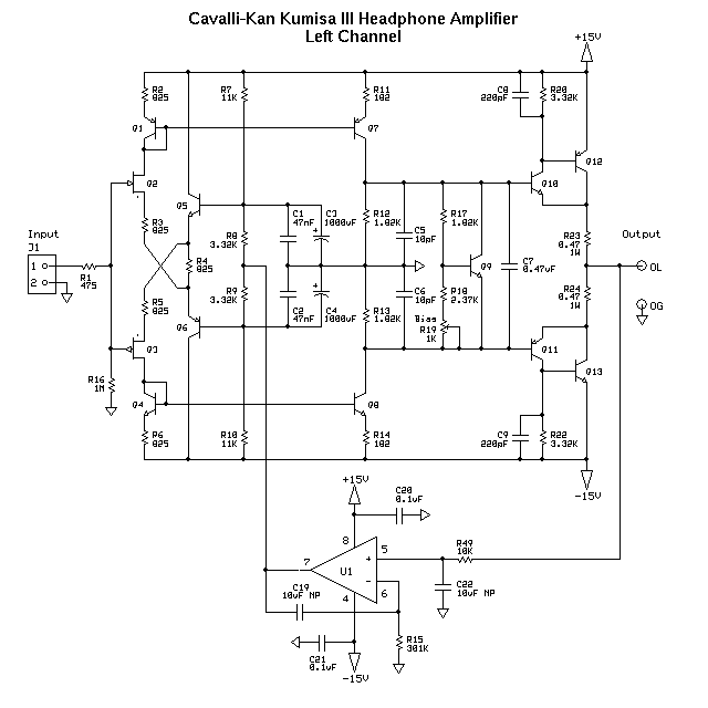

>18W through each 220r and hitting >65W on peaks. You are joking that any competent amplifier is closely based on Stee's schematic.
Yes not with the values he has, do you have email, Ill send a proper schem. The resister is best exhanged for a current source, stee must get his basic electronic theory right.
Yes, that's why I wish he would stop posting his "perfect" schematics.homemodder said:The resister is best exhanged for a current source, stee must get his basic electronic theory right.
Rather, he should be asking how to make them work.
There are dozens of them now and they are littering threads around this Forum.
