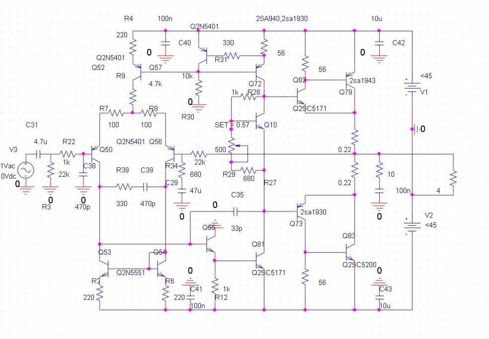

PCB for JOY 200 v3
..... 🙂 JOY 200 V3 PCB right here http://i40.tinypic.com/25a0oas.gif all the best alex mm 😀

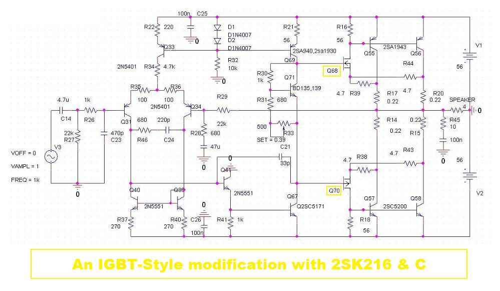

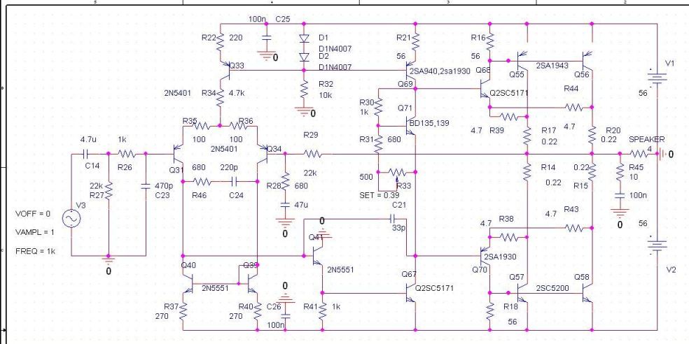

Four years ago I posted a thread "The Ultimate Suplifier" in which a proposed a combination of a EFII and a sziklai output. In the attachment you find the information about the reasons of this combination, the circuit of the Ultimate Suplifier and the list of components.
Who wants to build my output configuration (see figure 1) in your V3 circuit?? The only thing you have to change is to raise R39/R40 to 56 ohm and to higher the Vbias by lowering R29 in your V3 circuit to 0 ohm.
A sziklai pair sometimes tends to oscillate. Therefor the output resistors may not be wired but must be of carbon. 5 resistors of 1,2 ohm and 1 resistor of 2,7 ohm parallel gives 0,22 ohm.
Marc.
Marc.
