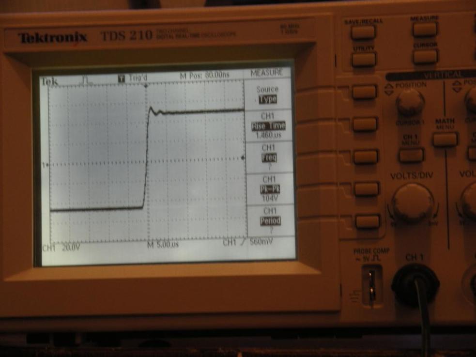

Test Joy200
The characteristics :
Thd = 0.001(2) at 1khz with 5 harmonics .
Slew rate measured by scope 70V/uS positive edge , 100 negative.
Bandwidth -3dB: 5Hz -- 340Khz .
Open loop Gain: 120 dB.
Closed loop Gain = 33 .
0 db frequency without input filter >14 Mhz.
Gain bandwidth product: 34e+6 .
Open loop gain at 20 khz : 65dB
Ic0 ! 25-40mA => Vr(output)~ 6-8 mV .

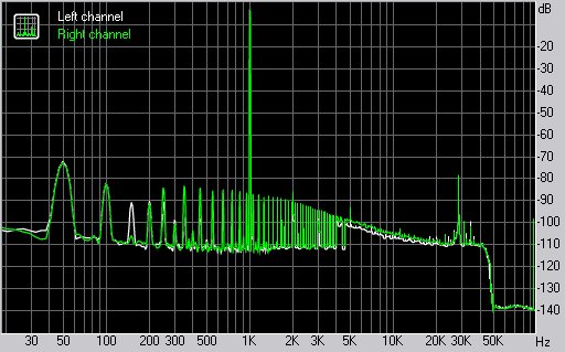

Below i tested this amp with real mark audio analizer with alc889(192 khz 32 bits) and the tda7294 ,Remember that all results are the sum of the [alc889A + one of 2 amp's] and the distortion and noise of alc889 are amplified by the amp.It may be inaccurate but it make diference between those .The load during test was a 4 ohms speakers(2 way).
Even with the MJL's the harmonics (THD)were the same (H2/5,
no H3(see below). My slew wasn't as impressive , but that was because
of the slow drivers.
So your findings confirm mine as I compared sziklai to
EF (equal H2/3/5) both in spice and CRO (FFT, no fancy analyzer).

Yes but don't forget that is the real measurement and that is the sum of the (thd_alc889+gain*thd_alc889+thd_amp) !I will measure more acurate on the future.I still think that this stage is superior mos fet and ef..(for the sound and thd).
Below are the results of the alc (only).
