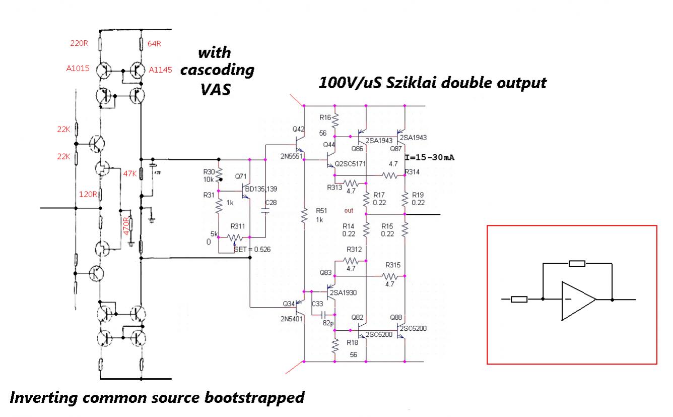

You mean, a 17mA increase. ?If we set for example a 20 mA for 35 degrees Celsius on the heatsink and then heating the powerstage to raise heatsink temp at 50 degrees the current is going to 17mA which is pretty good .This is measured at my amp.
I had found, quite the same, from simulations.
"If we set for example a 20 mA for 35 degrees Celsius on the heatsink and then heating the powerstage to raise heatsink temp at 50 degrees the current is going to 17mA which is pretty good .This is measured at my amp.
This means that is decreasing not increasing .Please read carrefuly
A decrease of the quiescent current for a temperature increase at the output transistors is surprising to me.
Sorry, I must be missing something.
Which are the thermal couplings in your amplifier ?
My couplings,on the heat-sink are only 2sc5200+2sa1943 and the Vbe multiplier .
Only these .2sc5171 2sa1930 are disposed on another isolated heat-sink .
therefore the current is decreasing if the temperature is raising and it increasing if the T of heatsink is decreasing 🙂 .
this also happens when all final +pre-final transistor +Vbe multiplier are on the same heat-sink .But more faster .

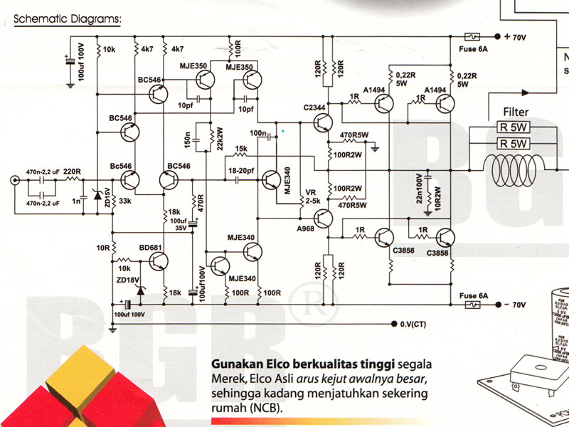

schematic similar as that from ebay
At the real kit, Tr C2344 replaced with C2073, A968 replaced with A940 & resistor on its collector 2 x 100R not 2 x 120R.
VR 4k7 & the wiper goes to base MJE340(VBE) drawing mistake on schematic I guess
From +- 70volt supply this will be wrong specification
This was I had in my mind, 70volt / 8 ohm = 8.75A Then the power P = (612.5 watt) – (some losses) = 500watt (make sense) 😀 how pity me
I was believe in this spec…😀,
wonder if it spec can be realize...
Regards
This is the schematic, similar as post #160 on ebayHello ,I can't help you because I don't know the schematic which you have .
Regards

You will get ~+-57Vdc from a 40+40Vac transformer.
or
~+-50Vdc from a 35+35Vac transformer.
Both of these will be far more likely to suit that design than 50Vac or 60Vac transformers.
