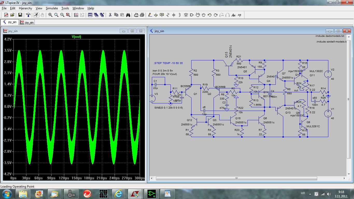

Hello ,I had the idea to limit the open loop gain by adding a single resistor to the amplifier and the sound has changed a lot .Now the music is played very natural and there are more details . The resistor is connected to have current feedback (about 60dB of feedback) which limit the open loop gain to less than 50 dB .Also the gain and phase from inputs to the collector's ltp are perfectly linear now.In simulation there are the same thd,imd and slew rate but the amp is sounding more enjoyable .The sound is warm compaired to the old version and very real .
All these on dynaudio contour 4 ohms speakers .
So overall we have firstly 60dB of current feedback and 20dB of voltage feedback .It is a vfb-cfb amp .It is possible also to decrease the feedback factor of the vfb by changing the R8 to 33 ohm and to decrease the R15(cfb resistor) to 33kohm .But I am extremely happy from what I hear in this topology .

Could you support your claims with a simulations, FFT, square wave...?
FFT at 3 volts output on 4 ohms resistive load :

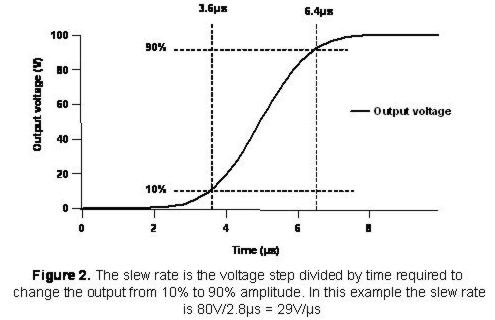

Your FFT says nothing, to get lower threshold, shorten input capacitance. To measure slew rate it should be taken simmetrically +- 90% of the square wave amplitude.

Here is the measurement of the rise time and slew rate with input filter with a Lecroy scope and also without cfb ,only vfb .The cfb will dicrease the rise time with 100ns .
From here you can see that the rise time is linear between +-90% which means the SR is the same .
And also the appearance of the voltage feedback is delayed from the one from the current feedback with almost 400 ps .
So the cfb is faster with 0.4ns but the fastest one is setting the first feedback factor .

Your FFT shows nothing below 76dB, just short input capacitance for that simulation and you will get it below that.
Slew Rate measurement.

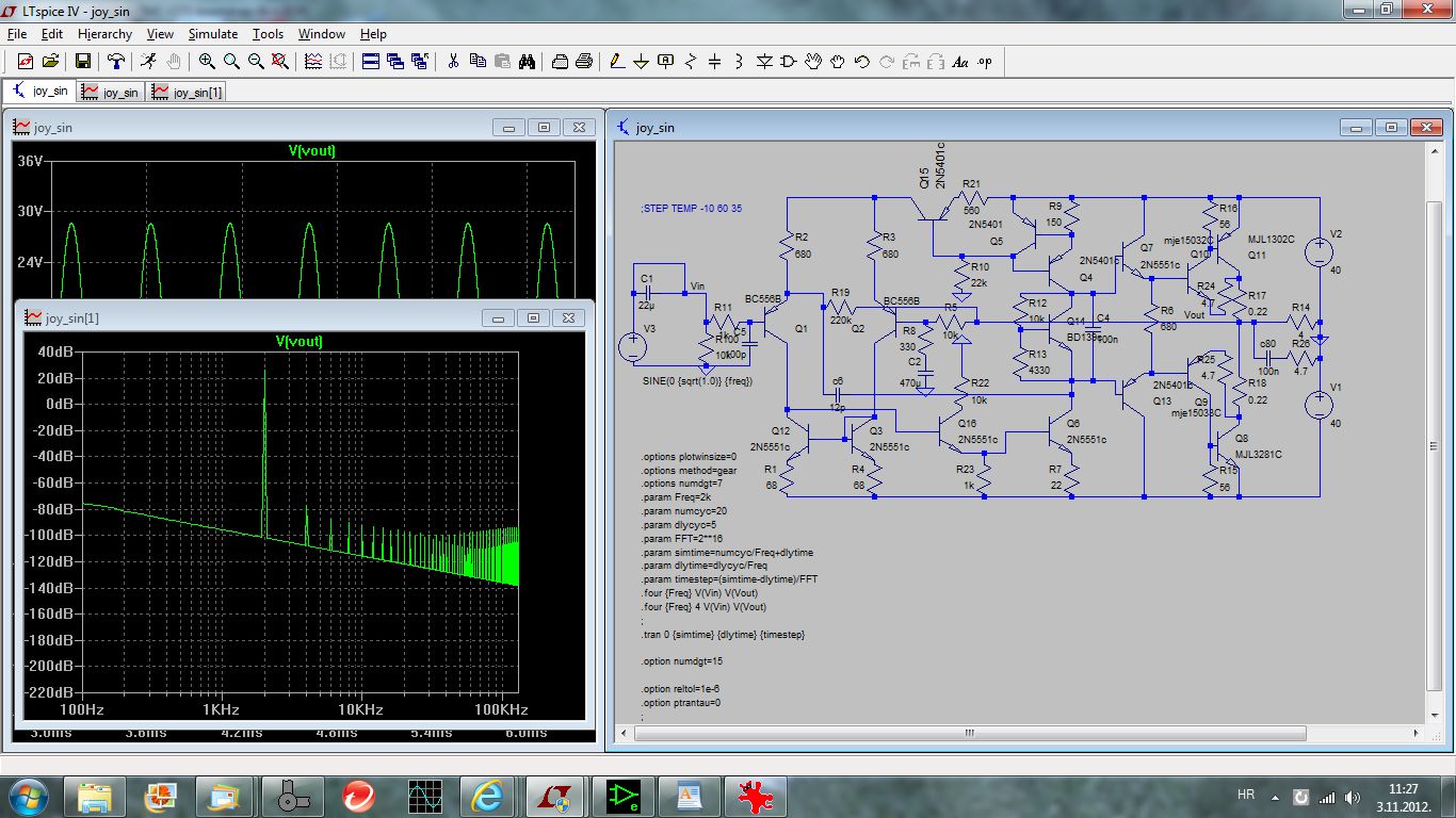

Dadod ,if thd shows :

Total Harmonic Distortion: 0.003873%
Then it doesn't matter if you have Harmonic 2 greater than Harmonic 3 or H2>H3 because you can't hear nothing under a value of 1000 greater ! For ex 3% !Try on your amp by lowering the vas load with a simple resistor and "hear" the thd .
Also by removing input cap you don't go under 73 db .
If you want to go deeper you need to change the window function to blackman or what do you need :
But remember ,at this value of thd it does not matter how the harmonics are shown,They are 1000 times lower that humans can hear ...
It matters more the phase deviation in closed loop which can be 20 degrees for ex .

Here is what I've got with your simulation. I changed drivers and output transistors as I do not have the models for the ones you use. How do you tame output triple with no compensation whats ever? When i put 220pF between base and collector of the predrivers oscilation stops.
