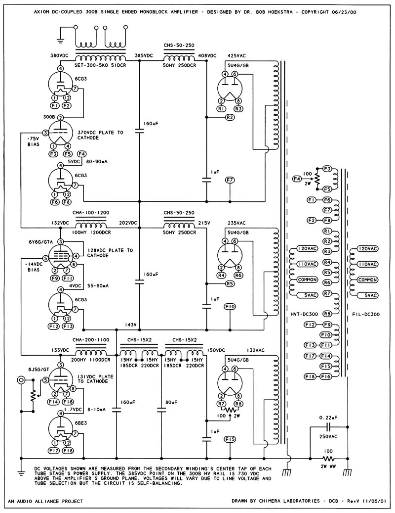

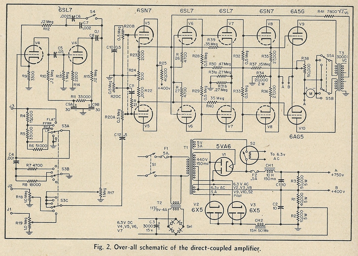

Amazing, stacked gain stages.😱 A lot of cct that with a little real design would be an order of magnitude simpler. The PT looks like a real misery.🙂
With some creative tube swapping to arrive at the right voltage demands, there might be a Tektronix scope power transformer that could be made to work. Yes, there are no coupling caps, but those 160 uF power supply caps are still in the signal path, as are all the vacuum diodes used for cathode bias. Maybe a box full of LED's would be more sonically benign?
I found this diagram in an old copy of Audio Engineering (4/1951) Less the preamp, the main amplifier is fully DC coupled. No DC can be tolerated on the input, so C10 & C12 are mandatory. R39 & R40 provide DC stability through NFB as well as close matching of most parts. R24 & R38 will need readjustment as the tubes age. A full (low distortion) 15 watts is obtained with 0.35 RMS volts input.

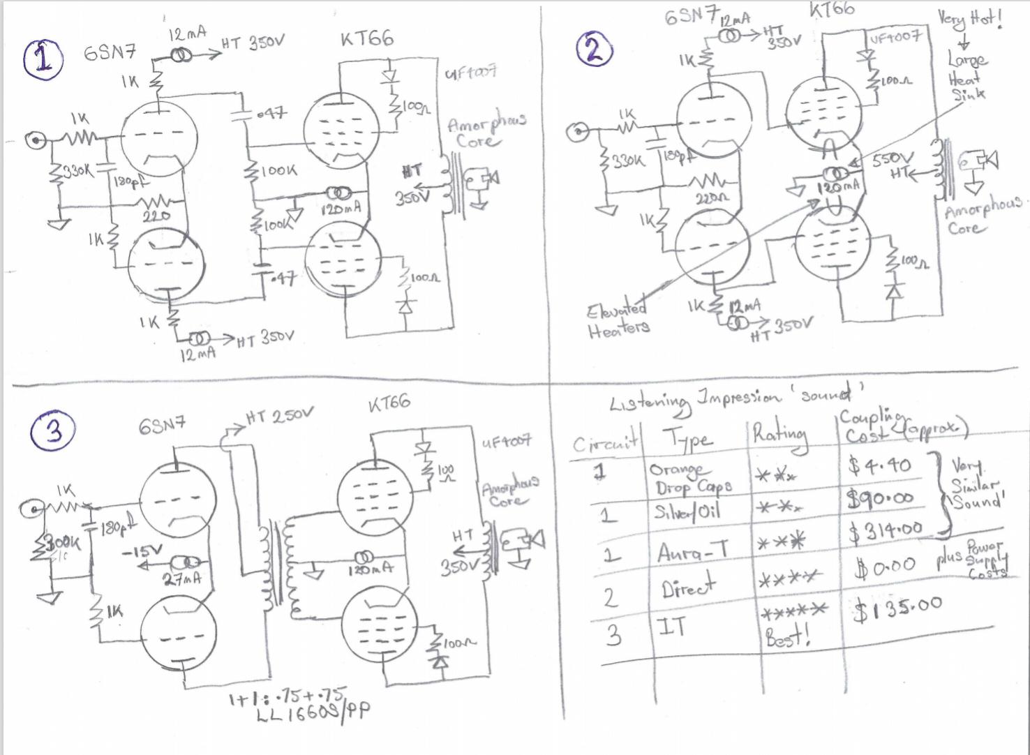

Direct vs Capacitor vs IT
A simple sound comparison between Capacitor, DC and IT coupling using a basic 2 stage balance PP amplifier. A/B switched between each and compared. Repeated this several times and ensuring the output gain was equal for all test. Not a comprehensive list of components but a list of items that I currently possess. No Feedback applied to the circuits.
I have allocated $ 0.00 for direct coupling cost, you will need to include extra costs for the power supply i.e. additional elevated heaters, and higher HT voltage.
There was not a significant difference in ‘sound’ between different capacitors compared to the difference between Direct and IT coupling.
Listening Impressions and schematics attached, these are my own personnel listening opinions.
Frank

Yes of course coupling can be replaced by coupling transformers …I was looking for sonic differences.
From my limited auditions capacitors did not sound as nice as the alternatives. I was quite surprised by the results. From the cheapest (Orange Drop) to the most exotic (Teflon) they possess similar sonics even though the Teflon capacitor were the best of the capacitor bunch. The IT coupling was a huge step forward, the sound was clean and crisp.
Frank
Different coupling requires dramatically different bias arrangements and that will make more difference than the coupling component, although transformers have magnetic core distortion and self resonance that you may like.
Joined 2009
bias
Direct coupling requires the driver plate voltage be the grid voltage of the output so you need a huge negative supply for the drivers or some other voltage stack arrangement. One reason direct coupling is not popular in tubes is because tubes age so you would have to constantly readjust the output bias.
Transformer coupling means the driver plate voltage is essentially the supply voltage vs RC coupling requires a significant drop across plate resistors. This means a transformer driver operates from ~half the supply voltage of an RC coupled driver.
Some sort of cathode resistance is essential for predictability in any case, and is minimized in the output where that would waste output power.
One direct coupling arrangement that works well is to wire the outputs as cathode followers but that requires a high driver voltage swing. The low impedance of cathode followers provides much better bass than a typical plate connected output transformer, as well as improved control of the transformer self resonance at high frequencies. However tube amps rarely afford the number of tubes required to do anything except the usual output topology.

Your circuit design with the IT has a CCS in the tail of the first stage, that's not much of a fair comparison.There was not a significant difference in ‘sound’ between different capacitors compared to the difference between Direct and IT coupling.
