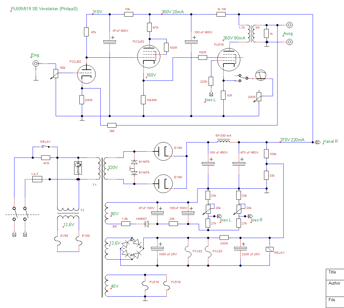

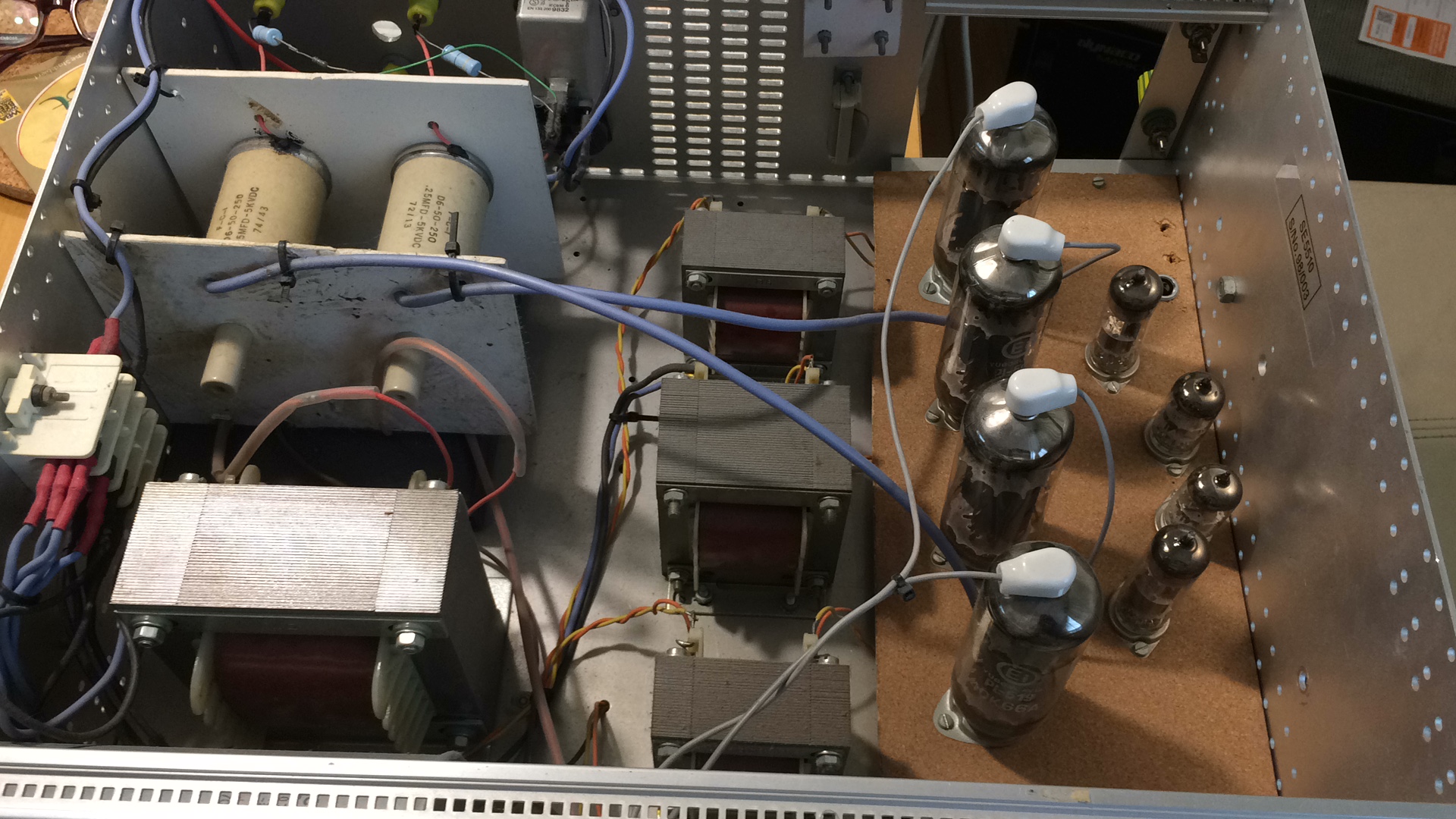

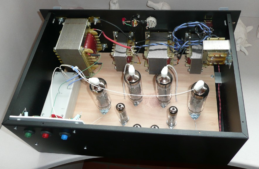

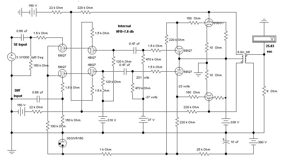

PhillipS, i like this amp, but some adjustments and improvements can be made:
First here the diodes are mandatory on the grid of the Cathode follower. and secondly the pentode cathode follower should be a pentode cathode follower and not a triode strapped pentode. Just give it a try.
Nice one. Fixed bias on top. Cool. What power did you get out on this one?
I get about 8 W per channel, distortion is mainly 2nd harmonic.
I use this amplifier a lot and it performs quite well.
The output transformers have been developed especially for the 509/519 tube family in screen drive mode.
Thanks, I will try this. The original reason fo rthe triode cathode follower was to get a low impedance driver needed for provideing screen current.
As mentioned before this circuit is based on the Synola amplifier. IIRC the motivation for development 20 years ago was the possiblity to use cheap (back then) sweep tubes that can behave quite linear in screen drive, instead of ordinary audio tubes like 300B. Of course the driver effort is higher so the benefit is questionable.
Best regards
Philipp

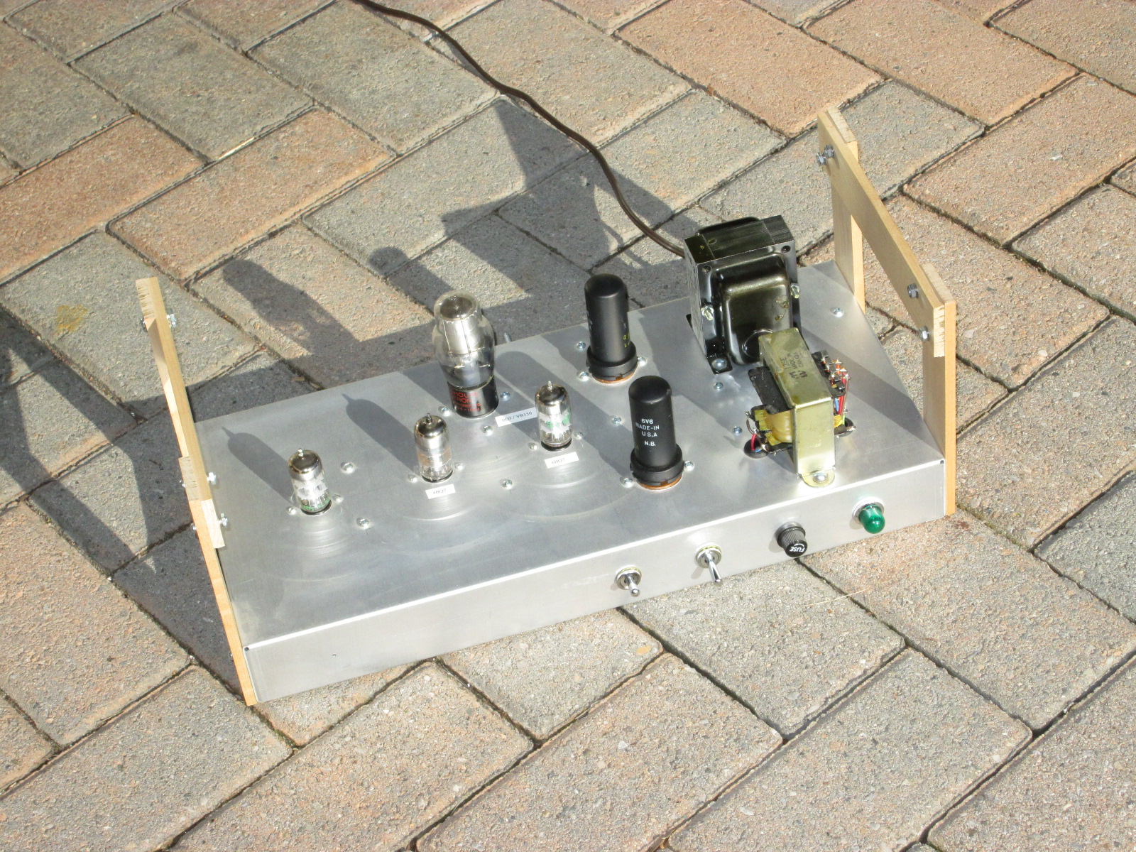

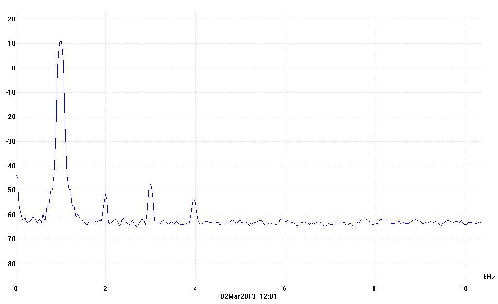

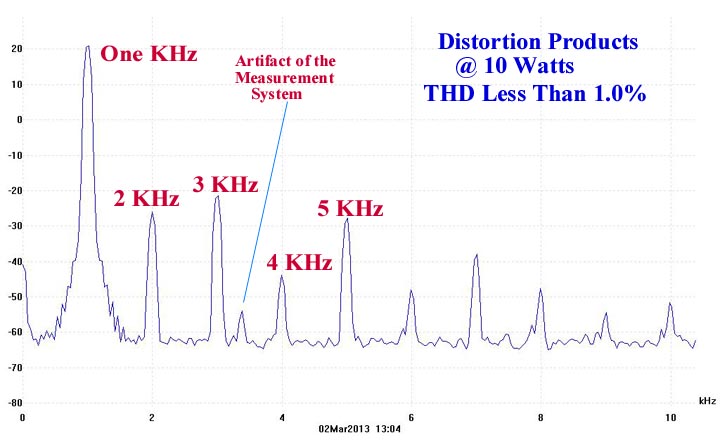

Building Something Different.........For Fun or Whatever
We do things now for fun, and we can experiment design as we please. The old guys had profitability in mind from the bean counter guy, so no room for crazy and costly ideas.
In all the years I've built audio amps I've-
1) never built a Williamson
2) never built a Mullard 5-10 or 5-20
3) never built s Dyna All that has been done by many others several times over.🙂

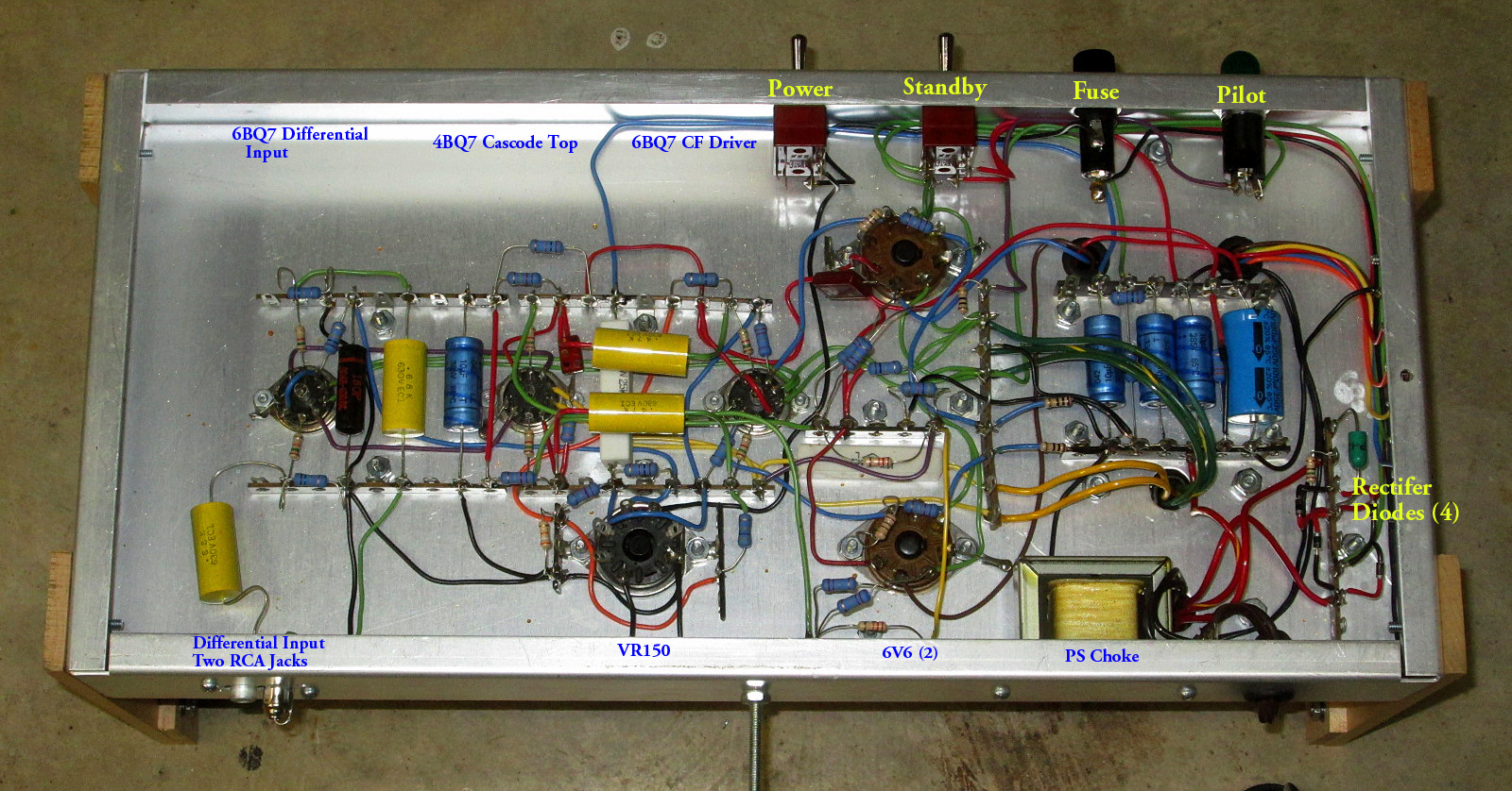

So built several amps that were at times quite different, driven by curiosity. One of the primary objectives was to keep cost under control.
Tube amps were never my day job, the day job was always hitech.
So here is one such amp, PP 6V6s DC driven by a CF 6BQ7. 26W on a regulated 340V DC PS 17W as built on self contained minimum PS +ve & -ve power supplies. The loadline is adjusted for AB2 operation, should anyone ask
Differential Cascode Front End, 6BQ7 into 4BQ7 (heater runs on 5V wdg) Common Mode Rejection >70 db. Built Spring 2004 Some may have seen this already, its been on DIY before.
At which point I got another 5 yr contract to go away & do what I do.😀

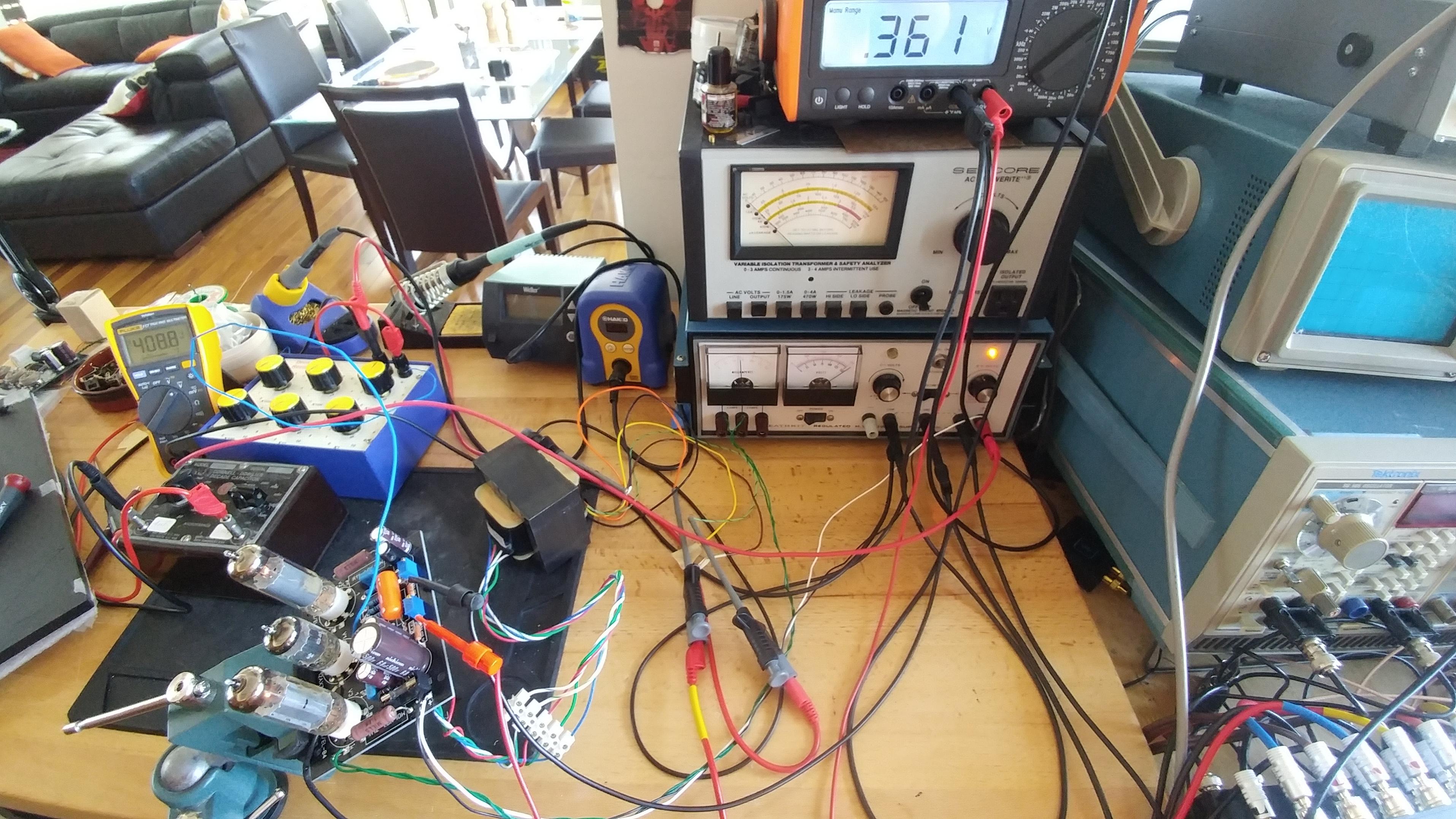

This is similar to the HV amp i have build for my Acoustats (input and driver stage). Instead of a transformer i use current sources (SRPP). In any case it is not 100% DC coupled as it still has 1 coupling capacitor in the signal.
You have some nice TE, what is the blue screen box on top of your scope?
Good TE is something many try to do without. Finding our way in the dark is difficult to impossible,🙂
The Tektronix box on the bottom right in the picture is not a scope. It is a mainframe from their modular test system, possibly a TM503. There are plenty of different modules to fit into it including what looks like an audio oscillator on the left. There were several flavors of power supplies, and even a small scope plug in.
The blue screen object on top of that is a Tektronix scope, missing its name tag above the screen. I have a similar looking TEK 2232 except it has a row of buttons across the lower face of the bezel around the screen.
On top of that, is the pulse generator.

Ditto....I spent 41 years in a Motorola plant, the last 28 were "defining the state of the art in radio communication." Before that I was a tech in the cal lab for 10 years, during the time that the TM series was new stuff.
Since retiring I have been outfitting my lab with 80's vintage TE, mostly HP stuff, one Ebay, hamfest, or equipment auction find at a time.
I'm similar to Tubelab in that I have equipped my own lab with a range of old and relatively new instruments. Some of my gear I have owned for 60 years - still good.
It has proved interesting buying old gear on eBay. Several items made by HP arrived in near perfect condition - only required old stores/accounting stickers cleaned off, and calibration. HP front panels were all painted. So, even if damaged, no big deal - they can be repainted and re-lettered.
