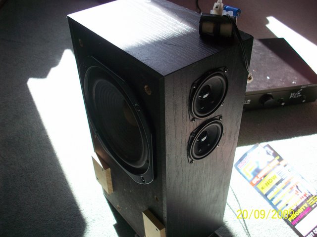

Made one speaker (see attached), by using the boxes I mentioned earlier, with an old 8" Pioneer, comming from the old 3-way era, and 2x FRS 8 (vertically arranged), with a sloped front baffle, with "stepped angle adjuster", being a bunch of CD cases (empty), got both drivers equidistant to my ears, and pressed play. As I only have one so far, I can't say anything on stereo imaging, but it sounds nice as is. The integration of the drivers is very good - smooth run from fairly low to 15kHz (big dip there).
Now to go make the other one...
Be back later with more listening impressions.
Chris

Not at the moment, as these are simple, proof of concept designs.
For the final ne (if I can justify this to parents), I plan on using 2x W130S per cab (again, visaton), which are 5" woofers, and shallow mounting enough to go push-push, and get to 50Hz in a 26L vented enclosure. Those woofers are fairly cheaply available (£19 each), then I'll need to get more components for the passive XO (it's a mish-mash of active sub XO and passive for the mid/high). And another FRS 8 (put one in a 2-way thingy and painted the basket, doesn't look so good now).
With the full-rangers' relative lack of efficiency, should I opt for 4 of them in series/parallel or just keep it 2 per cab in parallel (they're 8ohm each)? - I know this will keep efficiency theoretically the same, but more is always more, right? 🙂
