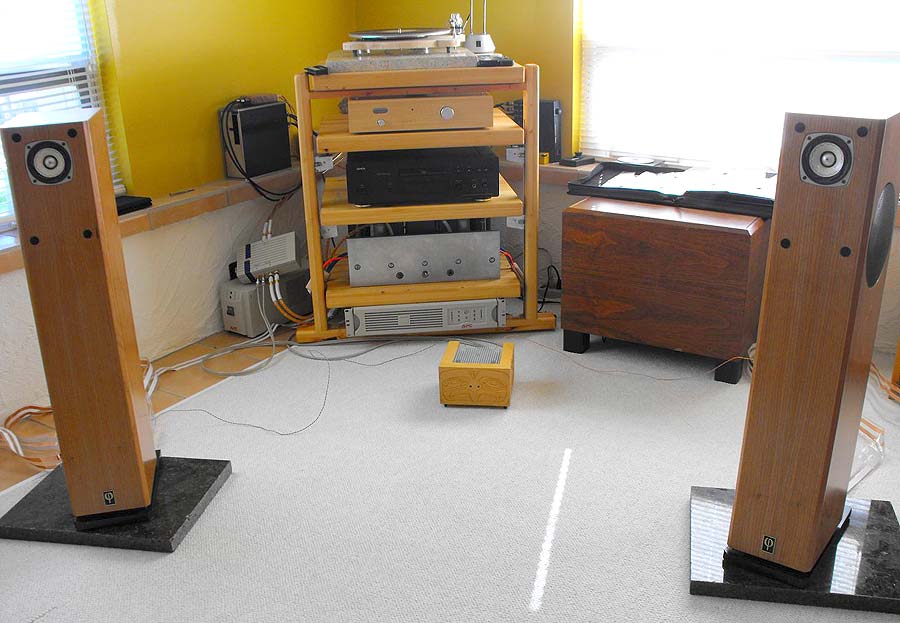

A post of this picture of Tysen elicited a large number of requests for more information. So in aid of saving me from answering individual questions multiple times, let;s see if we can cover it here.
Tysen (named after our godson in the picture) is a Fostex FF85K & a CSS SDX7 (in both cases my fully modified version).
I chose sealed for the SDX7 because it works well sealed and with a bit of EQ can reach into the 25-30 Hz range in room. Tysen is 17 litres, but anywhere 14-21 litres net (including effect of stuffing).
The FF85KeN is in an aperiodically damped 10:1 taper TL. I wanted to tune the TL as low as i could withing the limited space i had available, Damping starts out really light getting increasingly dense towards the terminus (i call this arrangement a midTL).
Because of the efficiency of the SDX7 is lower than needed for a passive XO, and because it is so much easier, the system is active (biamped).
Chris & i are very pleased with how these turned out, and everyone who has heard them has been favourably impressed. First public exposure was on the Sunday of last years' VI diyFEST.

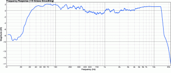

I borrowed DCX2496, set upo the old G3 Lombard PowerBook with measuring mic/Fuzzmeasure and played with all sorts of XO arrangements.
With the DCX the only one happy with the sound was the measuring mic, but i learned a lot about XOing the combo -- for instance, as pictured the woofer is upside down -- i got quite severe combing until i fliipped it do the woofer was close to the mid-tweeter.
Attached is one of the FR curves. The limits at the bottom may not be the speaker but the Lombard's analog input and the roll-off at the top is from too long a mic cable. Althou a bit saddle shaped it is +/- 2dB from <30 Hz out to beyond 15k. There is a small amount of lift set at 25 Hz.
In the end i choose a 1st order XO on the woofer & 2nd order Bessel on the midtweeter at about 350 Hz. The low order XO on the woofer helps fill in the baffle-step loss. In this case the natural rolloff of the SDX7 above 1k doesn't hurt either.

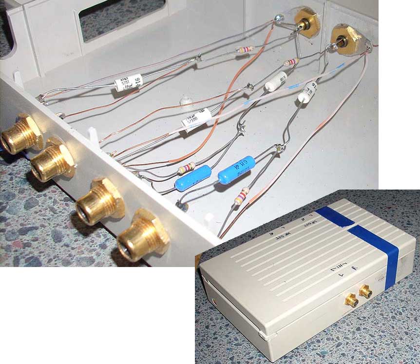

The PLLXO
The parts box yielded a PLLXO at ~ 333 Hz. 0,1, 0.01 uF caps and 10 & 100k Rs (IIRC). I built it into an old Macintosh 800k floppy disk case.
This would actually be best built into the amps.
I thot i'd done a map of the XO, but i've not been able to find it... i may only have sketched it on paper.

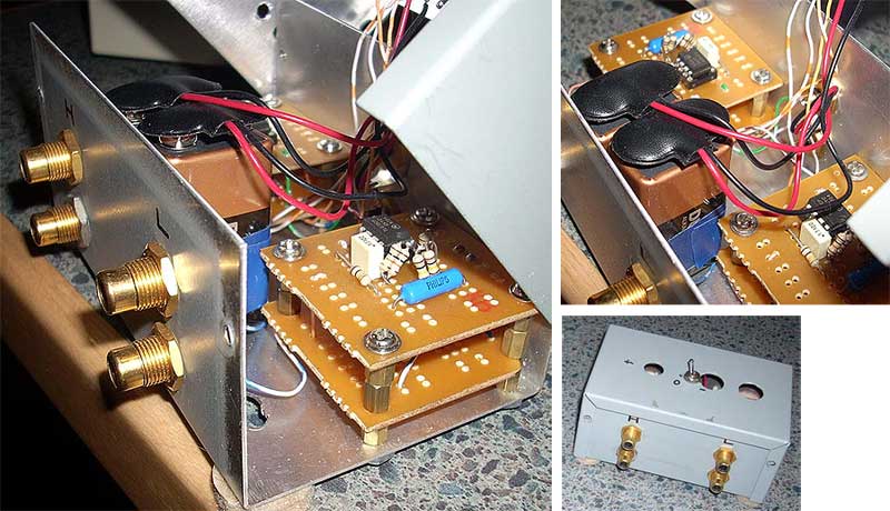

A buffered PLLXO
As set up the PLLXO requires an amp with a 100k input. In aid of more versatility we did a fully biffered version. We put an OpAmp buffer at the in and the out of each filter. We choose opamps so that we could just use 2 9V batteries as a supply. Daniel did a real tidy job, and performabce was pretty good. Not quite as transparent as the unbuffered one on a system that can hack the PLLXO impedance requirements, but better on systems that can't.
To use a PLLXO the HF amp really should have 50k+ impedance, and the preamp needs to be able to drive a 10k load, The 2nd order hipass is the most restrictive bit, the 1st order lowpass makes that work almost anywhere.
Depending on the amps & preamps used you can get probably away with fewer buffers.

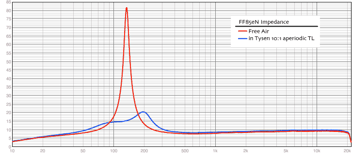

midTL
The goal of the midTL is to attempt to absorb as much of the backwave as possible and to flatten the impedance curve. As can be seen by the attached impedance curve, i have mostly achieved that. The red curve is the FF85KeN in free-air, the blue curve in the Tysen midTL. If you imagine the blue curve as a typical double humped vented box curve, you can see that the minima is at about the Fs of 130 Hz, and that the lower hump is almost completely gone, and we have only a small resisdual of the lower hump.
This also shows why a passive XO can be difficult, but certainly not as difficult as the free-air curve.
If i ever get those Tysen back i'll measure the woofer impedance (JesseG borrowed them, took them up to Alert Bay with the "threat" that i may never see them again :))
