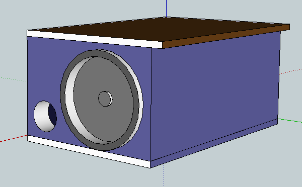

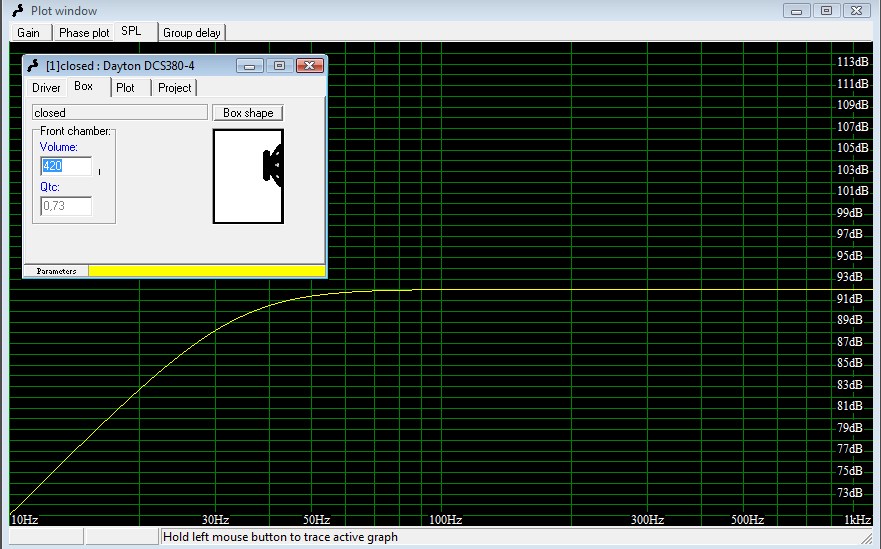

I'm joining in here too. I was just tempted to make use of a 450L cabinet and put two 15" woofers in it. Norman guided me to PPSL which principle I already knew. Here is my latest plan, drivers will be the very cheap Dayton DCS380-4 an two 220-230L closed boxes opposed to make a slot. Yes the system will be 220cm wide! (8ft)

Sealed 8ft3 (qtc .707) each for that driver making F3 = 32.4hz.
Should do fine.
It would be neat to do a shootout of sealed F3 = 30hz compared to a ported F3 = tuned = 27hz. I'd imagine one would sound cleaner and louder but the other would go deeper.

it's very difficult to make a connection between the two boxes because of the max. space available. Would a 100mm sewerpipe be enough?, I could put that in the lower corner in the slot behind elements. The backside corners should be covered/rounded anyway.
PP arrangement is easy here, only problem I see is that these drivers have a stamped steel frame that is not optimal. On the other hand it's easy to make a tight plenum.

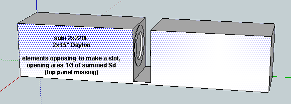

Is it wise to make the opening of plenum 1/3 of total Sd like Nelson Pass did for his ppsl dipole?

the narrower the plenum, the higher in frequency it works. Nelson got some boost with narrow slot.

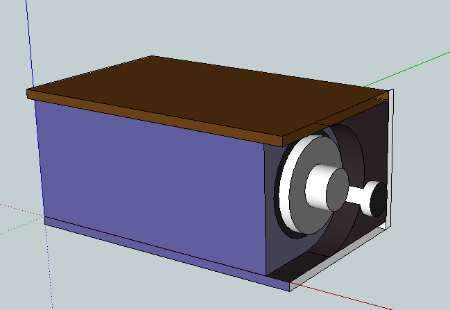

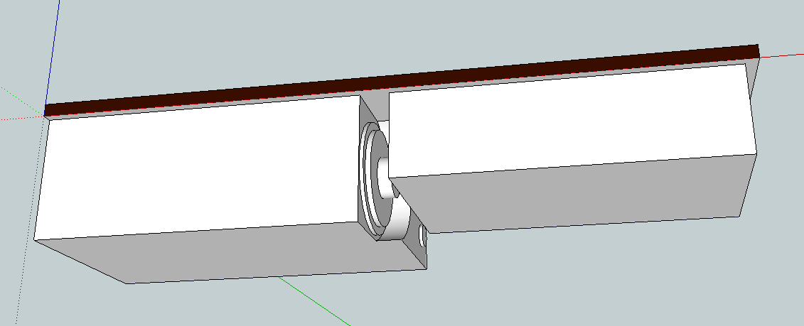

Google Sketches of boxes, to get the idea of making the ppsl plenum
Left side with the plenum filling, chamber-connecting tube and driver magnet out.
Right side with the driver magnet in

That looks like a good solution, the chamber-connecting tube need only carry the difference in pressure between the two boxes, should work fine.

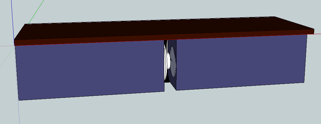

Here are a better sketches of the sub and my home theater room with a 100" screen in precise proportions. I just ordred the boards, but I'll get the drivers and amp only after Christmas. Photos will come later on and I can do nearfield and room measurements too.

A plenum, or slot, is the space between the two speakers.
The plenum does not increase efficiency like a large horn would, but does subjectively increase "punch" and "tightness", and allows for a smaller frontal area than if the speakers were front loaded, and is easier to build than a stepped baffle for push pull as is used with speakers requiring a higher crossover point.
