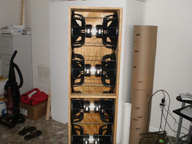

Here's how I did mine. The pic is BEFORE being installed in the Infinite baffle system.

I don't care for the face-to-face mounting at all. If anything, a magnet to magnet coupling to cancel forces. Below 80hz for sub use only. Those huge 21 inchers have too high an Fs to be considered subs (in my opinion).
Scott,
The 18 Sound 21" drivers have an Fs of 28 and 29 Hz, lower than the drivers elsewhere in this thread.
Sub means "below", the 35 Hz LF corner of the 18 Sound "Manifolded Double 21 Bandpass Subwoofer Kit" is well below most "full range" speakers.
As far as canceling vibration forces, face to face, magnet to magnet, or push pull (magnet to cone) are all equally effective. Your infinite baffle system could have reduced even order harmonic distortion had you used push- pull mounting.
18 Sound drivers have a fair amount of magnet structure heat vent noise when close to Xmax, magnet to magnet mounting would allow that noise to be heard, while the cabinet design with the cones both facing in to the manifold plenum dampens that noise.
Art Welter

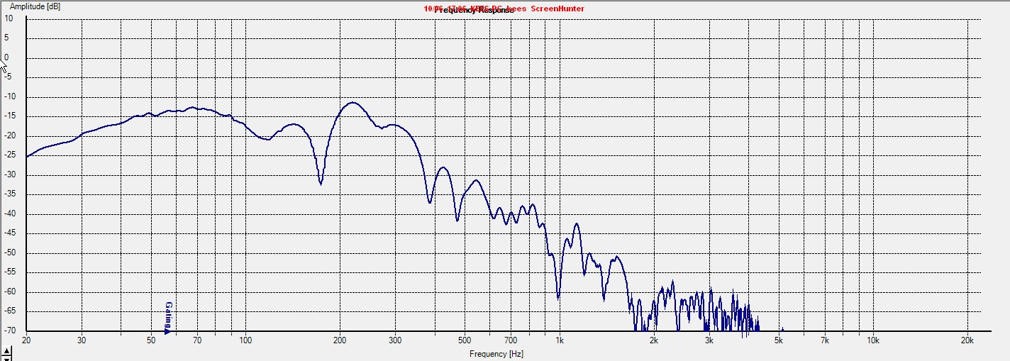

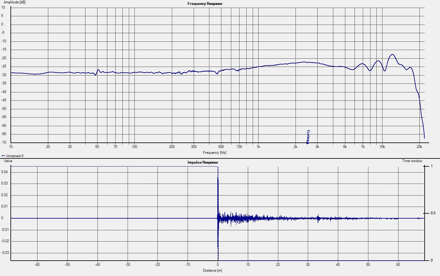

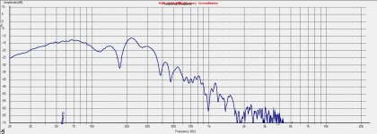

here I have a plot from my H frame, line level corrected, yes offtopic for a moment, but I want to make the PPSL so I stick here for a while, The slot has I also did read so small as the magnet conus of the driver kan be without touching each other, strange that two woofers are connected what does other normal boxes loose bass because of opposite fase, strange design and box who works with compression-decompression as I think I see, yes I am green behind the ears..

Hi Kees,
The plenum (cavity) makes it look more difficult than it actually is. You can even leave the plenum out if you want (see picture) but that lowers the functioning of the Push-Pull as frequency rises.
The trick behind PP(SL) is that drivers have different (electrical and mechanical) properties between moving forwards and backwards. By flipping around one driver you can eliminate part of these differences, that otherwise would lead to non-linear movement (distortion).
Edit: This picture is only Push-Pull and not Push-Pull Slot Loaded... ;-) Sorry for the title...
