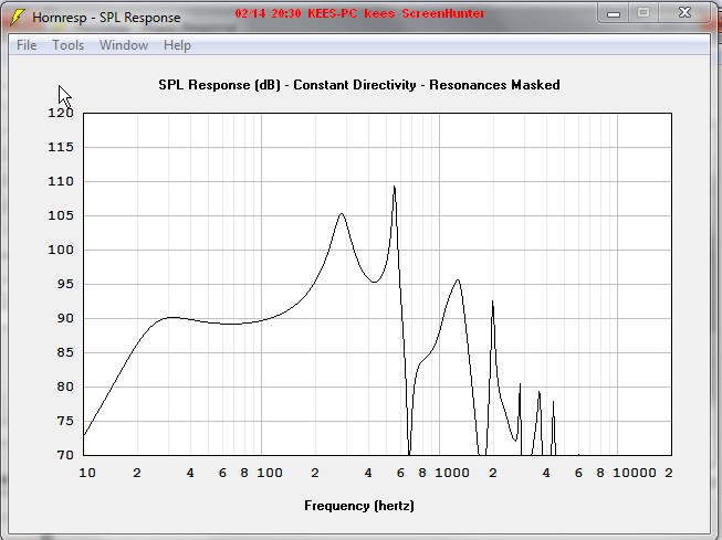

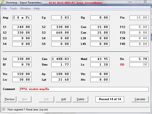

its diffecult to get this driver to play low.
250 lts tuned at 20 hz .not verry small😱
if you punch the numbers from in the input screen,you cam play with the wizzard yourself.
click on the pic left bottom x to enlarge pic.
Thanks , I had also that same idea, a normal vented box was already 200 plus liters. but if I halve the vas then it get smaller, like a isobaric way and go low, but that is not a ppsl anymore.
high Sd and smaller VAS will work oke here.
thanks for your attemt I go play. the output on hornresp is good, 250 liters is big but if one box used, the rest is ob then it is oke, it has
good output I see.

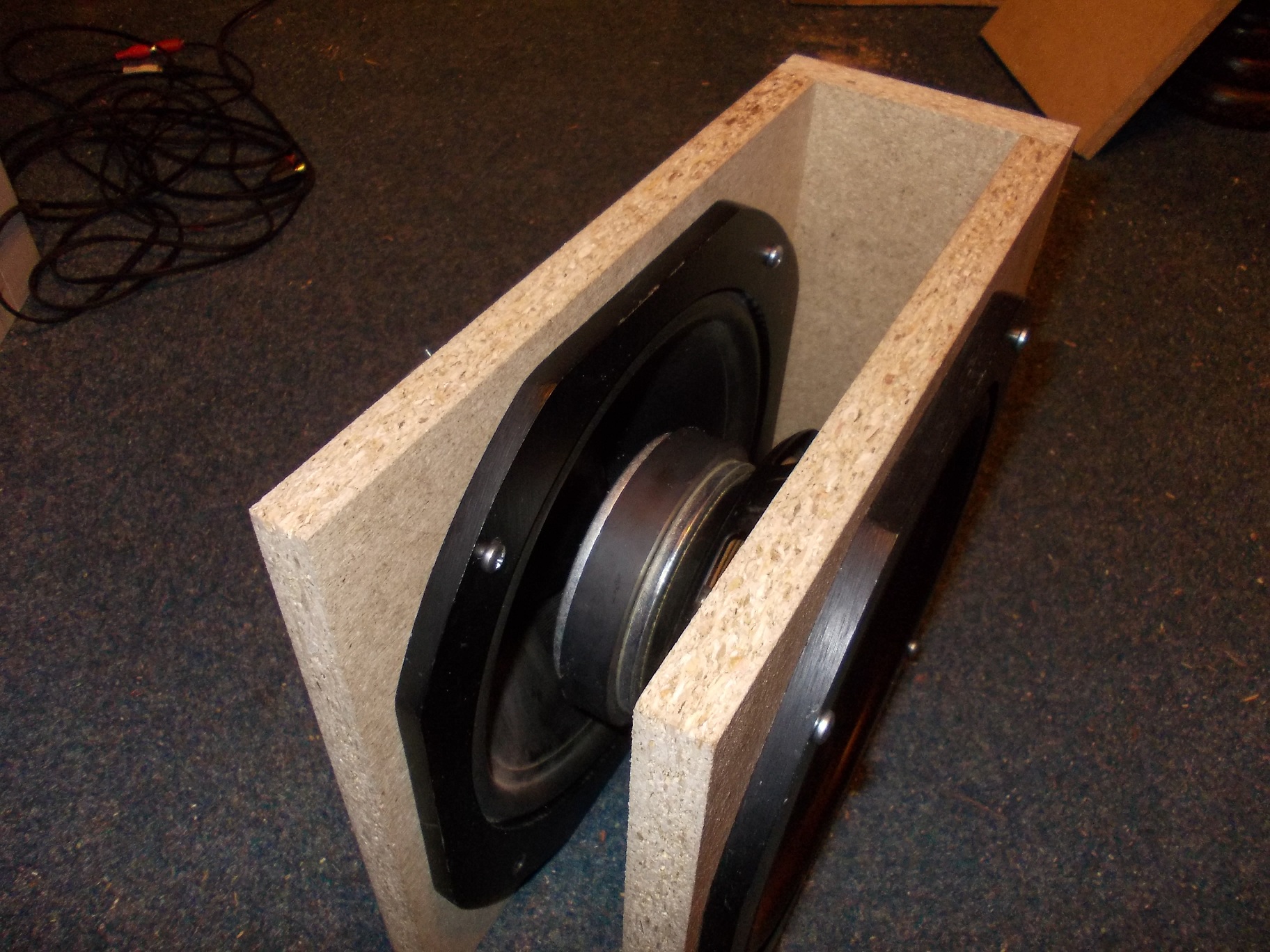

photo is the slot I did make for measuring.

Hi Epa
I have fill in the hornresp, I get lower spl, and I have change the VRC to 150 and get this,
not 20 hz without loss but 25 hz - 1 dB is there what is most of the time enough I think.
Afcourse if i did it the right way, your simulation is 95 dB?? did I something wrong.
the vrc is 150 I have lowered that after the test for as you see it and think this is the problem, maybe I have a old version of hornresp it is 21.30
thanks

How have I connect the speakers in a ppsl box, in fase or out fase. I have test the slot the woofers go from 19 hz to 29 hz in it, when as a ripole it go from 29 to 22 hz.
I measure with limp and use the output of the audio card I think I need a 10 watt amp for it to do good.
thanks
Ohh ahh I had a old version of hornresp 21.30 the new one is give other results but not wht epa has, so what is wrong, and how do i interpret hornresp in a PPSL box.
