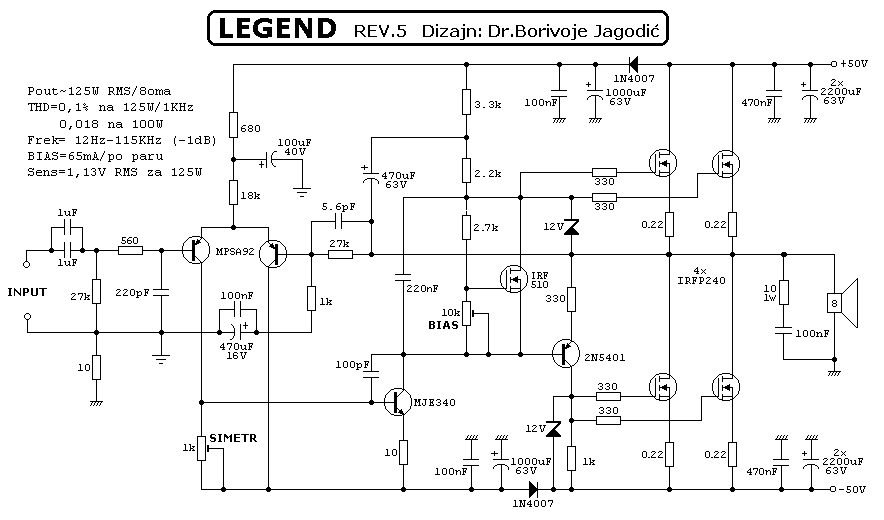

Anyone have a link to the Legend schematic?
I'm unable to navigate his site given the language barrier, might be nice to
have an index here to schematics, layout, etc. for each design.
The first Legend schematic...

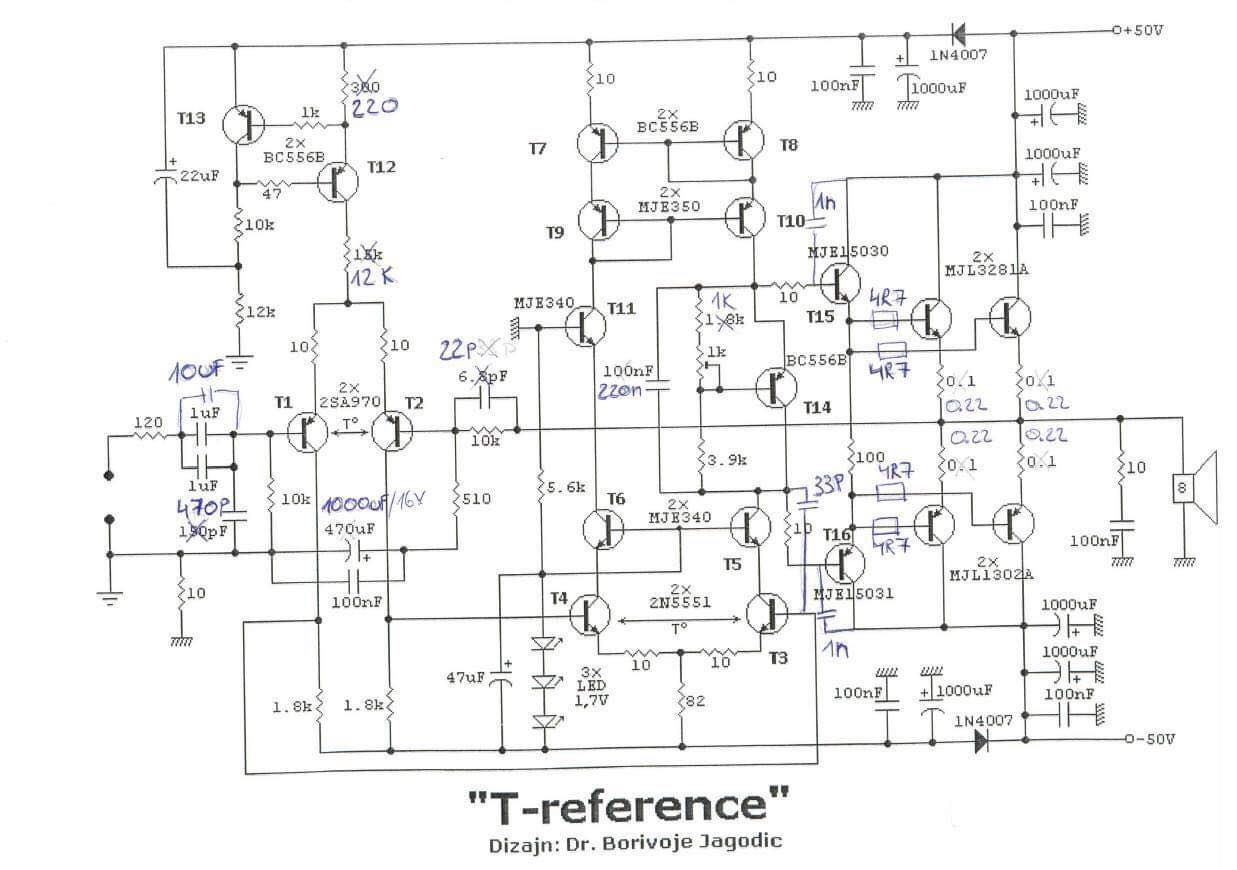

greetings has anyone tried late Dr Boras T Reference amplifier if anyone has made
it is it possible to share PCB design
warm regards
Andrew
warm regards
Andrew
T-REFERENCE - U Fazi Prototipa
