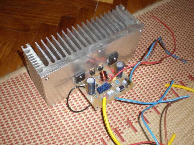

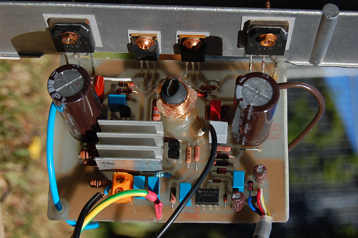

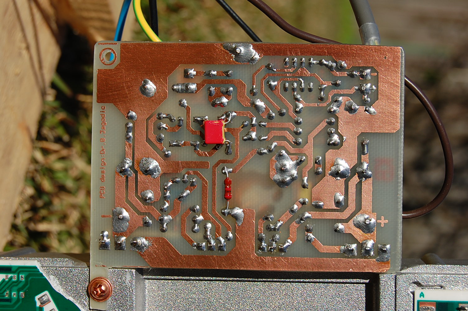

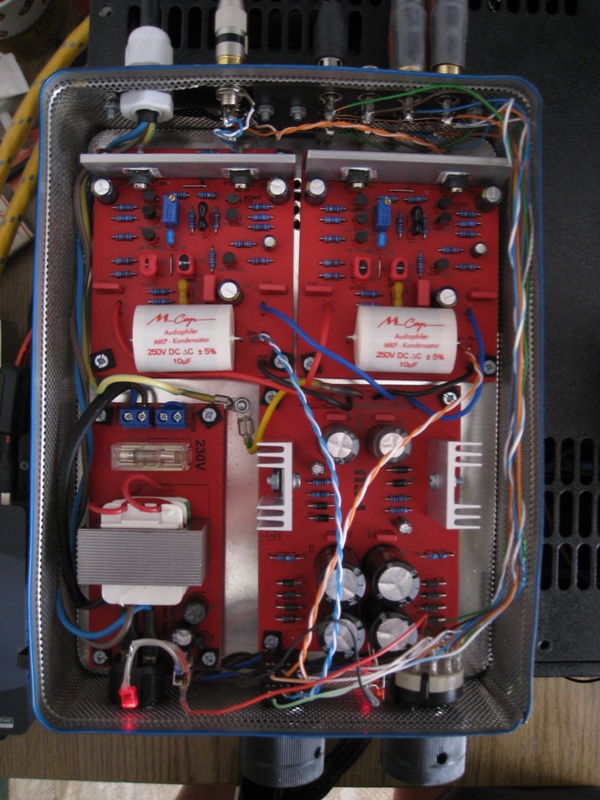

My DOGC-Mk3
Many thanks to Dr Bora, who share many of his amplifiers. I thought that I should try at least one: DOGC-Mk3.
The main reason for me to choose DOGC is Dr Bora's introduction to this amplifier:
"Amplifier is absolutely stabile in operation and will deliver extremely high quality of sound. It posses remarkable dynamic and transparency as well as excellent extension of frequency spectrum on both ends. Give it appropriate and capable PSU and sufficient heatsink and you will be amazed with what this amp can deliver, having on mind its simplicity and overall costs! You won't be ashamed to use it side by side with most brand name amps of similar power within 1000-1500US$ price class."
First at all, the amp is very easy to build & there is no adjustment. I bought all my parts (excluding the PSU & BJT ouput transistors) from Farnell and it cost me less than $20.
I have to agree with every word in Dr Bora's comments quoted above - the amp sounds great & smooth - it adds air to the music. I don't have the audiophile's vocab & that is the best that I can describe the sound.
It does require a robust PSU, the DOGC sounds quite thin with a PSU with 4x8200uF filter caps and swapping to a PSU with 8x8200uF filter caps transform the amp into a great-sounding amp.
It does require a generous heatsink - my heatsink is a bit small & it is about 55C at idle. The temperature does not go up much for normal listening as the driver bias is set at 330mA.
Attached is some pictures.

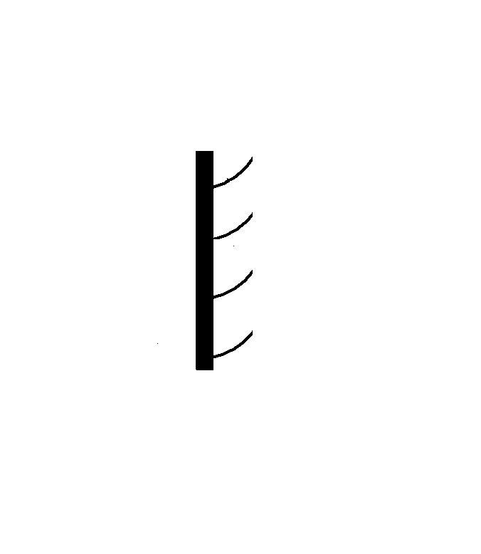

your heatsink may be OK.my heatsink is a bit small & it is about 55C at idle.
The way you have mounted your devices on the heatsink is causing the hot running.
The way you have oriented the heatsink is making the hot running even worse.
Don't blame the sink. It's the builder that is not thinking.
No, builder is probably thinking, otherwise he won’t produce anything, but I have to agree with AndrewT about first two statements – the way of mounting and orientation of fins.

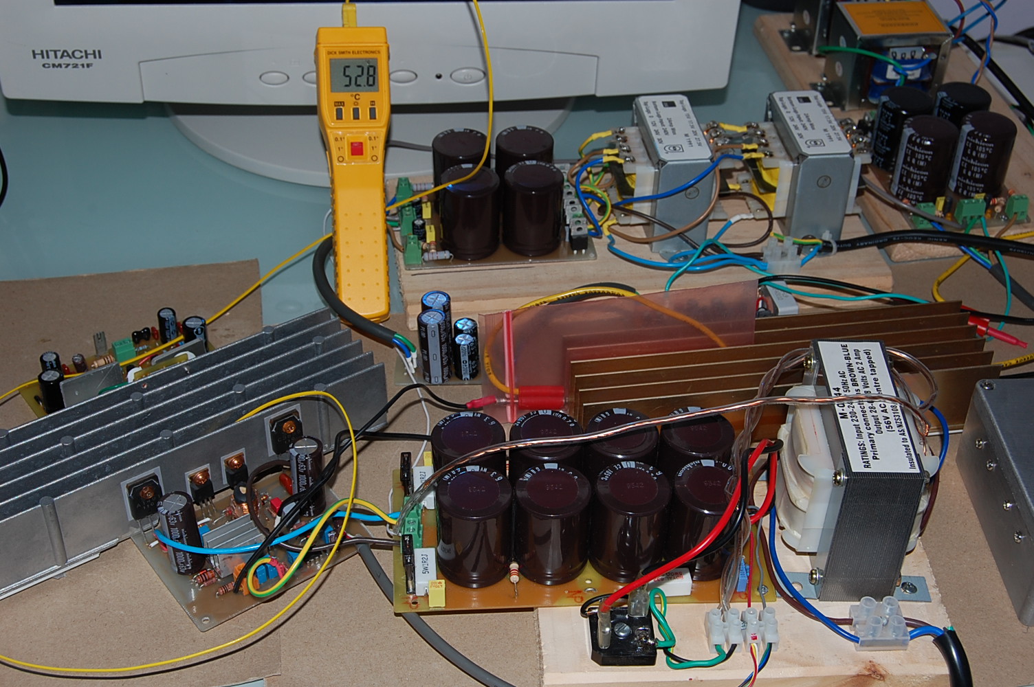

Here is about optimal (if not even oversized) heatsink used by Croatian builder “zikinho” for his version of DOGC MK3.
Main problem in this case is not heat sink orientation, but the way devices are mounted
The shown paper on heatsink orientation doesnt suggest to mount devices on one of the cooling finns
Mounting base is there fore a reason
If devices fore any practical reason have to be mounted on finning that way, it would be much much better with fins facing down, and mounting base up
But there should be a free airflow below, and on heatsink ends
and on top of box, to have an active airflow
Thats important
But you wont find that in the books

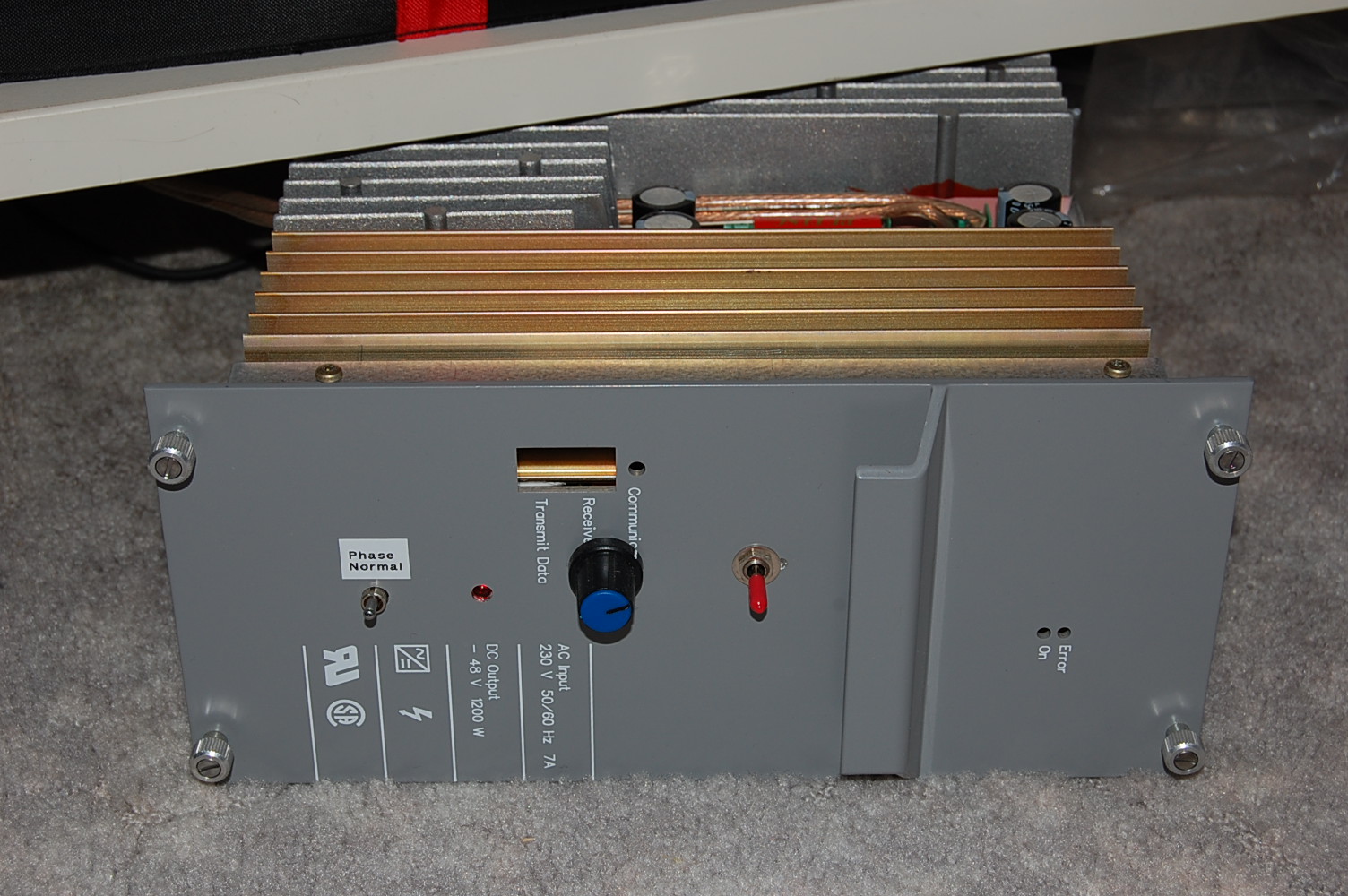

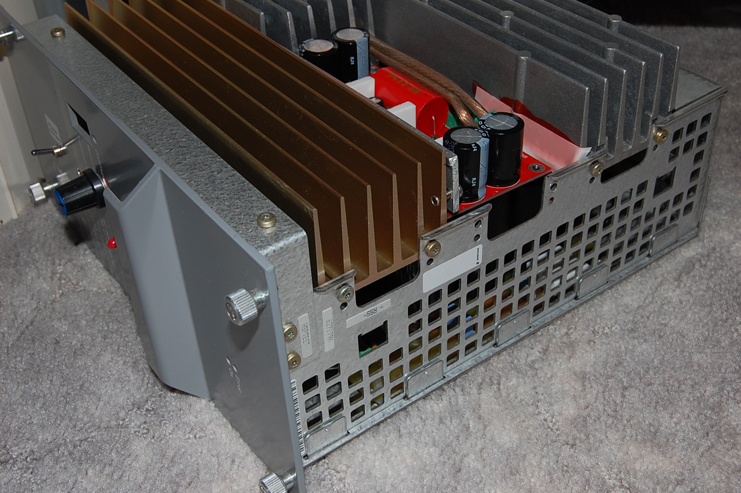

Heatsink orientation
I agree that the mounting of the output devices are not optimal but there are other contraints - like the shape & size of the mountable surfaces.
First at all, I did not pay for the heatsink, they are recycled parts from a computer power supply. I have nine of these heatsinks so they are perfect for prototyping.
The base of the heatsink is not flat so I could not mount the output devices there.
If the amplfilier is good enough to be cased, the original computer power supply case can also serve as a good monoblock case.
I have attached pictures of my first DIY project - a LM3886 kit from eBay with DIY PSU board - it shows the look of the monoblock amplifier.
Cheers, Stanley

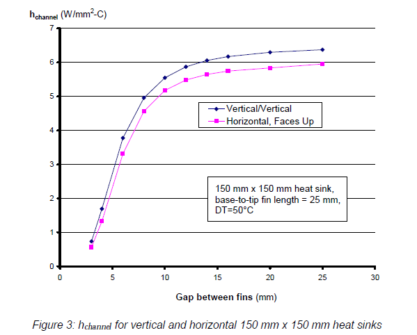

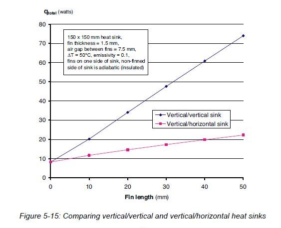

May I suggest fan cooling if you need it to run cooler? You don't need a lot of airflow to make a huge difference.
Wrong graph. That is for horizontal fins and vertical baseplate, the orientation that is indeed a bad performer. Here is the graph for vertical fins/horizontal baseplate, like shown in the picture:
If this is "not by much", then what is...
Cheers, Stanley

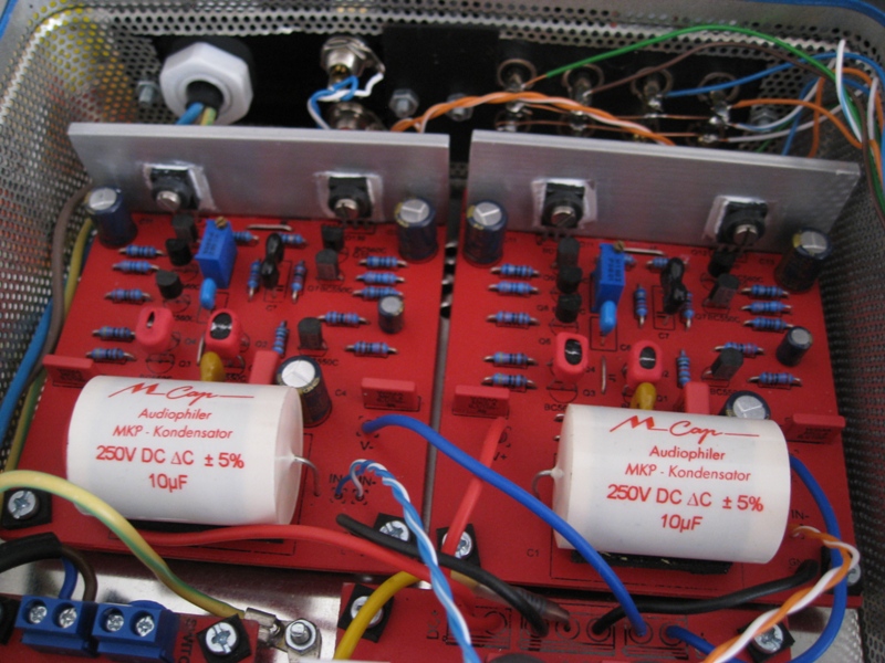

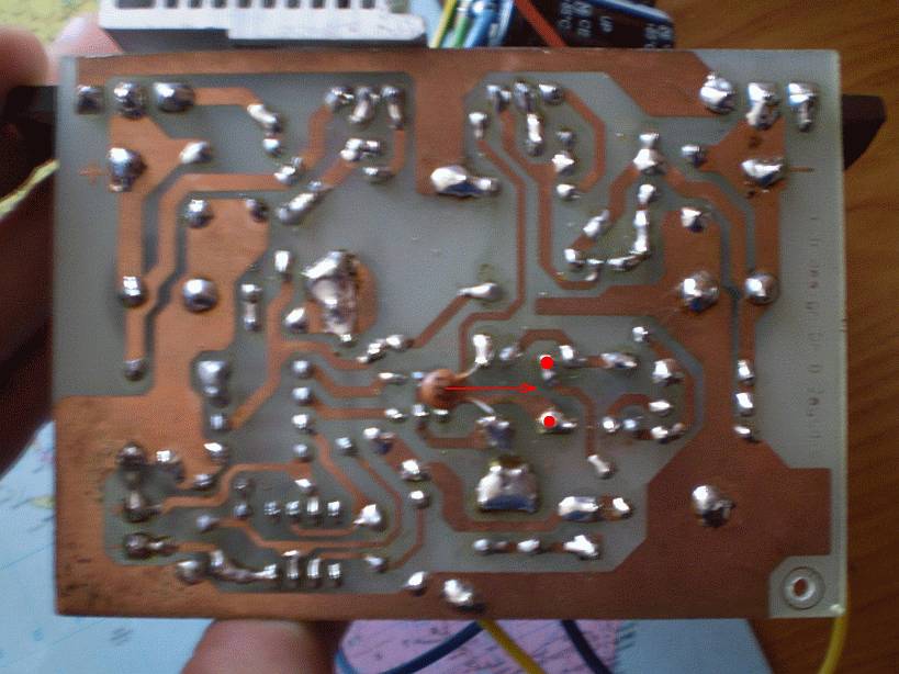

Hi, have you missplaced the 220pF?
Check this image, red dots mark the right position.
Thanks zikinho,
You have got sharp eye, I have re-solder the 220pF capacitor. BTW, your amplifiers look nice.
Cheers, Stanley
Cheers, Stanley

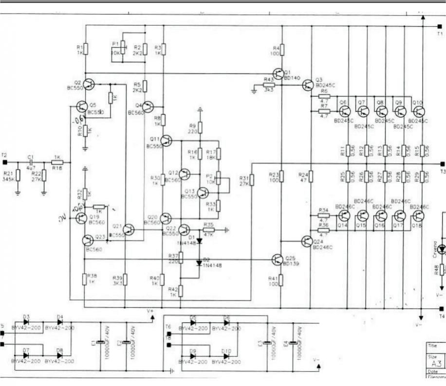

I see a Rush front end in here, keantoken might like to take a peak at this...
http://bas.elitesecurity.org/OME79AB-sema.gif
Keen likes rush's 😀 Below is a the "big rush" Oh , and BTW , thanks.. Dr. bora your designs inspire. 😎
