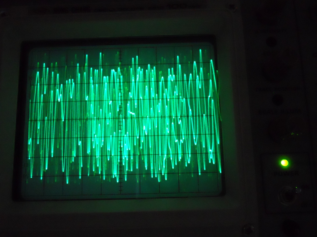

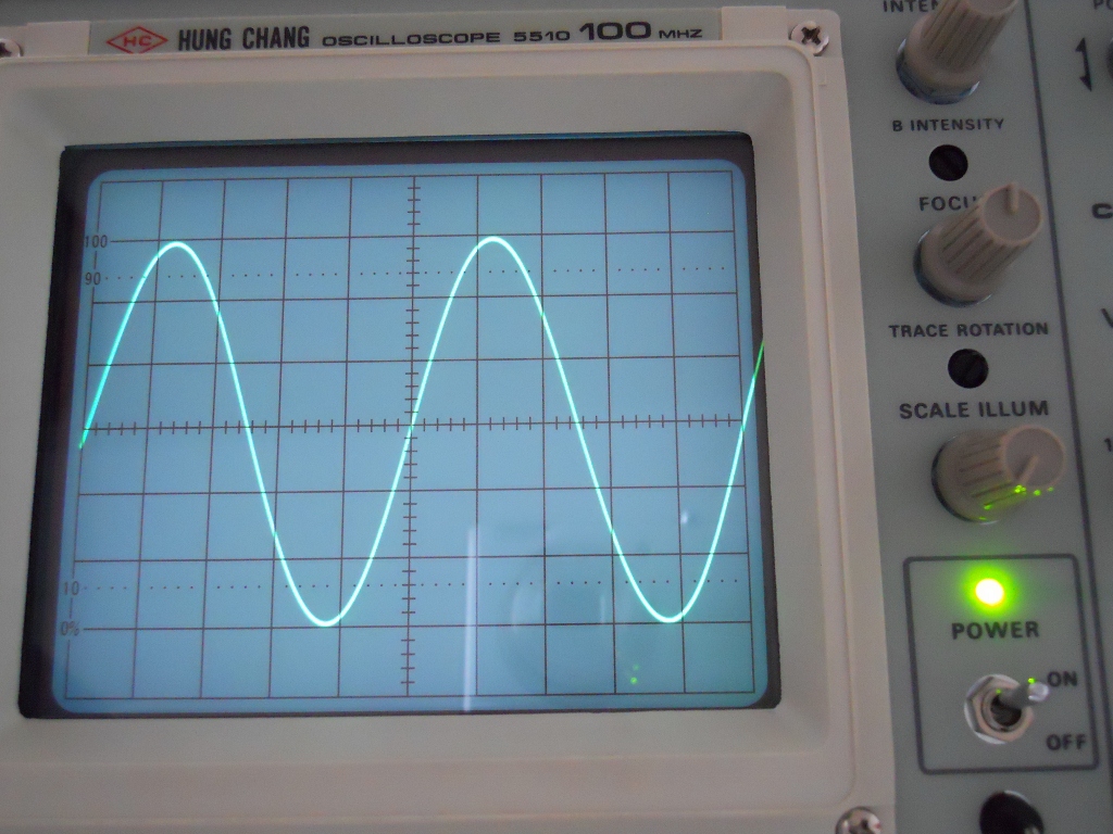

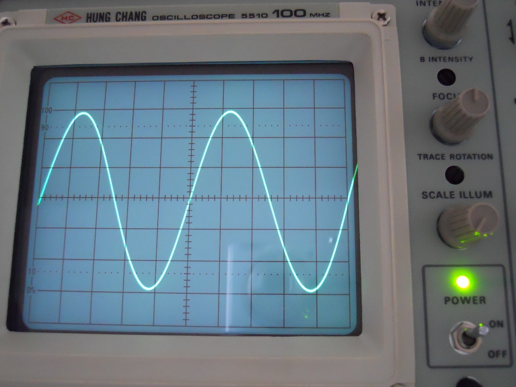

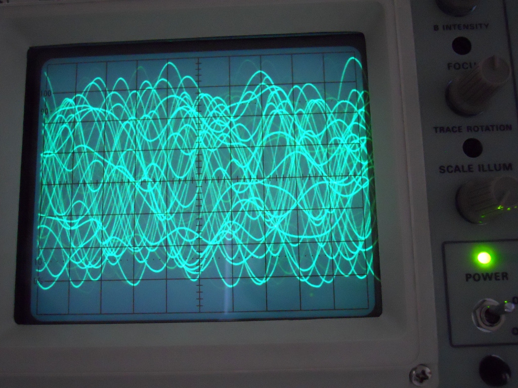

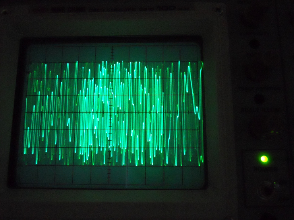

A level Anomaly... can anyone explain please
Can anyone offer an explanation for this.
Two players. A Micromega (TDA1035 DAC) and a Philips CD150 (TDA1540 DAC's).
Two manufacturers test discs. A Philips and a Denon. Both have test tones at 0db.
I play the 0db test tones and measure 6 volts peak to peak give or take a few millivolts at the line output of each player. The scope trace was also absolutely centered correctly.
I then played the 0db track of white noise.
The Micromega peaks at exactly 6 volts pk/pk the same as the 0db sine wave.
The Philips "plays" it differently. Peak to peak I estimate as around 7.4 volts.
I also mentioned the scope trace being centered... the Micromega is "symetrical" above and below the zero point when averaged by eye (and in the pic) but the Philips takes on a "shift" in the positive peaks seem predominant.
The last shot shows the Philips playing white noise, this time with the trace deliberately offset a fraction to help me gauge the amplitude.
Any thoughts on this one 🙂

Hi Mooly
Try this same test but lower the level say 6dB more. See if the difference is still present or are they both the same then.
Transfer the file to a computer and open it with some thing like Cool edit that can analyze the data in the digital form or try the orban VU meter and see what it says.
Not sure about white noise, the kind used for testing in RF had more like a 10dB peak to average ratio. If any of your circuitry were limiting, you may see a different peak to average ratio when the average level is lowered.
The Philips disc has a -12 db white noise track but when I tried that yesterday that too gives over the expected level... and that was on yet another player. I didn't try the Micromega though... tomorrow maybe 🙂
There the only these two white noise tracks
There does look to be quite a difference in peak to average between these two actually. The Denon track is much more uniform.
Although that doesn't explain the 0db absolute maximum apparently being violated.
As I alluded in my previous post I thought it was phase related.
I did some quick comparisons between unfiltered white noise and one with a steep -15dB PEQ cut at 20kHz with a bandwidth of 0.110 oct. simulating a brick wall filter.
The peaks does become a lot higher with the PEQ in place.
Same when using Hilbert transform.
White noise has such a lot narrow spikes and high energy at high frequency so a phase shift causes them to stack on top of each other providing a greater signal amplitude then an unfiltered signal.
Very simple to play around with in Audacity.
Mooly it is entirely possible that the extra you're seeing could be high frequency hash as produced by the DAC. Granted that's a lot of ultrasonic noise but it has to come from somewhere.

I looked up the Hilbert transform... the maths is way over my head though 🙂 I wouldn't like to say one way or the other on this. Whether it is or not though...
My simple reaction to this was that white noise on CD is still a valid test signal.
(this is opening a whole new can of worms...) When you can start to see differences on a scope between two signals then surely something very audibly different between the two players must be occuring.
Just think about that in a different way. I could swap the opamps in any CD player for 741's and scope the output using say the 1khz squarewave test track and I bet you wouldn't pick out any observable difference between the 741 and whatever audiophile opamp was fitted. That's something I have tried in the past. Is there an audible difference though on music ? We all know the answer to that one.
So what about music with lots of high level hf ? We can't see that on a normal scope, not in such a way that differences could be observed because we can't isolate and view the same music sample over and over and compare easily. Whatever is happening here on the very "dynamic" (as in lots going on) white noise test is revealing massive differences in the way the data is decoded and outputed in analogue form.
It is physically impossible (Mooly's odd test results notwithstanding) to send a signal greater then 0dB through the system. So if you never move the volume higher then the position you did the above test at, then it is physically impossible for the output of the amplifier to clip due to voltage limitations as you've already proven that a 0dB signal wont clip your amplifier.
That much HF would be a scary thought...
In practice the real world result shows signals considerably over 0db. If there were HF present then that surely has implications for all circuitry handling that signal. We talk of "inaudible" HF interacting with frequencies lower down the band.
Wait a second, what happens if you play a 20khz signal through them both? A 6>7.4 volt difference = less then 1dB. It's quite possible that one player has a slightly peaky top end.

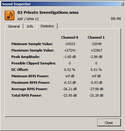

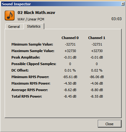

I didn't have time to listen to a variety so I chose one which I knew had quite high dynamic range. Interestingly If I had have gone with my first choice I would have had a higher voltage value. not because the dynamic range was higher, but because that track had lower overall peak (and average) levels.

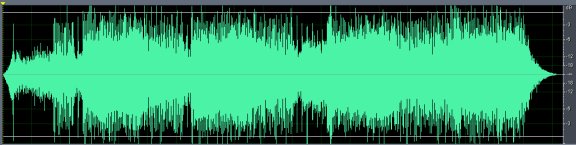

I downloaded an interesting program called ocenadio (a music editor) which does an analysis of the track and shows peak values and averages. I'm not 100% sure I've interpreted it properly but it seems to give a good indication of the dynamic range of the track. I think it is worth checking tracks to see if they are close to 0db on the peaks, because if you set the absolute loudest level on a track that the peaks are -4db then I think it is going to give an unrealistic high value when the test tone is played 🙂
I loaded up a whitestripes track that I really find sounds terrible on my current system and discovered it only had about 4db average to peak difference, which makes me think that is part of the problem.

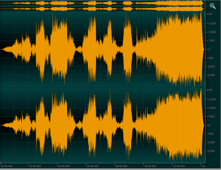

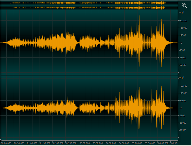

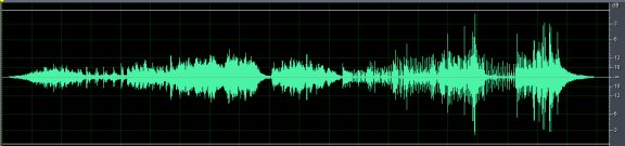

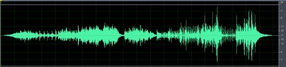

I've made two screenshots in Cooledit Pro of two different tracks with
quite a different dynamic range throughout the songs.
Track number one is 'Private Investigations' by the Dire Straits,
track number two is 'The Unforgiven' by Metallica.
Track number two was taken from a cd purchased in 1991 so i'm
pretty sure this was before Metallica REALLY started to compress the heck
out of their music 😀
If you set your volume-control to 'very loud' during the first half of the first track and don't turn down the volumecontrol in time, you might be in for a nasty surprise going towards the end of the track, if your equipment doesn't have the dynamic capabilities to reproduce the large peaks going towards the end.
If you set your volume-control to 'very loud' after the first snare-drum hit on the second track, you're basically safe throughout the rest of the track.

Private investigations was my first choice! 🙂 But I changed to Telegraph Road, which I had to turn down a couple of times during the track to be comfortable. It was those turned down levels that I used as my final setting! what I noticed was that overall Private Investigations peak levels were not at 0db but Telegraph road's were.
I have to shut down this laptop and plug my main computer back in. the white stripes track has large sections that are just flat across the top 😱

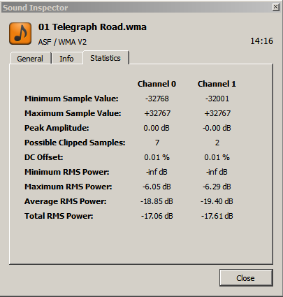

Here is why I chose in the end to use telegraph road for my test, rather than Private Investigations. Note the minimum and maximum sample values and then compare to telegraph road. Fairly obviously private investigations can have the amp volume cranked more (which I usually do!!) than telegraph road because overall levels on the track are lower.
lastly I've upload the analysis and waveform from Black Math of my White Stripes Elephant CD. I'm now less inclined to work out what it is about my system that makes this sound bad. What does interest me is what it is about hearing it in the car on the radio that makes it not sound bad... perhaps I just got a crap CD....
Tony.
