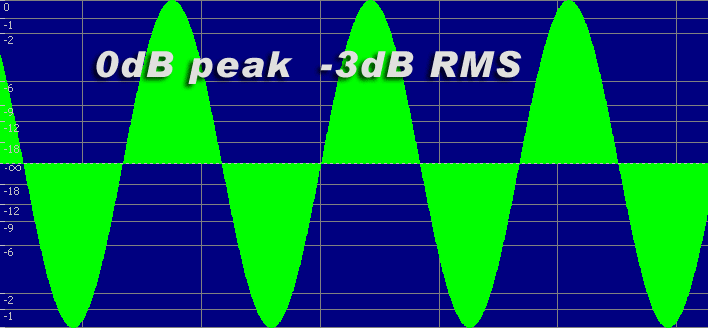

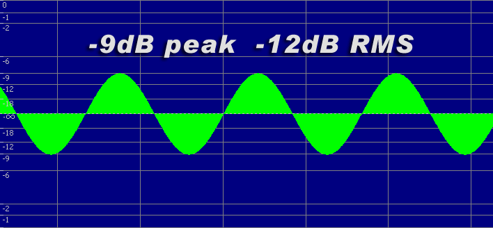

I noticed that on your screen shots. Why is that happening? Did you measure at the CD output, or at the speaker terminals? When I scoped, I saw almost all peaks at 4V, max. But one track I saw 1 or 2 peaks at 6V. Kick back from the speaker? I don't know.

Sorry Andrew, that quote above means nothing in a digital recording. 0dBFS is as high as the signal can go. Everything else is below that.
However I do agree that if you use a pink noise signal with an average to peak ratio of 6dB, then your peaks will be twice the voltage of the average. That means 4X the power. I don't see any problem with that. If the pink noise had an average to peak ratio of 12dB, then peaks would be 4 time the average voltage, or 8X the power. Pretty much what I've been saying all along.
Why is my use of -12dB and -9dB at odds with your understanding? Don't you understand the difference between Full Scale and RMS values? Certainly you do. Did you see the waveforms I posted above?
OK, thinking about it a bit more, I can see where the confusion might come from. If a CD has a tone at "0dB" then one would suppose that the peaks are at 0dB full scale.
If you measure that tone with a volt meter, you would see 3dB less than peak value, because the meter reads the RMS value, not peak. A 0dB peak sine has an RMS value of -3dB.
My test tones have an RMS value of -12dBFS That means 12dB below full scale. That will put them 9dB (RMS) below a "0dB" sine wave.
262847d1327763064-test-how-much-voltage-power-do-your-speakers-need-minus-12-wave.png
I have tried to make that abundantly clear throughout the thread, but it looks like I failed. "What we have here, is failure to communicate."

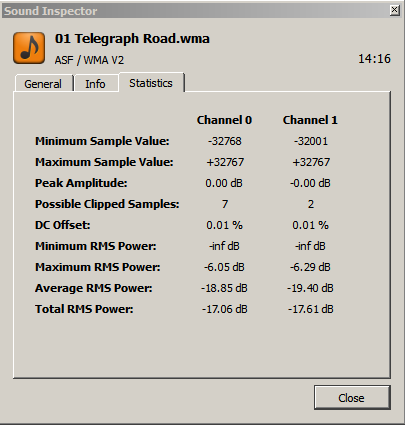

OK I've done the test. I'd never normally listen this loud, but it is conceivable for a party (I used to play much louder at parties in my youth).
Measured voltage on the 120hz test tone was 4.0V
test track was Telegraph Road from Love over gold which has about 12db range from average to peak if I understand the output of ocenaudio.
Speakers are probably around the 87-88db 2.38V 1M mark. They are nominally 4 ohms.
Listening room is approx 9M X 5M and listening distance is about 3M.
Tony.
