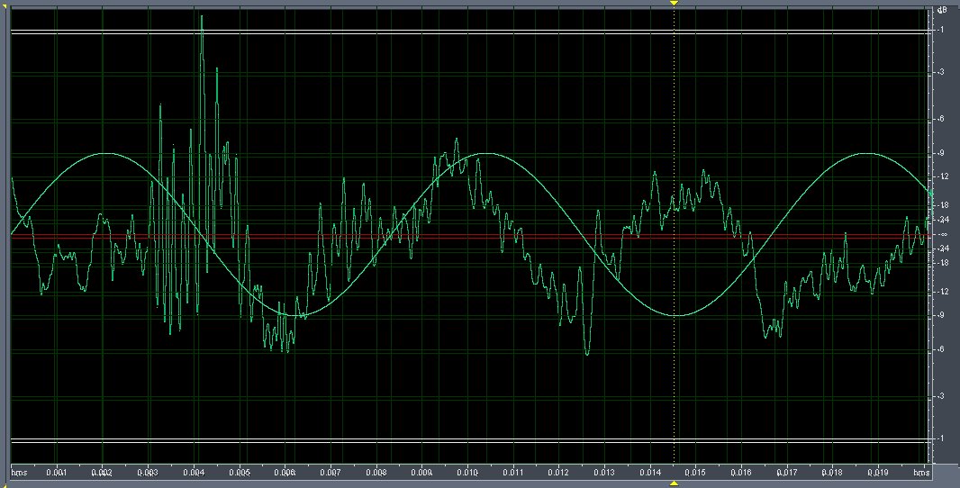

Pretty darn sure the huge peak(s) in the second shot were snaredrum-hits.
The second positive peak could be some ghosting-effect due to the
camera's shutter-time interacting with the fast changing picture.
The two shots were taken from ~20 'random' shots i took using the delayed shutter-option on my camera,
to avoid movement of the camera due to me operating it.
If you don't mind i took a different route trying to correlate with your test-tone.
My neighbours hate me already for obvious (noisy) reasons.
Since the scope was set at 2 ms/div when taking the pictures, i took a ~20ms sample of a snaredrum-hit in Cooledit,
and overlayed your test-tone.

Kvholio - excellent! Thanks for the screenshot and overlay. Looks just like I would expect, music down near the test tone and the snare hit up at 0dB. I.E., about 4X the voltage. I think it was higher on your actual scope shot, but can't be sure. I'll look at it in more detail this weekend.

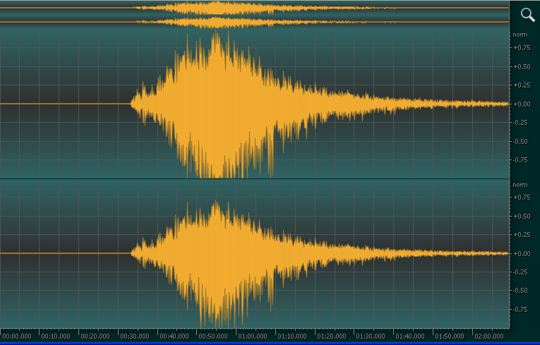

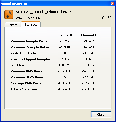

With cool edit, one can examine any part of a music track and read the statistics.
In looking through what I had in my computer, I found a few tracks that make good examples.
One of my daughters the delicate romp called Velvet revolver is a good place to start, track one. Examining the center chunk of the song, one finds a fairly hard core volume war recording.
The Average level is -8.3 below 0dB (the peak level) while the lowest level reached was-34.5dB
So, this track could be played a little louder than the 85dB IF one had the 50W amplifier but would be limited by instantaneous clipping to a level -2.3dB below 85dB with a 20 amplifier.

Take an extremely dynamic commercial recording like ozone percussion group’s jazz variations.
It’s average level is -21dB down from the peak (and has 53 and 49 clipped samples).
The maximum average level for this is about 70dB or about -15 dB down from reference..
If you down load the Harley recording from our web site at work, one finds the average level is -27dB from the peak at 0 dB and the lowest level is -89dB
The dynamic requirements of this mean the 20 Watt amp the maximum level before clipping is 64dB, a whopping -21dB quieter than with the low dynamic range noise test signal
An extreme case to be sure but the fireworks recording also on the web site may be the hardest one of all to produce without clipping. That is very difficult both because of the low frequency extension and no compression.
The average level is -41dB down from 0dB and so with the 20W amp, the maximum average level is 50dB SPL max while the minimum level is about -92dB.

Pretty close. According to both Goldwave and Ocenaudio, it's about -16dB if you don't count the almost silent part before lift-off. See the numbers below.Tom Danley said:For this recording, the peak to average is about 20dB
We can also see that the loudest part is pretty badly clipped on the left channel. (See analysis and waveform below.) With some simple and free software we can analyze the recording. Recording a shuttle launch is hard, NASA won't give you a sound check. 😀
