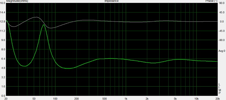

here's the impedance of my (now almost vintage) Dynaudios. they're obviously equalized but they don't do them like that anymore. now they're renowned for being hard to drive.
but to get back to the subject, what we're actually measuring in this thread is more like SPL level derived from power dissipated on the speaker.
since I have a class D amplifier and an impedance-equalized speaker I'm pretty close to ideal (that is: power requirement is closer to the one calculated based on measured voltage and nominal speaker impedance) but that's not true for everyone obviously. for instance, it'd be interesting if back told us what speakers and amplifier he's using.
I don't have a huge amount of data to back this up of course, but here's a Dynaudio speaker from 2009 and that still shows impedance equalisation. I suppose if they've changed designer in the last couple of years then they could have done away with that, a shame imo. Almost all the reviews that I've seen of Dyn loudspeakers over the years, that come with measurements, show at least some attention to keeping things easy to drive.

I am not saying that loudspeakers are intentionally designed to be hard to drive, just that designers tend to gloss over the difficulty of drive issue assuming people will be happy buying a bigger amplifier.

well it's weird with Dynaudio, they don't seem to follow a specific approach.I don't have a huge amount of data to back this up of course, but here's a Dynaudio speaker from 2009 and that still shows impedance equalisation. I suppose if they've changed designer in the last couple of years then they could have done away with that, a shame imo. Almost all the reviews that I've seen of Dyn loudspeakers over the years, that come with measurements, show at least some attention to keeping things easy to drive.
with the Confidence C1's (not mine, the new series) it's much worse, the impedance wanders from 4 to 10 ohms from 100 to 20kHz: Dynaudio Confidence C1 loudspeaker Measurements | Stereophile.com
Yes but you cannot just look at the impedance on its own, the impedance wandering from 4 to 10 ohms is nothing of real consequence and is 'easy' to drive by itself. The phase angle is also benign, so once again keeps the loudspeaker easy to drive. The small increase in the top octave isn't important to anything other then amplifiers with a higher output impedance and class D amplifiers with their output filters. I'd say that it's highly likely that Dynaudio could have used an impedance flattening network somewhere throughout the midrange too.
