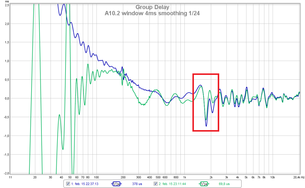

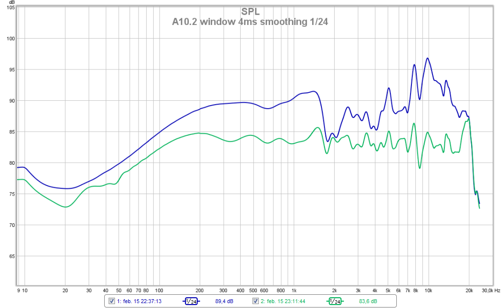

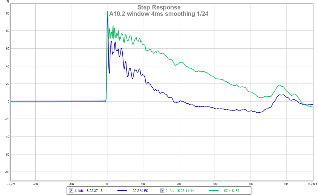

Show here my A10.2 low Q sealed box measured at half a meter with and without EQ. At nearfield listening the EQing sounds great and running squarewave sweep reveal some nice ones here and there in sweep when EQed. Impulse response is cleaned up and so is step response, but have a look group delay the driver wrap steep timing distortion at ~1,6kHz. The timing wrap is about 1ms and this is big compared 1,6kHz period is 0,625ms see tuning fork. Is it right to assume the best drivers will react to minimum phase EQ corrections and clean timing too when frequency response is corrected or they have flat response and flat timing as a minimum phase pass band device. I guess a instrument playing a note in the timing distortion area will have its original sound changed, example it was relaxed at the studio monitor where produced to now a forward note or whatever.
As sidenote the flat EQ doesn't sound good in room only on axis, but i actual use the flat EQ and add EQ smile at HF end to spread good sound into room, but now don't sit on axis its a real 4" cone that can beam hot 🙂.

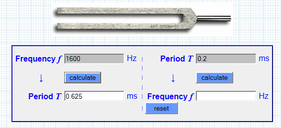

I've done the same type of experiment, but with a twist, the bottom is crossed to a sub at 300Hz.
Excessive EQ will cause phasing problems. I suggest that using that much EQ at the top so that the speaker can be used on-axis is excessive. As you suggest a better approach is to let the driver be hot on top and EQ it at the listening chair by the use of toe-in/out. The speaker will have a better sound stage and project into the room better.
I presume that the dip at 1.6k is an artifact of cone/surround reflections. Since it is a dip, I'd leave it alone. It is probably too narrow for our ears to pick up. We are much more sensitive to peaks than dips. In general, I make no effort to EQ dips unless they are very broad.

Bob Brines,
Agree some of the road and actual inspired by your posts the EQ smile and toe-in/out to get in room uniform percieved power response, thanks that.
I have since learned to compare equalized sound in the room with not equalized sound in headphones as a reference is a good tool tweak power response in room, and at the same time noticed when i hit best alignment going in an adjoining room with door open power response there is quite good balanced too but of course nothing is forward leaning there.
Intend to look more at the group delay in full rangers, my next up is a TC9FD test and build, because looping back even a very cheap soundcard in REW gives you a strait flat zero timing line inside audio band, not a single wriggle. Those group delay high Q wriggles i have this driver 1kHz and up is relative large timing changes compared the zero line and their frequency period time and speculate could this be some the drivers perceived signature. 1kHz and up group delay doesn't seem to change much even the frequency change a lot from non EQ to EQ, it could be the cone frequency dependant realease time do not react to minimum phase correction and this i will keep and eye at in future difference drivers between.
Byrtt,
+1 on not EQ the sharp dip - general rule of thumb is to cut peaks and not fill dips or valleys unless wide, if wide do it gently with low Q value. It would be useful to see the harmonic distortion with and without EQ. You will see a sharp rise in HD at the point the large dip filling EQ is applied. The EQ you applied to reduce the HF peaks which are the source of the ringing in the impulse looks like it really helped. Nice set of measurements though and thanks for sharing.

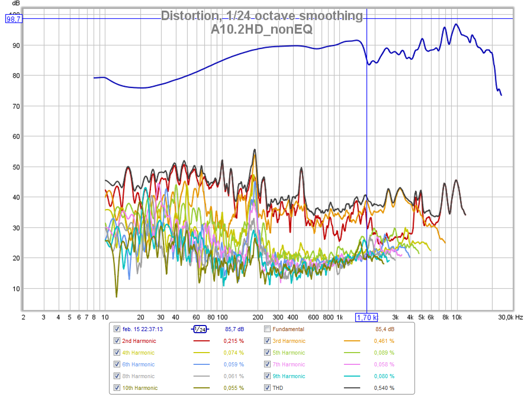

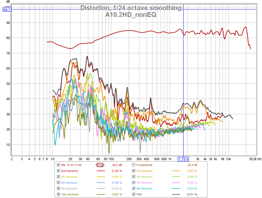

Thanks comment share HD this setup with cursor presented at same 1,7kHz point % values can then be compared, low end EQ to get deep bass from sealed box placed 1 meter from back wall adds quite some HD.

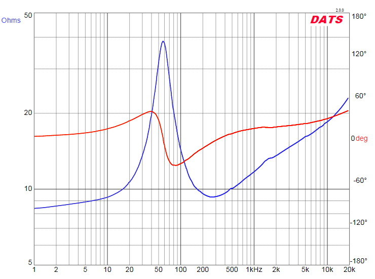

Impedance curve driver in operated sealed box but measured at opposite end of 4 meter solid core 0,5mm adds around 0,4 ohm per core raising RE and give tendency more soft spikes, 1,6kHz is seen there, and a Z linearizing network is lifted to show driver/box cooperation.

I find it hard to visualize HD in REW because the distortion traces are not normalized. You have to click on a point of interest to get the % value. It seems that the HD goes down in the EQ'd version, but I am not sure. It is interesting that 3rd order predominates in the upper mid.
