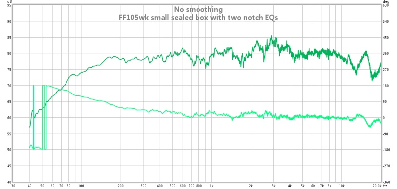

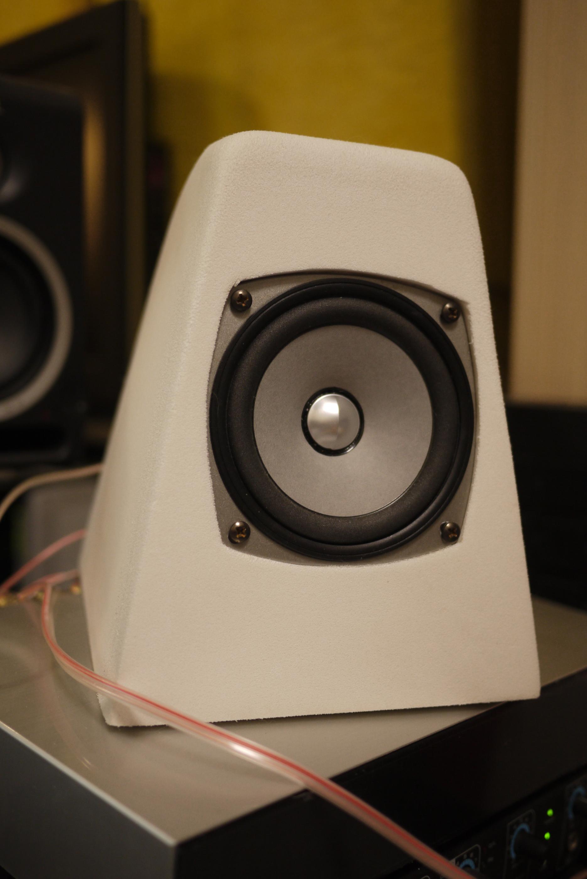

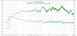

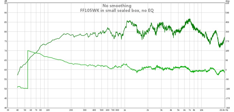

thanks xrk, yes I am a semi-professional artist/producer/mixer/sound-designer (like apprentice level).
With the FF105WK I sometimes use with the minidsp/eq and sometimes with just a simple lepai amp (no eq). Using the minidsp with the satori/rs28f now so mostly just living with it (eq-ing in my brain). In my sealed box I mostly have two peaks to deal with : one 6797hz -5.9db q3.4 and 1161hz -5.6db q4.1. After EQ the FF105WK is quite brilliant. I might do a FAST with it someday, but for now I want to keep it like an "auratone" style box.
The attached graphs are without smoothing, 15cm distance, slight off-axis (~5deg, how I listen) with a calibrated ECM8000 mic. As you can see from the no-eq graph, my peaks are much more controlled and not that annoying (easy to live with).
Box built with EVA foam. Someday I really want to write a post about using EVA foam for speaker building.

That doesn't look so bad at all. So you like building speakers out of foam? Have I got a thread for you!
http://www.diyaudio.com/forums/full-range/223313-foam-core-board-speaker-enclosures.html
Never used EVA foam as wall material but have used foam core and XPS foam insulation.

Yes I know that thread 😀 it is the reason/motivation I started with the EVA foam. So very big thank you for your inspiration and nice to meet you finally.
EVA is pretty awesome stuff, it is used for soundproofing so it has natural damping and low resonance, it is flexible so it is easy to make curves, and it can be wet-sanded so easy make very smooth finishing. On my satori speaker I laminate sheets to give me 20mm and 30mm thick panels.

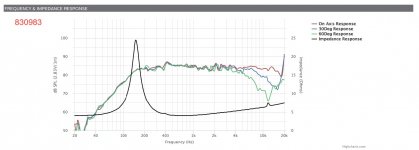

I would love to see both the TC9FD and TG9FD included in the next test.
I would also love to see the 830983 (2"), FF85wk and NE65 included especially since your plan is to cross over at 350hz. One isn't required to use 3-4" drivers if the FAST cross over is that high.
830983 Transducer Detail | Tymphany
NE65 Transducer Detail | Tymphany
xrk, subjectively do you like the 10f/8424 more than the tc9 and tg9?
I am in the process of putting an order together. Shipping to Japan is very expensive (starts at $60) so I tend to do one big order (over $200 so $260 with shipping) and work with the drivers for a year. Local dealers charge almost double for drivers here, so it is still cheaper to buy from europe-audio with the expensive shipping than buy locally. Of course fostex drivers are cheap here since they are made in Japan.
If I buy the tc9, tg9, 830986 and 830983 it is about the same cost as the 10f/8424.

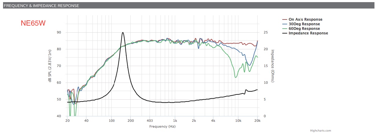

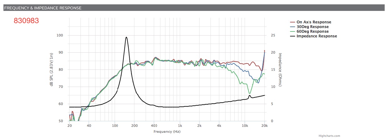

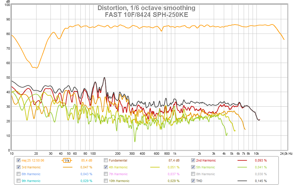

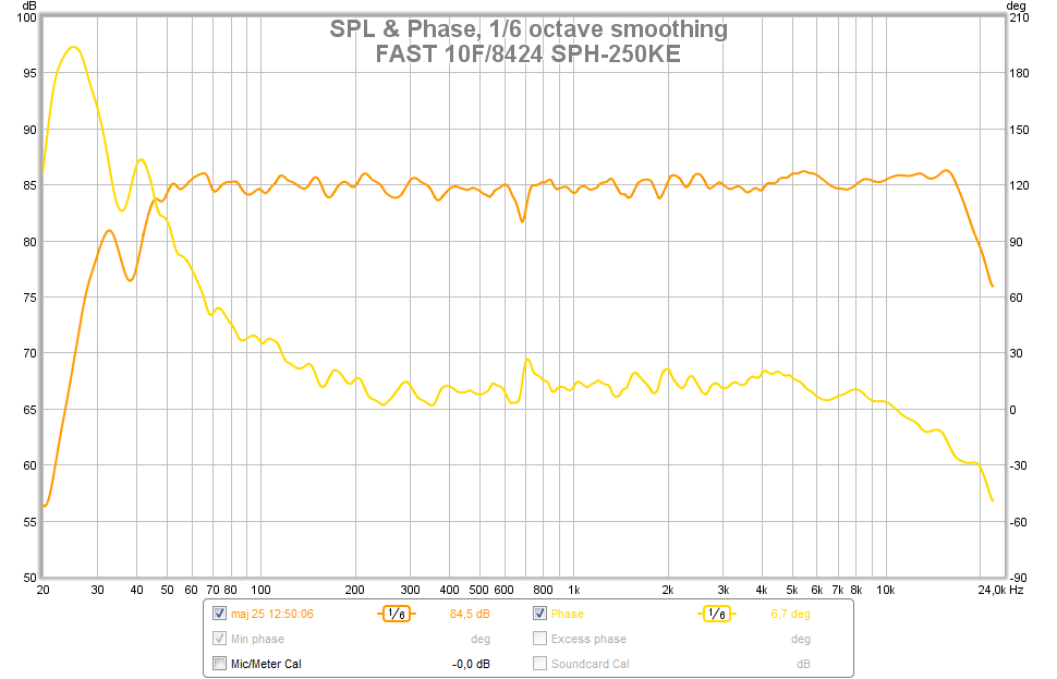

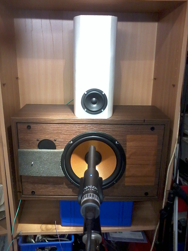

Jeshi,

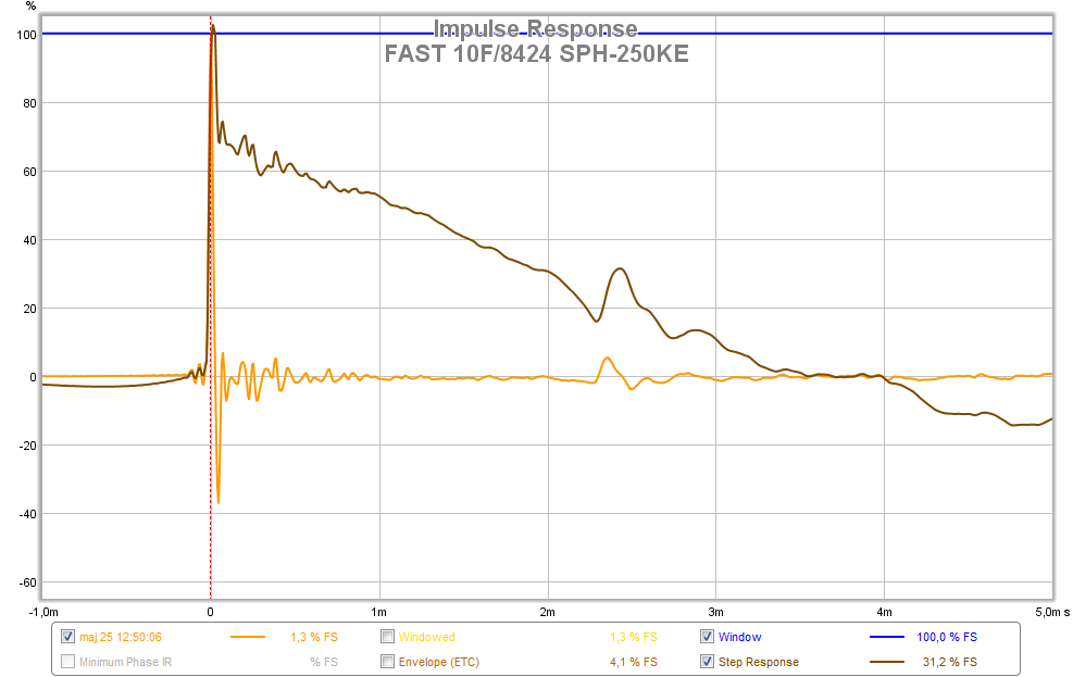

Agree wesayso and xrk971 regarding 10F/8424G00, probably the last step from good to great.
I have TC9FD too and it's very great value or maybe even one of the best in the right hands, example take a look at wesayso's line array thread, think if you can afford it take a pair those no matter you go for 10F or not.
Below is dirty and quick setup where 10F replaced TC9FD, and on my way building a common baffle those two drivers in a flat box designed wall mounting as Overkill Audio often suggest, so lets see what that brings.
In start the FAST setup was acoustic BW1 350 XO but over time discovered the perfect sound was really only present at mic spot in space where the acoustic slope targets where tuned in, or at least what i think was happening because i had some low level detail never heard before at other listening spots. It's now running a acoustic LR4 at 500Hz and small EQ corrections done with IIR filters in JRiver, then a XO LR4 neutralizing phase FIR convolution filter made in RePhase. The setup is quick and dirty and needs far more tweaking investigation and documentation with new box, but can say still its the closest i had been to ala headphone sound out in my room.

Thanks X you the one that shared hard work comparison threads and pointed us to 10F/TG9/TC9 as good performers.
Yeah must sound awesome or else i'm sick 🙂 in that i haven't moved a single setting since new XO (2-3 months). Think after i upped XO point to 500Hz sealed will be sufficient and intend try your Dagger at first as sealed then open up end if sealed miss anything. The new box will have drivers closer with CTC around 180mm and think if steering for a 475Hz XO point should give me progress on vertical lobe compared to what i hear at moment where its 240mm/500Hz actual sound and feels very good. The vertical lobe stuff i got hinted by Barleywater when he share his investigations and experience, when i get the time will try study his hints for Kirkeby inverse transfer functions too. Regarding the vertical lobe why i seek the 1/4 wave at XO point is because playing one particular track VAN HALEN 1984 album track 6. HOT FOR TEACHER have to be vertical on axis middle between drivers else some few tam-tam drum kicks fail timing in start of track where heavy dobbelt kick pedal used on bass drum.
The biggest progress was when upped XO point which i had tried out many times but this last time i phase neutralized the IIR XO and then it rocked as seen on SR when knowing real XO is IRR LR4. This setup is the most less track dependant i had and goes within the headphone note in previous post and think it was exchanging TC9FD for 10F that tipped the weight. Hope not sound as this is worlds best speaker or drivers or something, all details and experience so far these drivers is just to share if any can get ideas some of it.

Byrtt,
Indeed a great start using such a mash up. That wall box is horrendous source of early reflections. I highly recommend exploring a Linkwitz Pluto type mounting as with my TC9FD platform. And you will gain insight into why 500Hz crossover is much better choice than 350Hz if you look at my recent TC9FD FAST post.
Is the main reason to use 500Hz xo frequency to reduce the harmonic distortion of the mid/tweet by keeping its displacement very small? I have tried 400Hz and 500Hz xo's and find them more pleasing to the ears than 250Hz or 350Hz. Is the answer simy less distortion? Also, it lets a large cone woofer do the heavy hitting with the upper bass "punch".
.....I have tried 400Hz and 500Hz xo's and find them more pleasing to the ears than 250Hz or 350Hz.....
Speculate that the actual "more pleasing" note is because the discovery of steeper XO slopes (link: http://www.diyaudio.com/forums/full...-rs225-8-fast-ref-monitor-65.html#post4398911) with fair good linear phase at XO point was discovered, where before when using textbook steeper slopes 2.order and up and their inherent phase distortion at XO point ruined some a better sound especially because that phase distortion when going higher XO point got more into telephone band. Barleywater seems no matter frq point, steepness of XO, always have the XO phase distortion that IIR domain add fully repaired somewhere in system chain, sometimes even that his system has real world IIR bandpass limit, one can't see it in his phase plots 😎.
