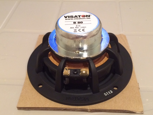

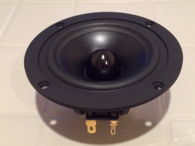

Behold, the elusive Visaton B80!
I finally have in my hands, after many many months of attempts to acquire, the venerable Visaton B80. I think this is the most expensive 3.5in driver of all the ones tested in the Blind Comparison threads at circa $160USD. This unit was graciously provided by a fellow member who acquired it in Austria and shipped it to me himself. From appearance alone, it is understated, yet is indeed a driver to lust after.

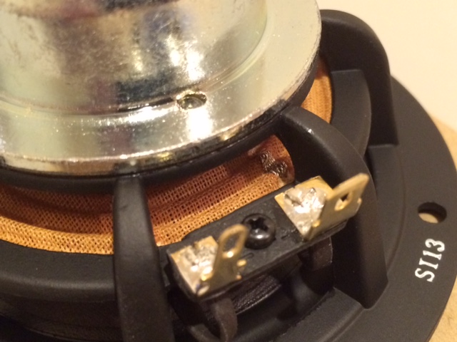

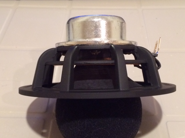

The cast aluminum frame is perhaps the best I have ever seen on a 3.5in driver with a low-air-resistance design that resembles something from a large 2kW pro audio subwoofer. The spider is suspended delicately and super ventilated. The basket legs are curved and thin. The Nd magnet is small to stay out of the way. The wire leads are tinsel WOVEN into the fabric of the spider - first time I have seen this done. There is a solid metal phase plug. The cone appears to be coated paper. Very nicely finished and build quality is exceptional.

Front:
back (how many drivers do you know that are CE certified? That costs a lot to do...):
Detail of spider with woven leads:
Detail of thin basket legs and exceptionally well ventilated areas behind cone and spider:

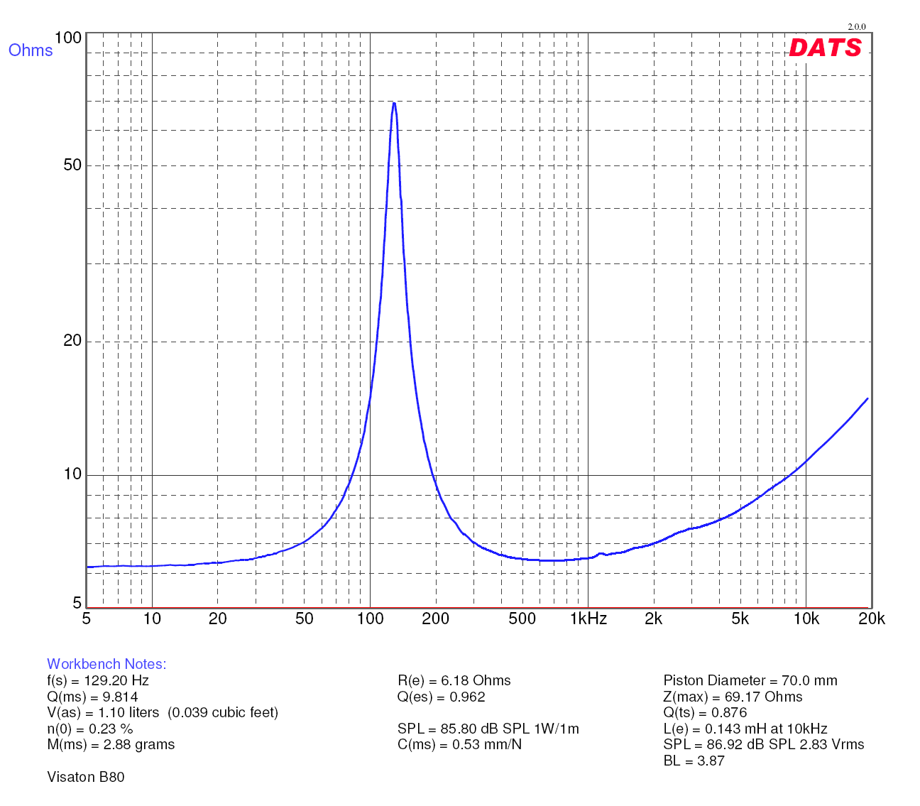

Here are measured TS parameters, Qts and fs are higher than factory spec:

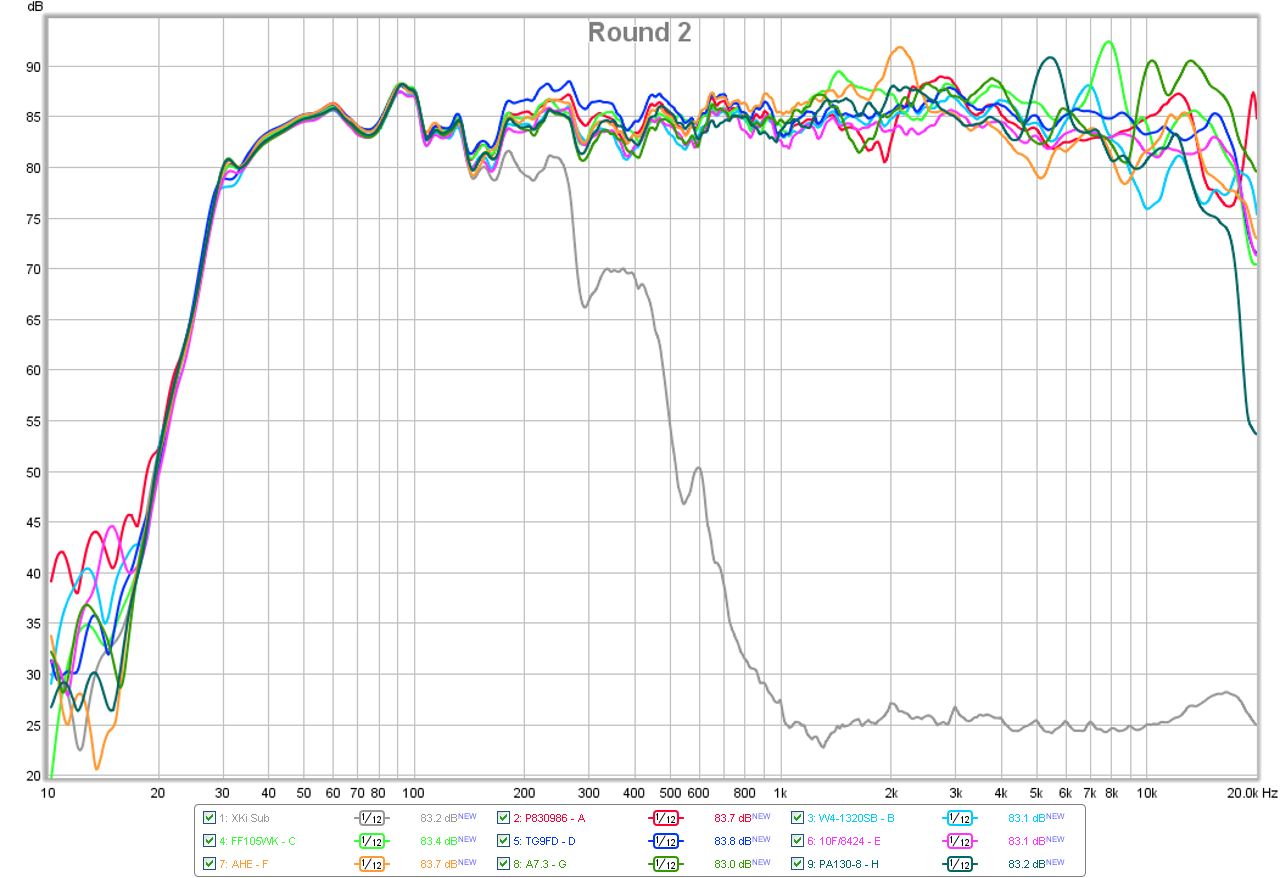

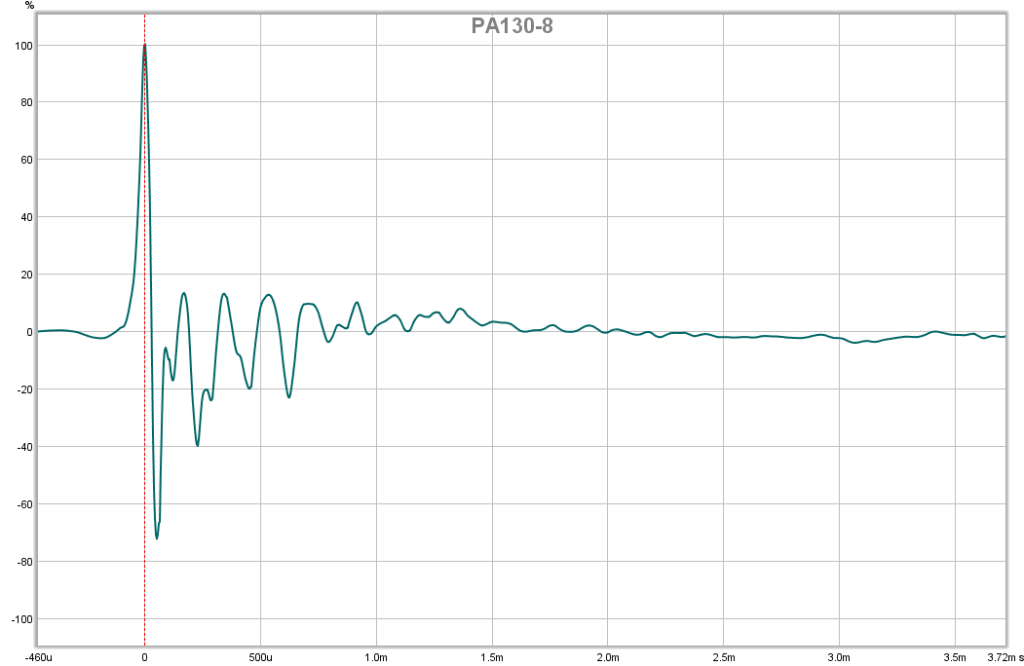

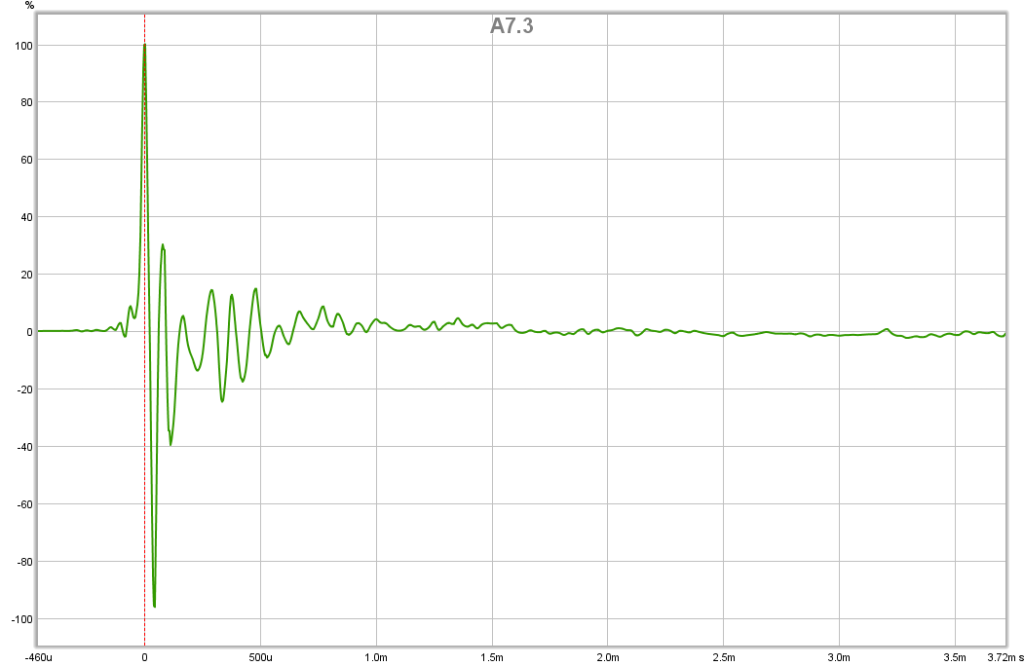

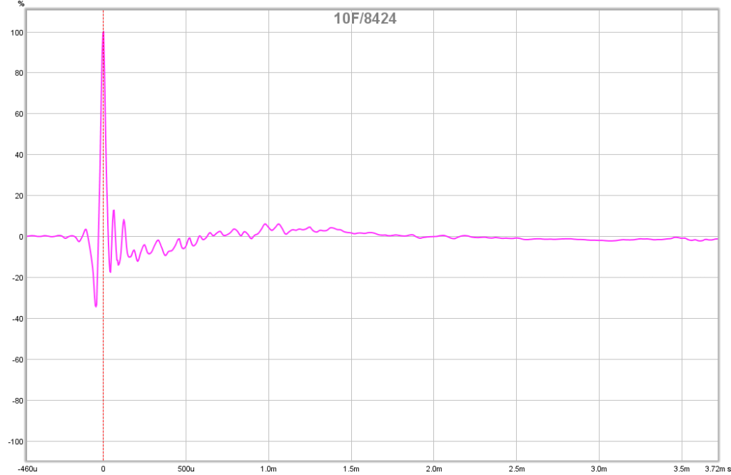

A = P830986
B = W4-1320SB
C = FF105WK
D = TG9FD
E = 10F/8424
F = AHE
G = A7.3
H = PA130-8
Frequency Response in FAST:
483567d1431871307-subjective-blind-comparison-3in-5in-drivers-round-2-blind-compare-round-2-summary-overlay.png

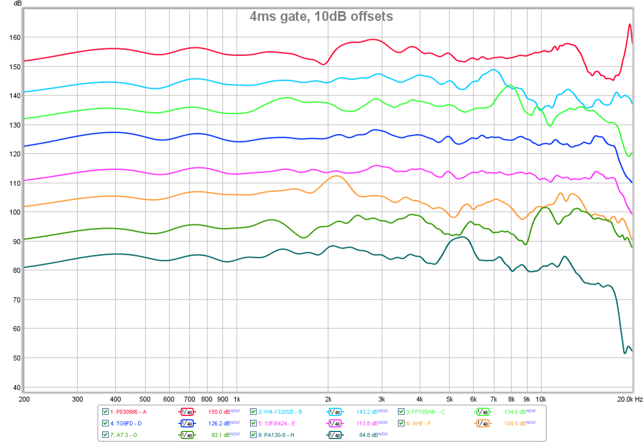

Frequency Response with 4ms gate at 1/48th oct avg and 10dB shift for clarity:
483568d1431871307-subjective-blind-comparison-3in-5in-drivers-round-2-blind-compare-round-2-summary-4ms-gate.png

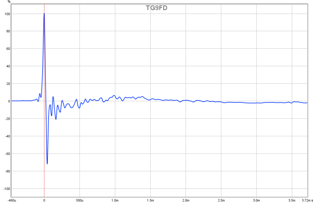

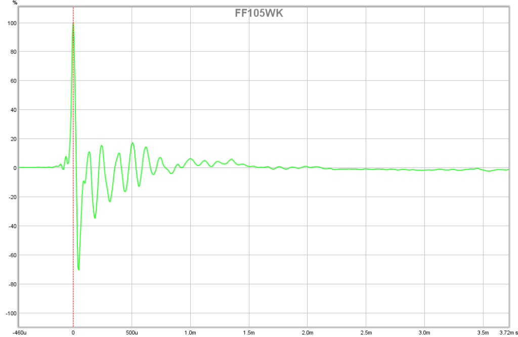

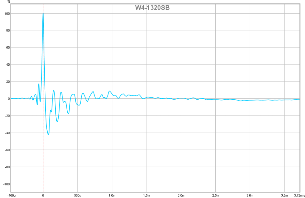

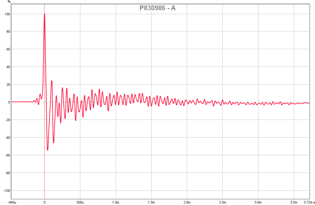

And Impulse Response for all:
483570d1431871307-subjective-blind-comparison-3in-5in-drivers-round-2-w4-1320sb-ir.png
483573d1431871307-subjective-blind-comparison-3in-5in-drivers-round-2-10f-8424-ir.png
