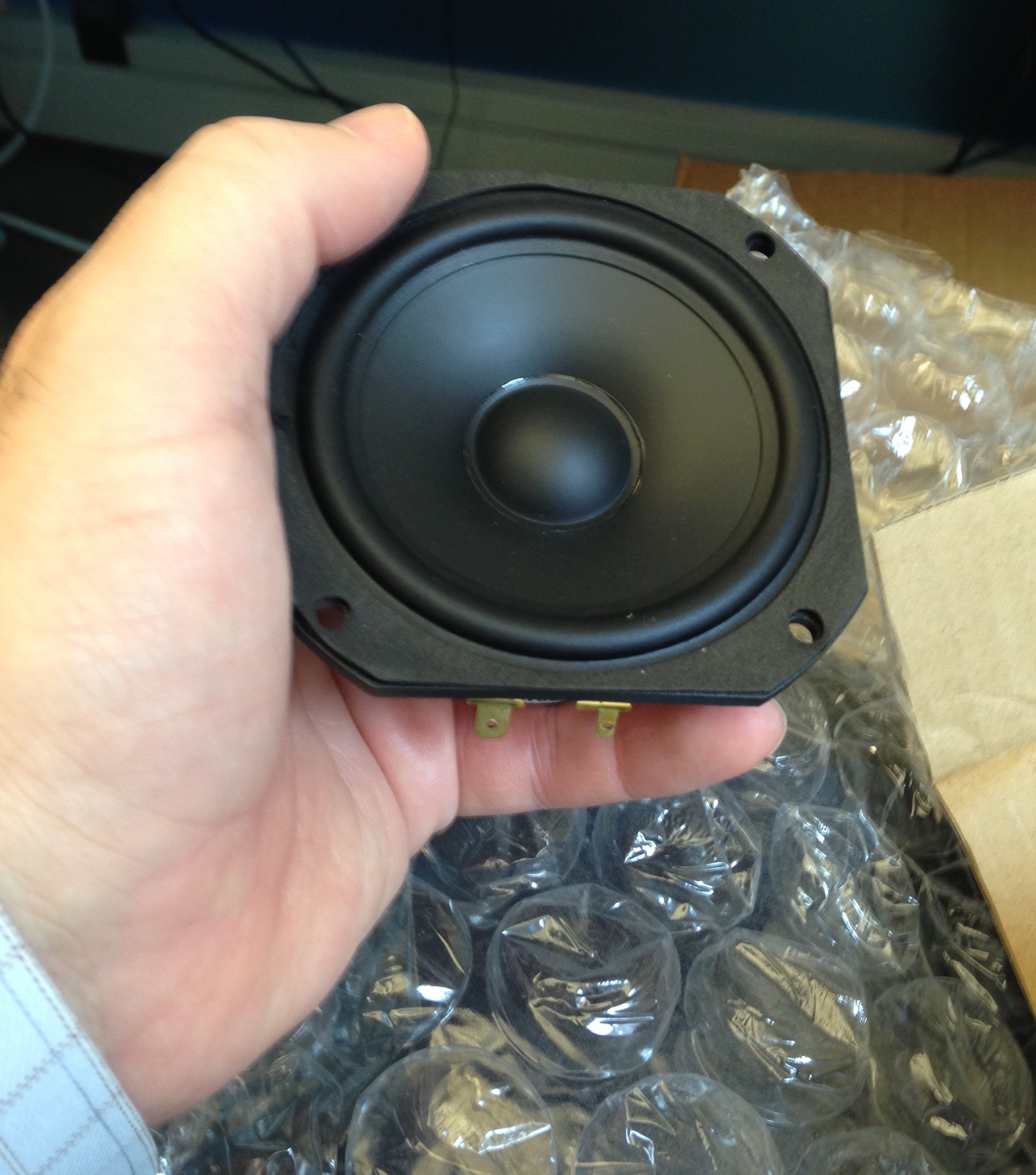

Just bought the little Vifa/Tymphany driver. My first impression is that it's physically very light and small. Can't imagine getting much sound from it.
I'm going to set it up on an open baffle and compare it to the Eminence 12lta and Tangband 1808 I have on hand. H-frames will provide bass.
I'm actually psyched to hear it! Haven't heard a driver that measures flat in years.

Hi Godzilla,
Great that you now hold in your hands, one of the finest drivers made. No kidding around - it may be cheap, but there is no correlation of sound quality with price. It is only an 85dB sensitive driver - so not loud, but it is very smooth and clean. The impulse response can't be beat (no ringing). About the only drivers that may be better are the TG9FD (fiberglass cone) and the ScanSpeak 10F family which is substantially more expensive.
A few threads you might want to check out regarding the TC9FD in an OB:
http://www.diyaudio.com/forums/full-range/249984-cheap-fast-ob-literally.html
http://www.diyaudio.com/forums/multi-way/110583-fast-fun-inexpensive-ob-project.html
http://www.diyaudio.com/forums/multi-way/252593-novel-open-baffle-construction-techniques.html
If using the TC9FD in an approximate 12in wide baffle, I think a 350Hz XO is about right. What you will notice with this little guy vs the larger full ranges you have: the polar dispersion will be wider and more uniform, you may feel that the impact or punch (150Hz to 200Hz) may be missing but if you XO at 350Hz, that should come from your woofers.
Have fun!

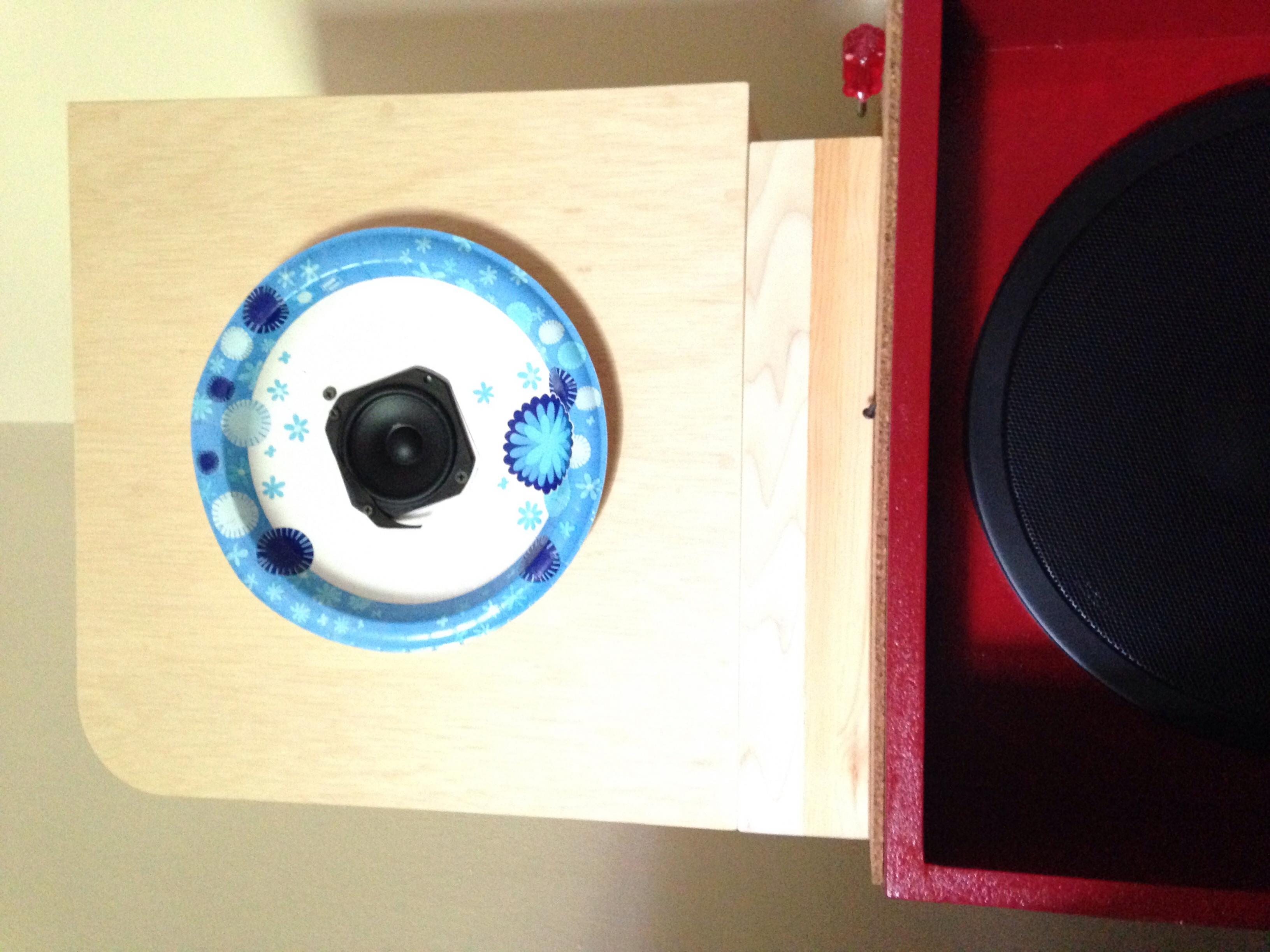

Yes, the plate acts as a waveguide. The waxy surface on the plate improves DDR. I'll try the fork tomorrow.
I'm with my two teenage boys this weekend and we all wanted to hear the driver - among others. We had a lot of fun swapping drivers in and out and listening to music. Good thing I had the plate because the day before I threw out all scraps of cardboard.
I love it. Food for the ears. 🙂
