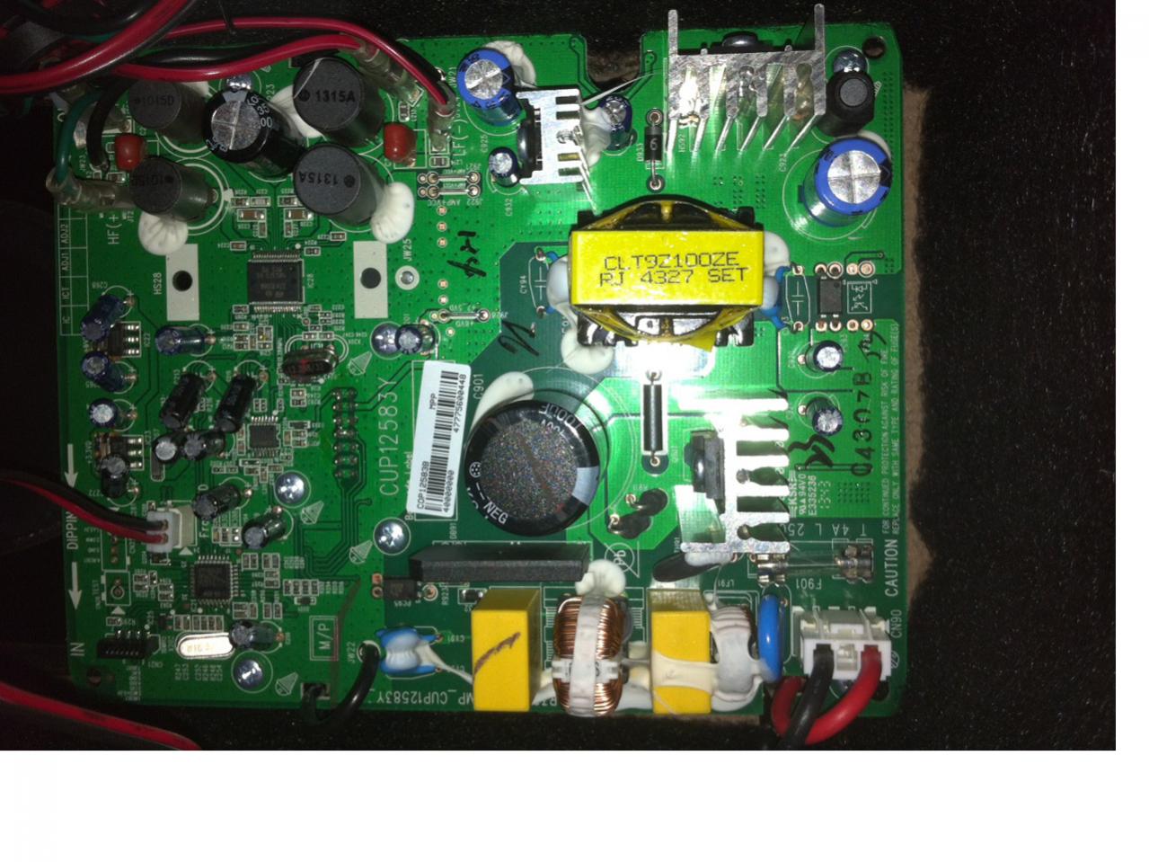

Check out the reviews of the budget JBL LSR305. I can't find a bad review or actually a non glowing review. This is for the M2 waveguide which everyone says is magical. Powered by a class D TDA7492 I think. $225/pair on sale $300/pair regular.
Not the tda7498 I remember, but more like a ddx version, full digital, meaning some sort of signal conversion befor amps. Similar to spdif/toslink only input Hifimediy amp I have. But haven't looked at those JBL for some time.

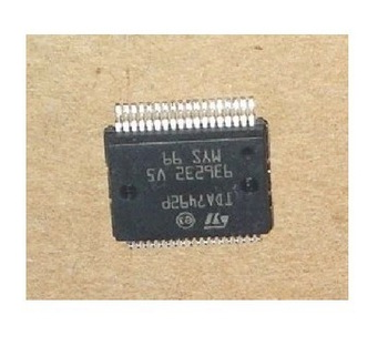

Look at closeup photo of take apart review here and compare photo of amp to TDA7492 IC. Blurry but the package and other marks match quite well, and given 41 watt rating allowed me to deduce 7492 as the amp used.
JBL LSR305 Studio Monitors
Here is the photo from above link - zoom in on class D amp in upper left corner:
Compare here with photo of TDA7492:
This particular unit is using bottom side conduction to PCB vias for cooling heatsink. JBL was very proud of how they saved money by not needing a heatsink on LSR305 to get a cost competitive product.
Chip is STA something, you could also see a clock/crystal/oscillator?? and a adc/dsp??? near bottom below STA chip
Chip is ST Microelectronics.
TDA7492 50 W + 50 W dual BTL class-D audio amplifier - STMicroelectronics
Datasheet:
http://www.st.com/web/en/resource/technical/document/datasheet/CD00205863.pdf
I doubt they are applying DSP on this budget speaker - they would have bragged about it in features and propaganda. Timer xtal may be for microcontroller to set gains etc and turn/on off thump control.
