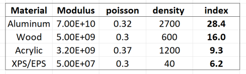

Still just a thin plate model, I'm afraid!
Dave,
My FEA program uses a thick plate model, so I decided to use it to see how much error the "thin plate model" might be introducing in your simulation, and in particular the determination of the panel's coincidence frequency. My conclusion (from the analysis below) is that it really doesn't introduce too much error for typical isotropic materials. Hopefully the analysis is sound! (pun intended).
I suspect you know the following, but am including it for context. Thin plate theory ignores shear deformation and rotary inertia, which is a good approximation as long as the plate is thin relative to its length. Typically panels have a length to thickness ratio of around 100 or more, so thin plate theory should apply. But at high frequencies, the real "characteristic length" isn't the length of the panel , but rather the length of the bending wave. And at high frequencies, the bending wavelength is much smaller than the length of the panel. So at sufficiently high frequencies, there is a point where the thin plate model is no longer a good approximation. Where does thin plate theory break down, I wondered, relative to the coincidence frequency? That's the question I wanted to answer.
The basic idea was to compare the bending wave speed predicted by the FEA model to the bending wave speed expected from the thin plate model, and determine at which conditions there is significant deviation.
From the equation for coincidence frequency using the thin plate model, I re-arranged it and came up with a parameter I named the "thin plate index" which represents the ratio of the bending wavelength at coincidence (per thin plate theory) to the panel thickness. As shown below, this "index" is a function of the panel's elastic properties, density, and the speed of sound (c).
Then, I used my FEA program to model a simply supported beam for a wide range of values of the "index". For each different value of the "index", I computed the coincidence wavelength (per thin plate theory), and used that as the length of the beam. I then used the FEA modal vibration analysis to determine the resonant frequency of the second mode (which includes exactly one full wavelength). Finally, I calculated the bending wave speed by multiplying the beam length by the FEA calculated modal frequency. The results are shown in the plot below. The vertical axis is the ratio of the calculated bending wave speed to the speed of sound. The horizontal axis is the "thin plate index" described above.
Of course, since the coincidence frequency is defined as the frequency at which the bending wavespeed equals the speed of sound, the plot "should" be a flat horizontal line at 1.0. And that is exactly what happens for high values of the thin plate index. But at low values of the index (essentially low values of E/rho), the bending wavespeed is actually slower than the speed of sound. The implication (I believe) is that for plates with a sufficiently low value of "index", the coincidence frequency predicted by thin plate theory will be lower than the true coincidence frequency. From the plot, it looks like thin plate theory is very good for an index over 20, decent between 5 and 20, and going bad rapidly for an index of 5 or less.
I calculated the "index" for a couple of common materials, and came up with the results below.
I think these cover the range of for most typical materials. Only for the PS foams does the index get low enough that the thin plate theory becomes questionable, and even then the error looks only to be on the order of 10% near coincidence, so not so bad after all.
Any thoughts (corrections?) would be appreciated.
Eric

Hello Eric,For each different value of the "index", I computed the coincidence wavelength (per thin plate theory), and used that as the length of the beam
I agree on the formula of what you call the index but I get lost with the sentence above.
The index is dimensionless (index = lambda_fc / h) so to get a beam length equal to the wave length of the coincidence frequency from the thin plate theory, you need to choose a thickness no?
In addition what I don't see (understand it is "does all of that remain physical in the idea of representative of our plate enough?". Our materials have a coincidence frequency from 5k (ie XPS 20mm) to more than 20kHz (acrylic or wood in 2mm) so a wave length in the air in the range let say 20mm (acrylic or wood 2mm) to 70mm (XPS 20mm). Considering their index from 6 for XPS to 10 and above for the other, it comes an XPS beam thickness of about 10mm and less than 2mm for the others which is not too far from the real thickness.
From FEA point of view is it correct to make a calculation on a beam with a ratio length to thickness going as low as 6?
Christian
Yes, to run the model, I needed to choose a thickness. But what thickness I chose shouldn't affect the plot. That is, if I chose a thicker plate, the corresponding wavelength would increase exactly in proportion, and the bending wave speed would be the same regardless of the panel thickness.you need to choose a thickness no?
It depends on what exactly you mean by a "beam". That is to say, if by "beam" model of a plate, you mean a model based on thin plate theory, then no, it would not be correct. But when I said I modeled a "beam", what I meant is that I used a plate with a very small transverse dimension compared to it's length. That way the LISA FEA model ran a lot faster. But the plate model I used is not a "beam" (i.e. Bournoulli-Euler) model, but rather a Mindlin plate model, which should be valid even when the "beam" length is very short.From FEA point of view is it correct to make a calculation on a beam with a ratio length to thickness going as low as 6?
Eric

I think I share the same general concern as Christian - I see how the thickness of the plate is normalized out because it's included in the "thin plate index," but is the beam length also unimportant in the results shown in that graph?
Christian,
Below is the data generated to create the plot. The column " f at Lct" is the determination from the FEA of the natural frequency at the thin plate coincidence wavelength. LInes 1 to 10 were the original data used in the plot. I used a thickness of 3 mm for all those lines. I modified the index (labelled below as "Lct/h") only by varying the modulus, but presumably I could have used any combination of E, rho, and density to obtain various values of the index, but since it is dimensionless, it should not matter how I got to any particular index value.
For line zero, to confirm my earlier answer to your question, I doubled the thickness to 6 mm. By doubling the thickness, the "coincidence" wavelength doubles, and the corresponding frequency doubles. And in the end, the ratio of the bending wave speed (Cb) to C remains the same.
Eric
