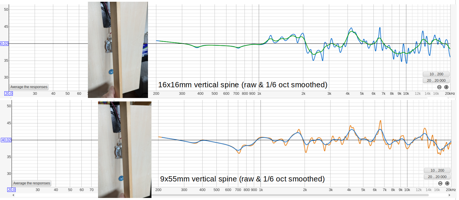

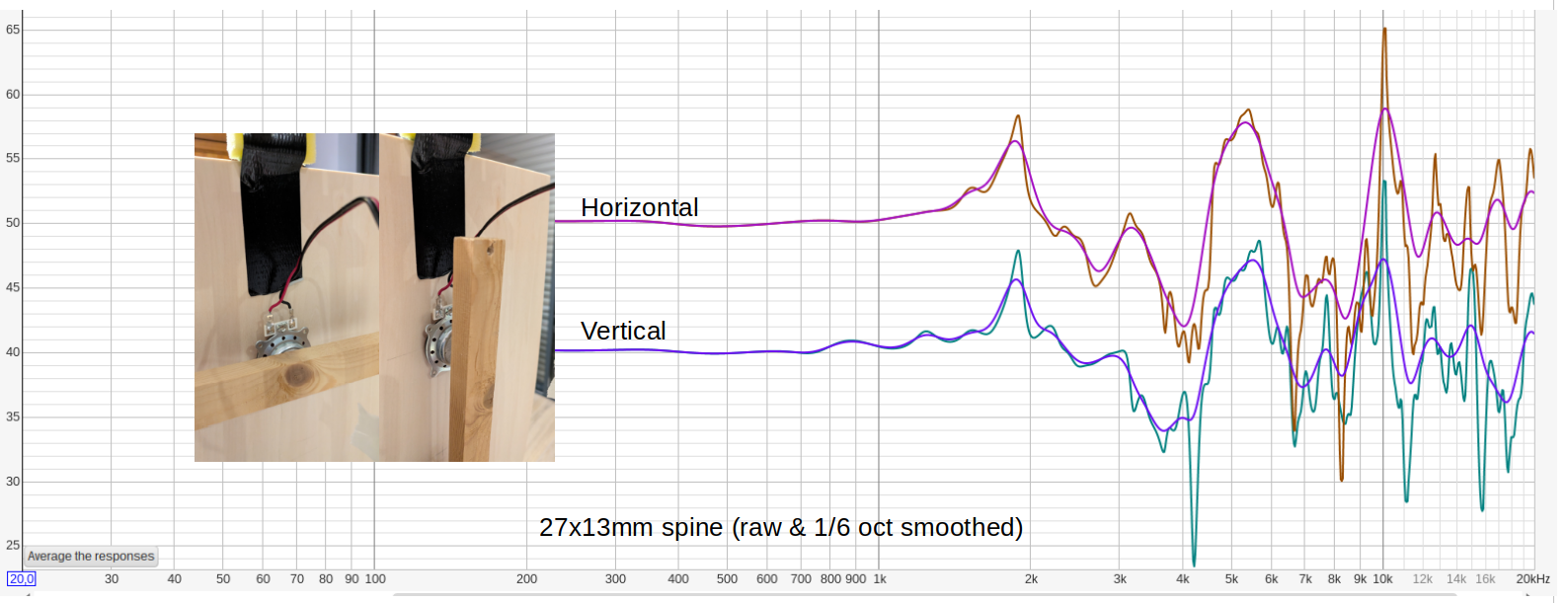

In the seach of "cavity noise": step 1, beware of the spine!
In the past days, I was surprised how my measurements from the rear side may differ from the ones from Eric. So I made new measurements in the idea to have more flexibility on change at the rear in order to understand why those differences and of course to try to find a cause of the difference of the front and rear frequency responses.
From those tests, it comes something that is pretty obvious afterwards : the spine can be the main cause of the difference in SPL between the front and the rear.
Below are the FR of the tests done. There are some pictures to show the set up and the curves are the difference of rear frequency responses with the test spine and without (not smoothed difference and 1/6 of octave smoothed)
The widest the spine, the highest the peak and not by few dB!
Even a spine of about 10mm width creates peaks and dips of several dB.
I didn't have the possibility during those tests to evaluate the influence of the shape (round edges) and the distance from the exciter.
Of course more tests to confirm or not are welcome!
Note that without spine, a difference front to rear not shown here remains.
But if so... what about... to follow in a next post.
Christian

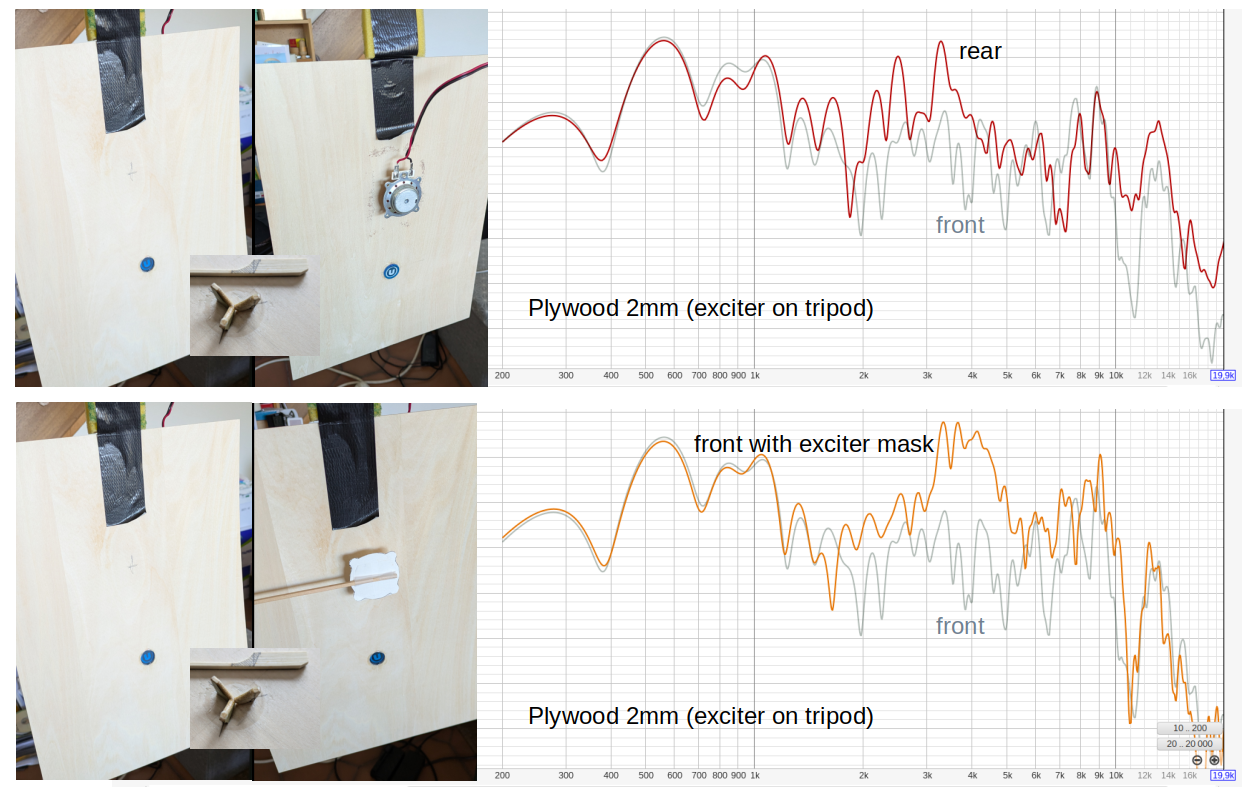

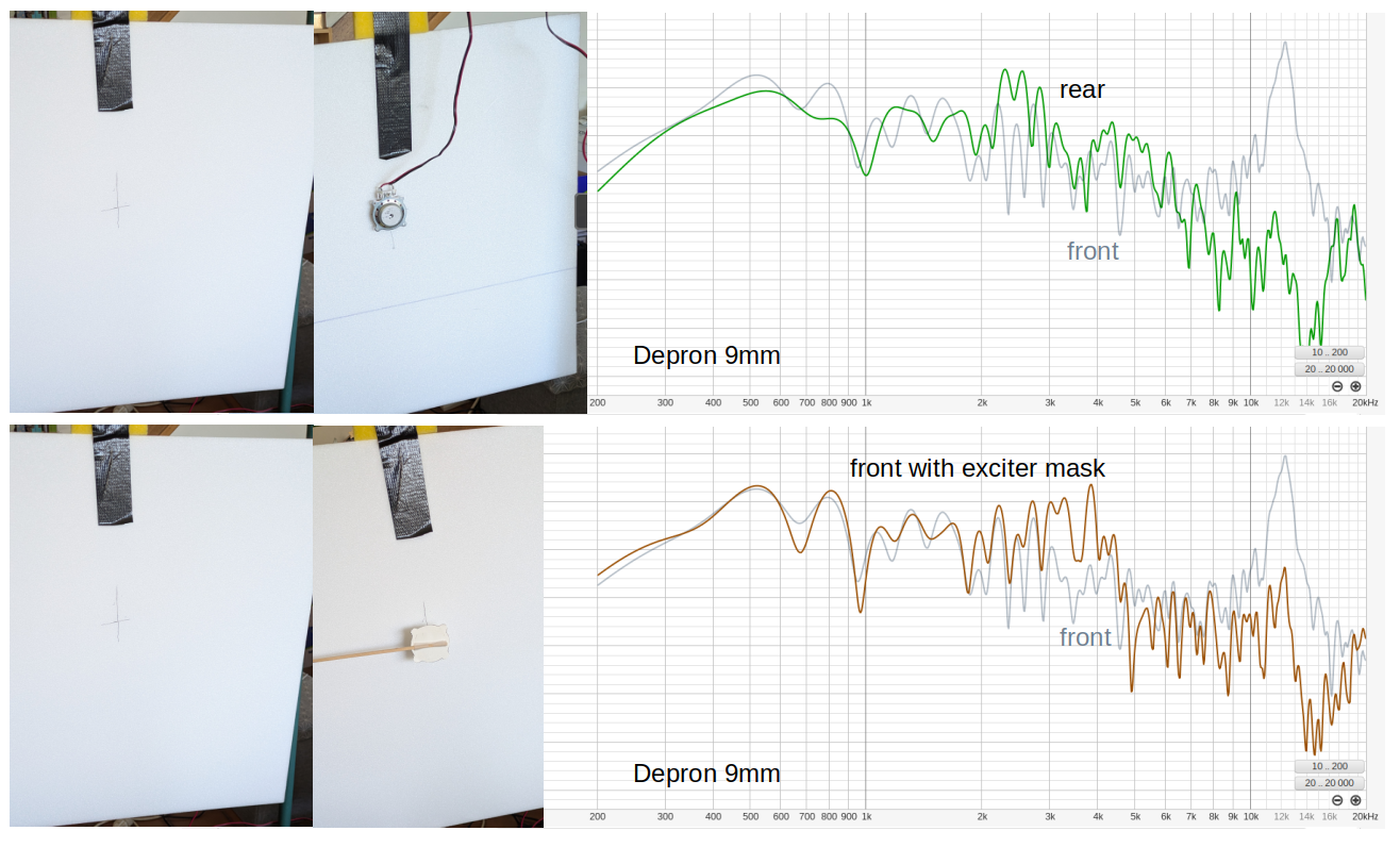

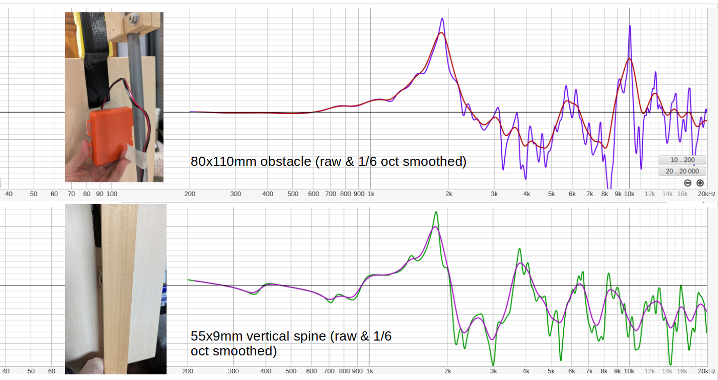

In the seach of "cavity noise": step 2, end of the tree that hid the forest?
But if a spine can significantly change the FR of the rear... what about the mask effect of the exciter itself?
Below are 2 panels I just tested. The idea is to measure the front side, the rear side (of course without spine, just the exciter) and again the front with at the exciter axis, at some mm a mask having the shape of the exciter (about 50mm for a DAEX25FHE)... and it seems to create artifacts similar to what happens at the rear.
Not highly precise neither highly scientific but it seems to show interesting things that the trials to reduce the compression of the air in the voice coil area haven't shown for now.
This doesn't mean the cavity noise is not another source of peaks at the rear (in the 5 to 6k range?
The first panel below is a plywood where the exciter was mounted on a sort of tripod. The idea was to allow the air to flow through it while keeping an interface on a disk of 20/22mm (larger than the previous concentrator I tested). This panel as with the previous concentrator shows many spikes in the IR. So no good news on the concentrator topic.
The second panel is an XPS (Depron 9mm). The exciter is PVA glued on its ring. The drum effect is huge!
Conclusion? Part of the rear SPL difference might come the mask created by the exciter itself which would increase the difficulty to find a countermeasure
Christian

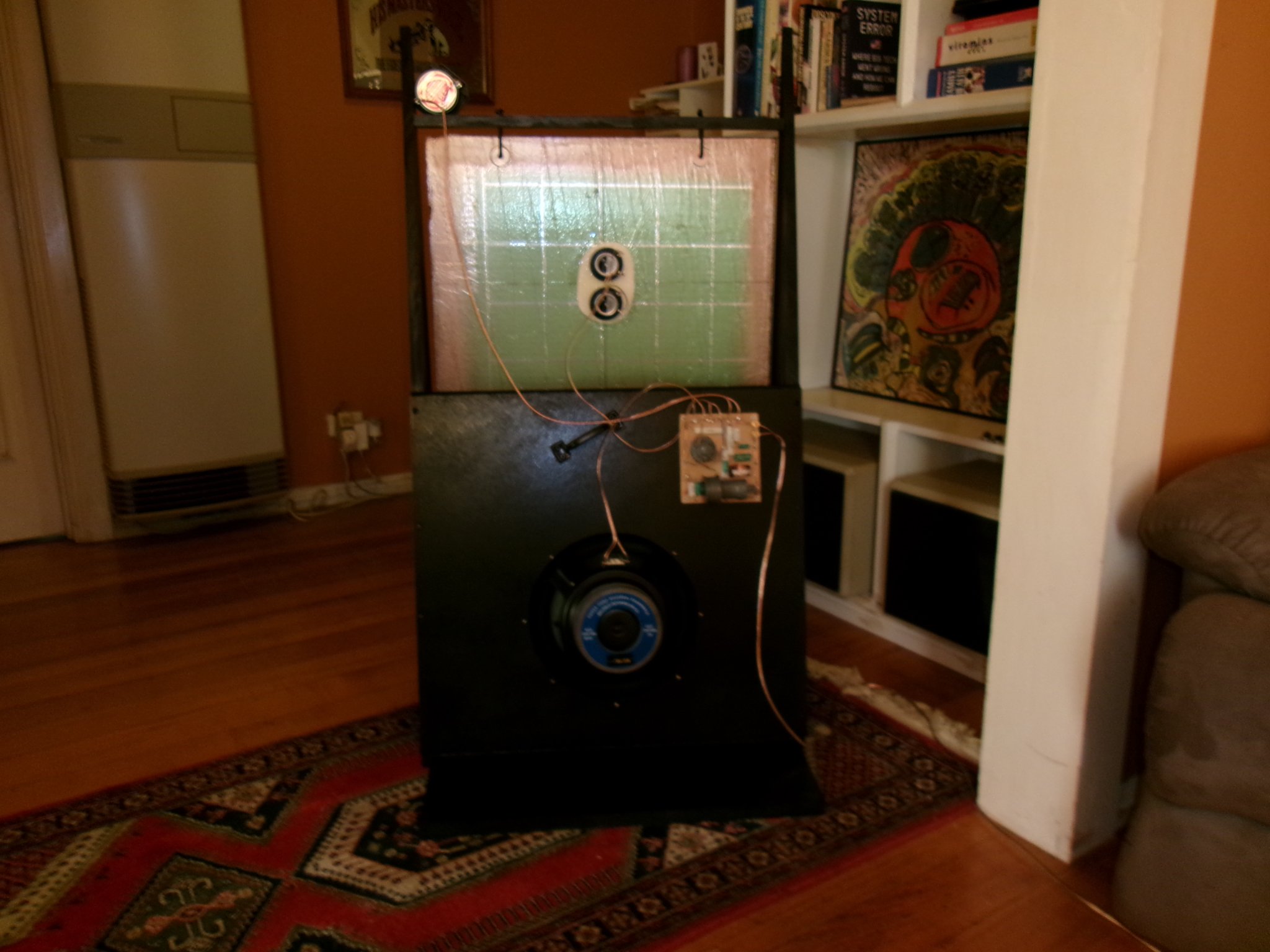

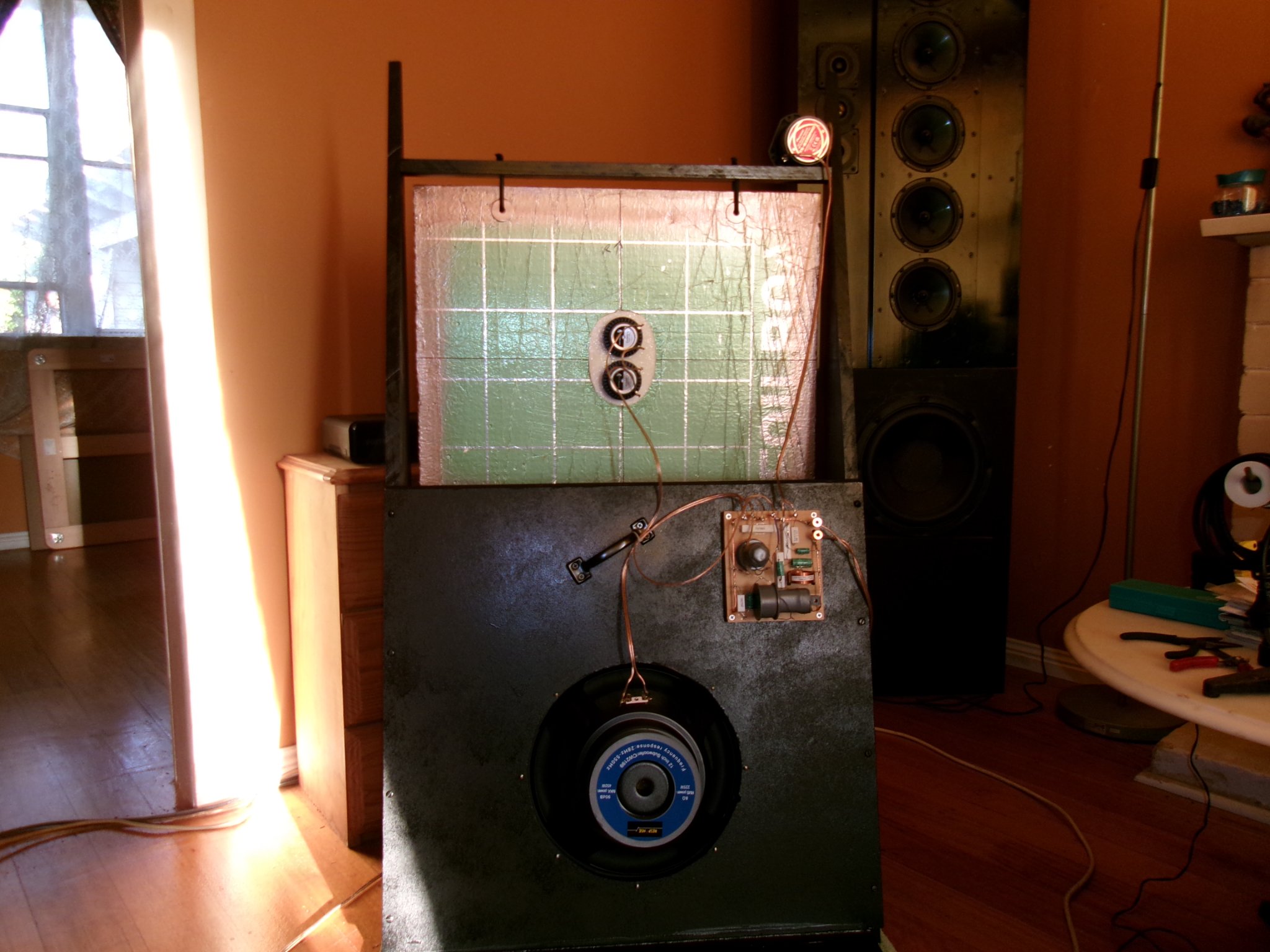

When I first made & hung the 600mm x 500mm DML panels and connected them directly to the amplifier >
I was dreadfully shocked by their horrible sound. They were 'honky & resonant' and tonally wrong.
I thought - boy have I got a challenge on my hands to make these sound good.

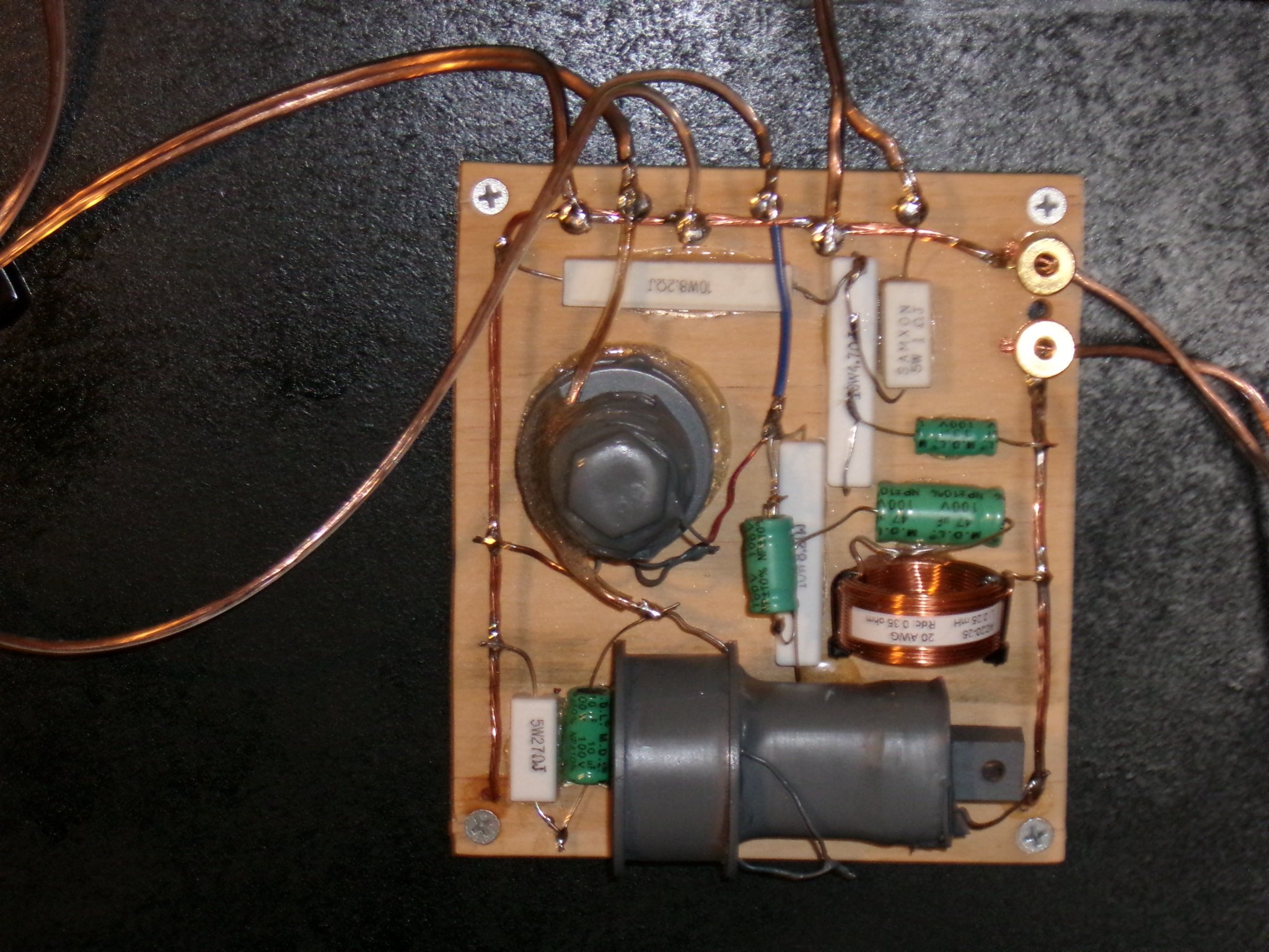

The first stage to improve sound and incorporate the woofer and tweeter was to design 'passive EQ' into
the crossover network. This improved sound by 50%.
Hi there folks 🙂

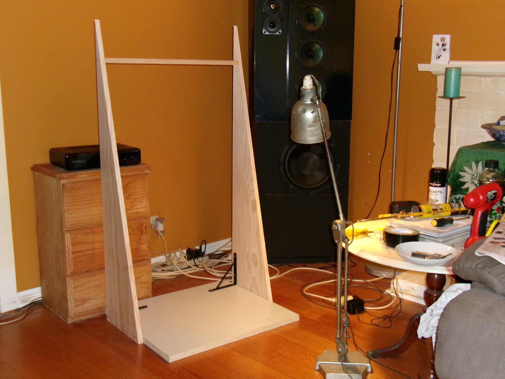

I have finally finished my HYBRID DML speaker project > DML + open-baffle woofer + tweeter.

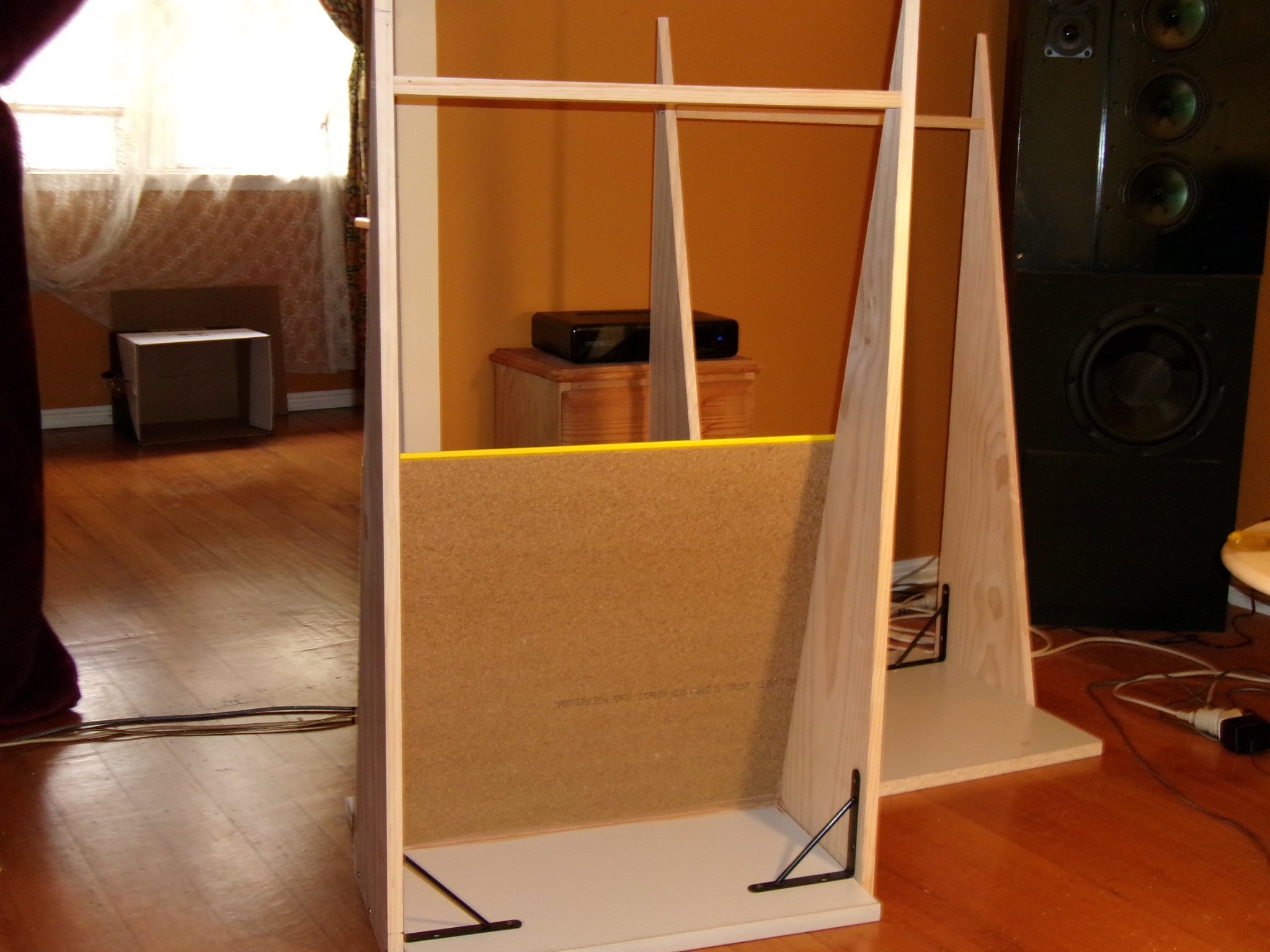

I will start with the wood-work. ( I had to build with no workshop and only hand-held tools )
The first challenge was to not only make a frame to hang the panels, but also provide a quite large baffle
for the woofer + a mounting position for the tweeter.
Using some imagination, I arrived at a rather unusual & unique design.
My starting point was to provide a strong & sturdy floor base-plate > 620mm x 540mm x 25mm = 5.5Kg.
( because these speakers go strongly down to 30Hz, I didn't want them 'dancing about' )
From this base I built upwards > apart from this base-plate and a 'hanging brace', there are only 3 pieces of wood.
Here are some pictures:
Christian

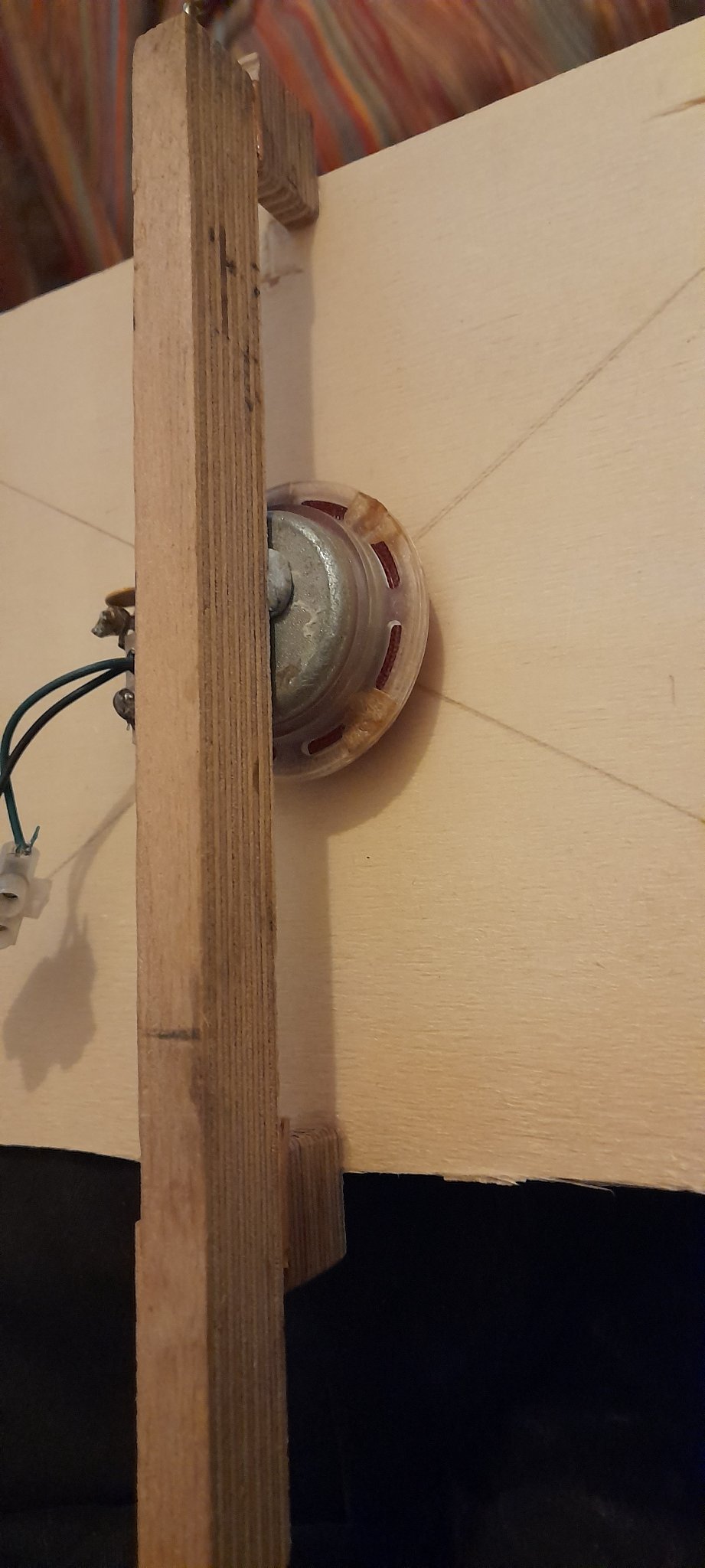

Hello Christian.
This is why I try to keep my spines as thin as possible.
What about the cavity noise from the spider panel area, top and bottom.
This is why I suggested if using a central thread on my new exciter, to extend the thread bolt length a few inches to minimise the panel exciter noise.
I also suggest using a doweling from the exciter to extend the distance from the exciter magnet to the spine, I have not measured this.
Steve.
Hello Steve,
This is wise... and it was not wise at all from my side to make a support larger than the exciter like in my current plywood panels. Anyway, now everybody is warned about the possible interaction with the spine.
I am not sure to follow you here... Do you suggest to increase the distance panel/exciter? I made tests with some additional parts to increase the distance panel/exciter. The last "tripod" extended it by 10mm, a previous one (too heavy I think) gave 15mm. I only got strange additional spikes on the IR and no obvious other improvements. It might be those improvements are hidden by some other problems...
Yes, I have also this solution in mind to increase the distance exciter/spine and make the connection with some rod or cylinder up to about the magnet diameter. It opens also to solutions to avoid to apply constraint on the voice coil position because of imprecision in the frame parts.
Christian
