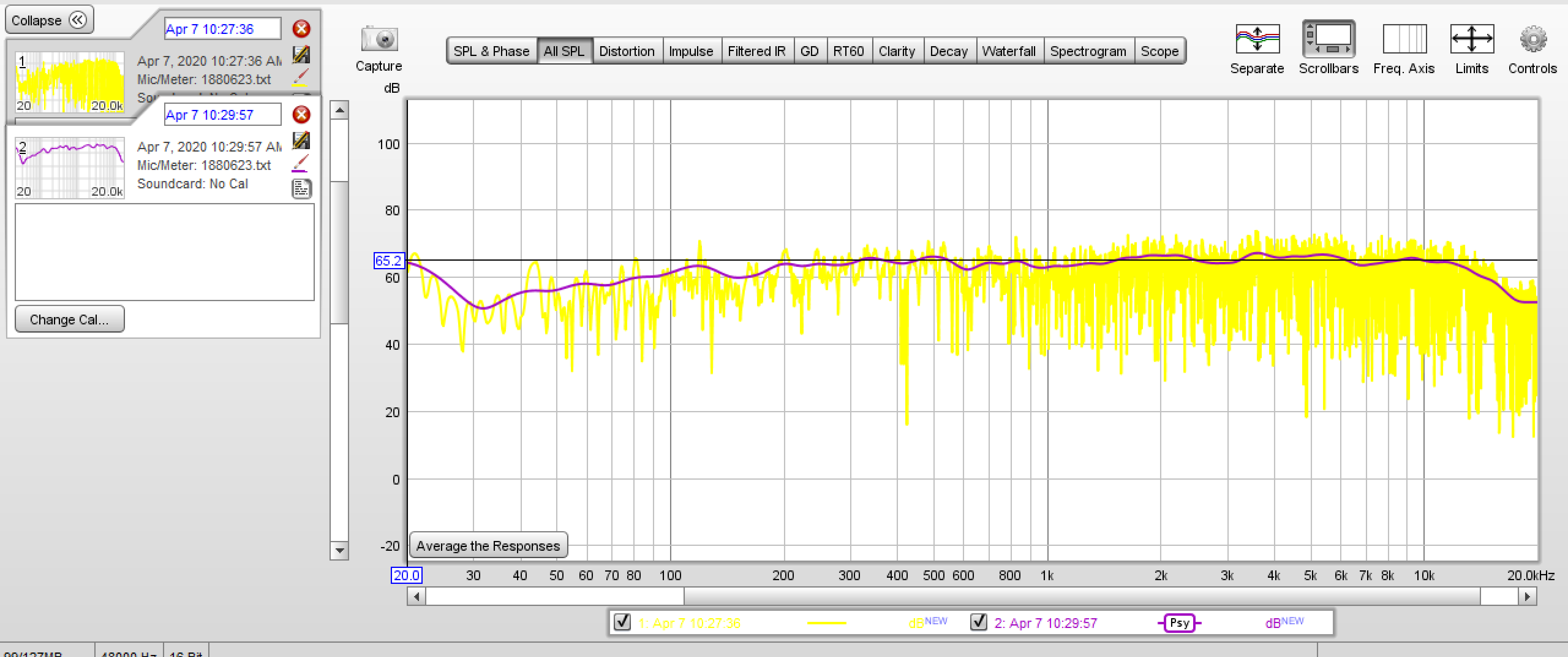

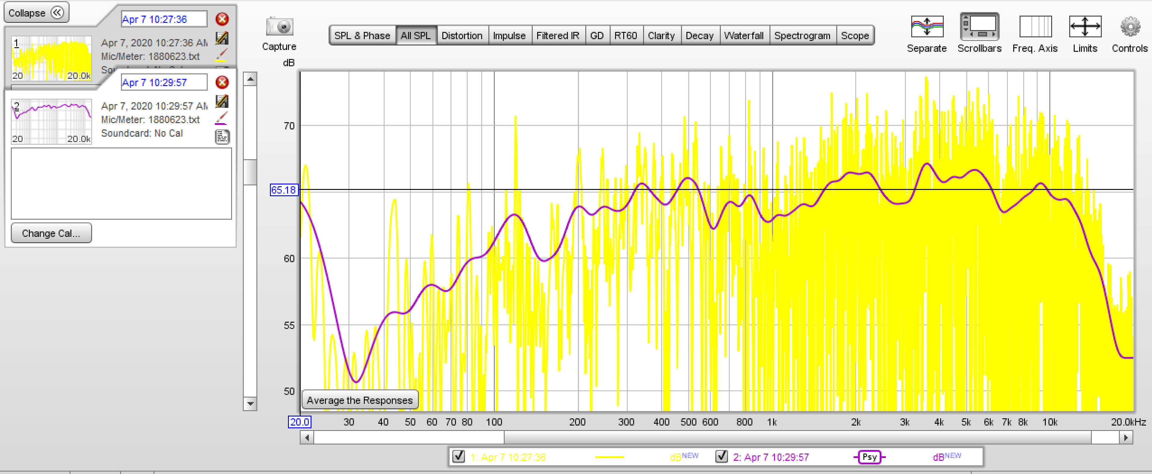

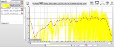

REW measurements with DSP equalization. Yellow is raw. Purple is smoothed using psychoacoustic filter. I tried to keep the frequency response within +/- 2.5db between 200hz to 15,000hz. I tried to kill the signal after 15,000hz for the sake of my dog.

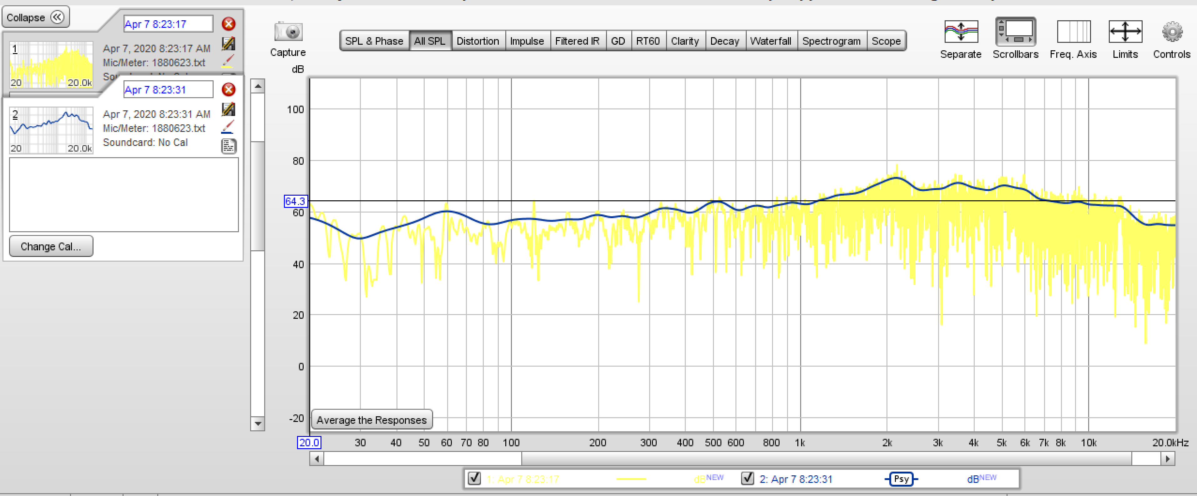

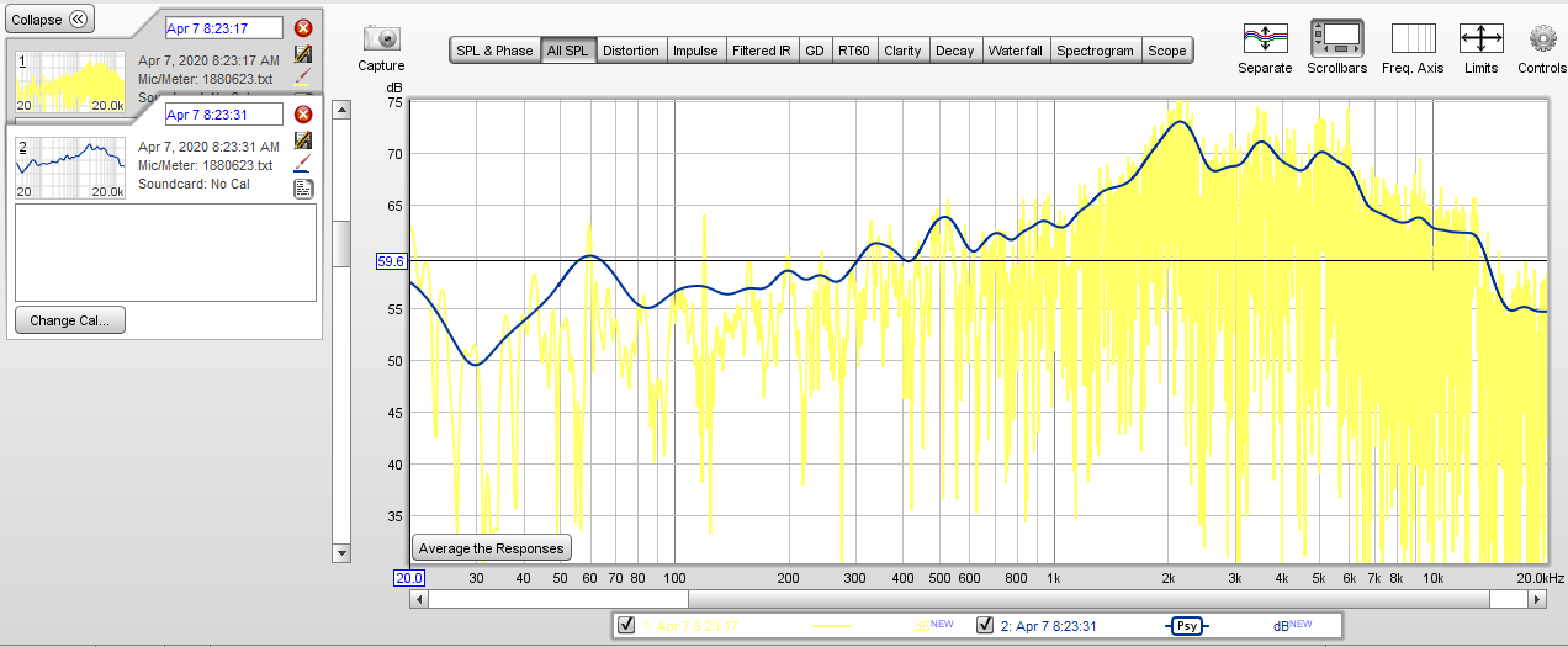

New REW measurements. No DSP equalization. Yellow is raw. Blue is smoothed using psychoacoustic option.
Very cool. Probably more precise than what I am doing. I had to shut of fridge, furnace and water pump to avoid extraneous sound artifact. How do these programs deal with background and ambient noise when doing correcting
It sends the signal through the speakers so it knows what it should be hearing.
Don’t you have to mike the speakers or room? What’s to stop a ambient noise from getting into the feedback loop?
The speaker and mic are both controlled by REW.
Don’t want to beat a dead horse but say you have a 60 cycle rumble in your house and a 60 cycle signal coming from your siggen out to the speakers - how does the program know what component of that signal amplitude is from what source?
I use a USB measurement mic from MiniDSP. It comes with a calibration file which REW uses in its measurements. The idea is to have your measurement signal from about 1m around 80dB which should be well above the noise floor. The low end is always difficult due to influences from the room. REW is a great tool and FREE.
