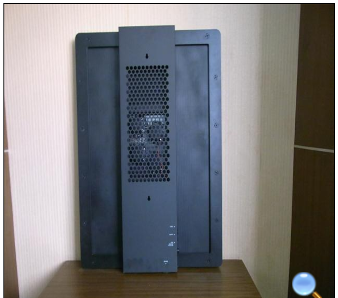

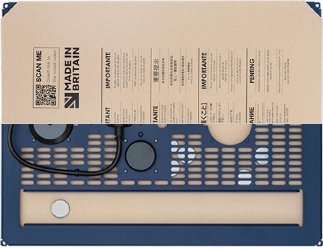

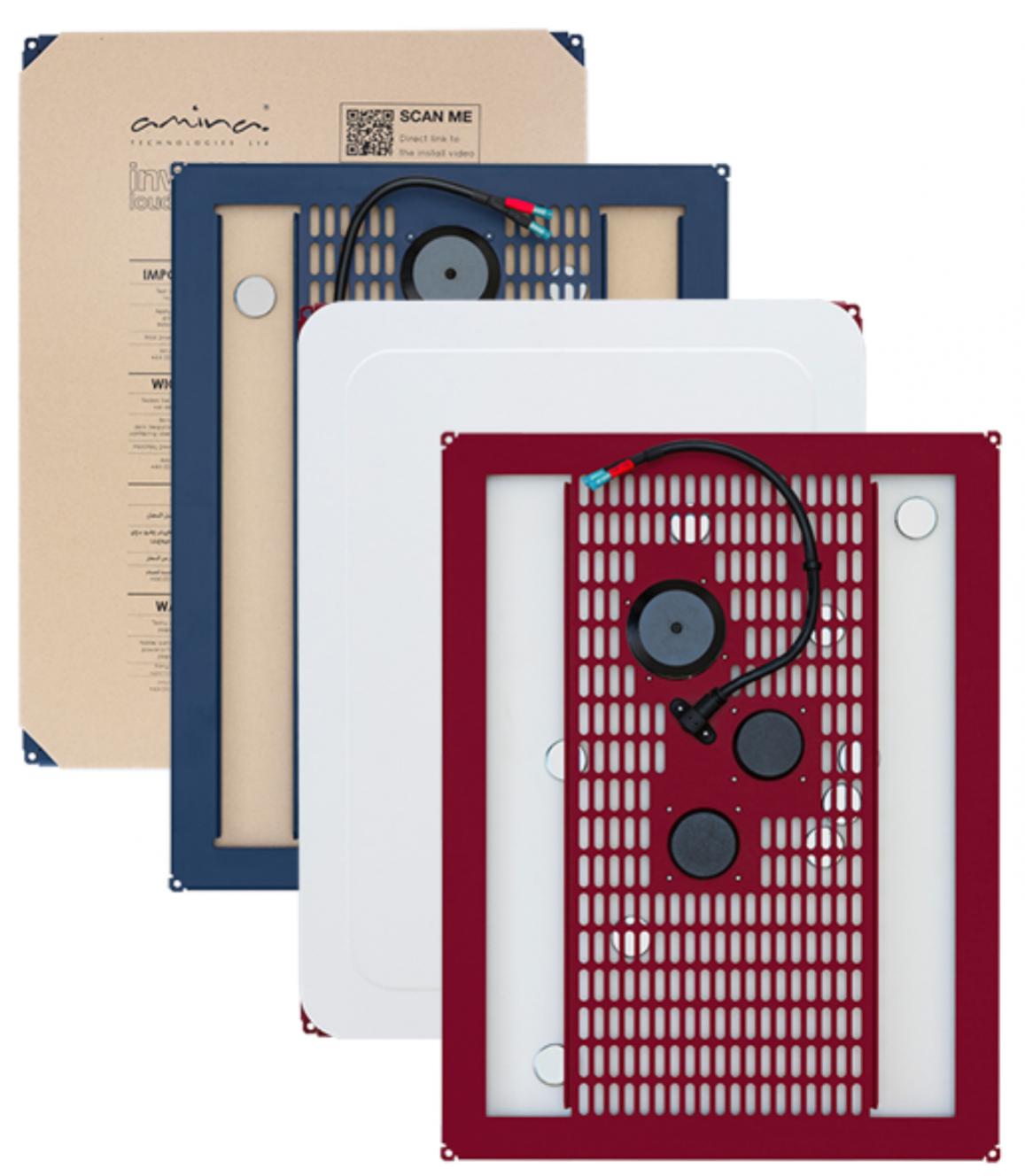

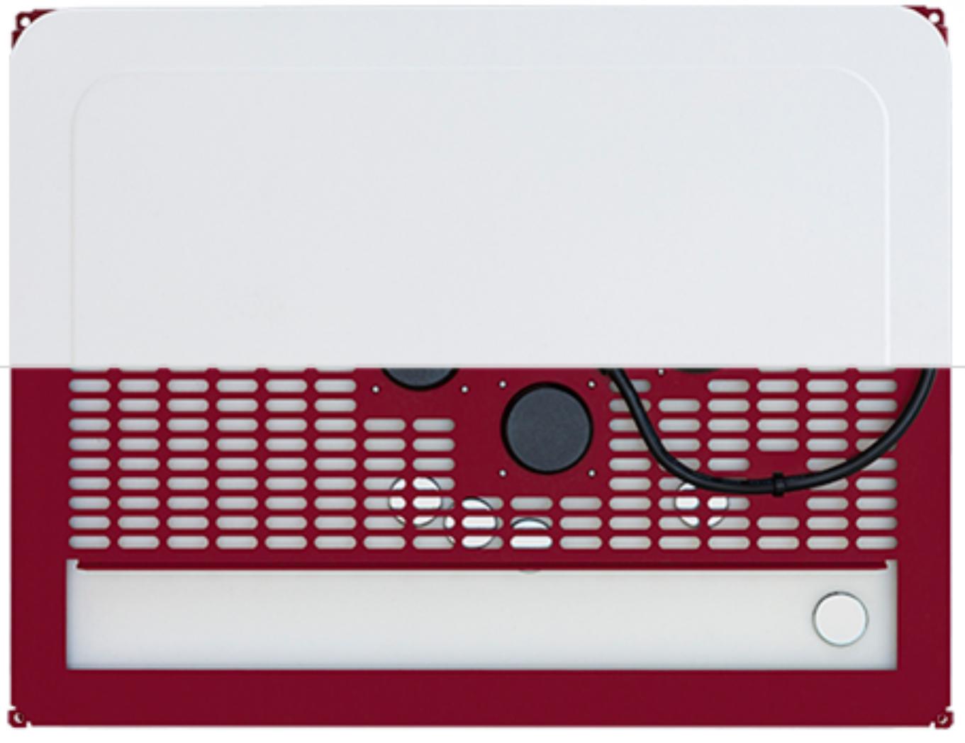

You're right. Here are photos of Anima panels and one Billionsound panel. Panels advertised as low frequency locate the exciters in the center. The Anima panel (Mobius) that advertises "incredible high frequency dispersion" moves an exciter off to the side.
The panel I'd be most interested in building is the Mobius Soundboard that advertises, "With an incredibly lightweight, stiff and resonant panel material, Mobius speakers are designed to work with the covering material to produce incredible high frequency detail and extension. When paired with a discreet subwoofer, Mobius speakers offer the highest performance characteristics of any invisible loudspeaker."

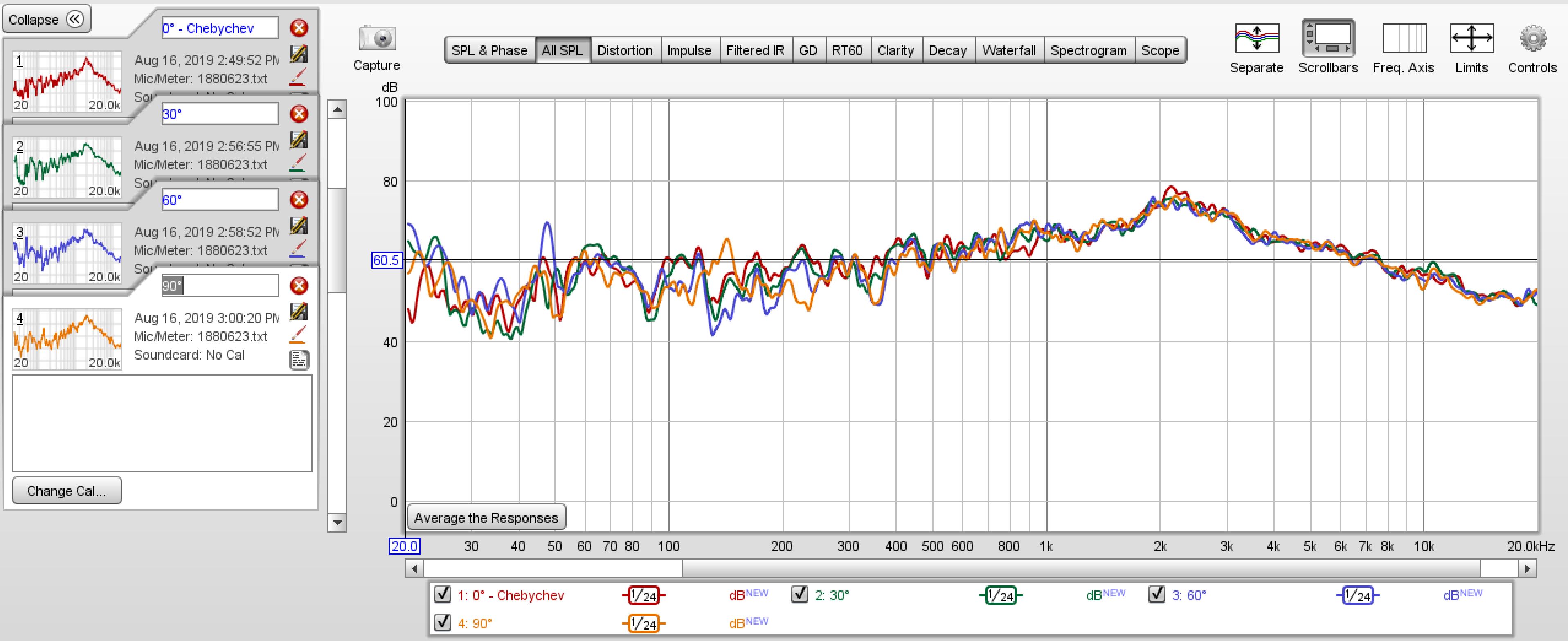

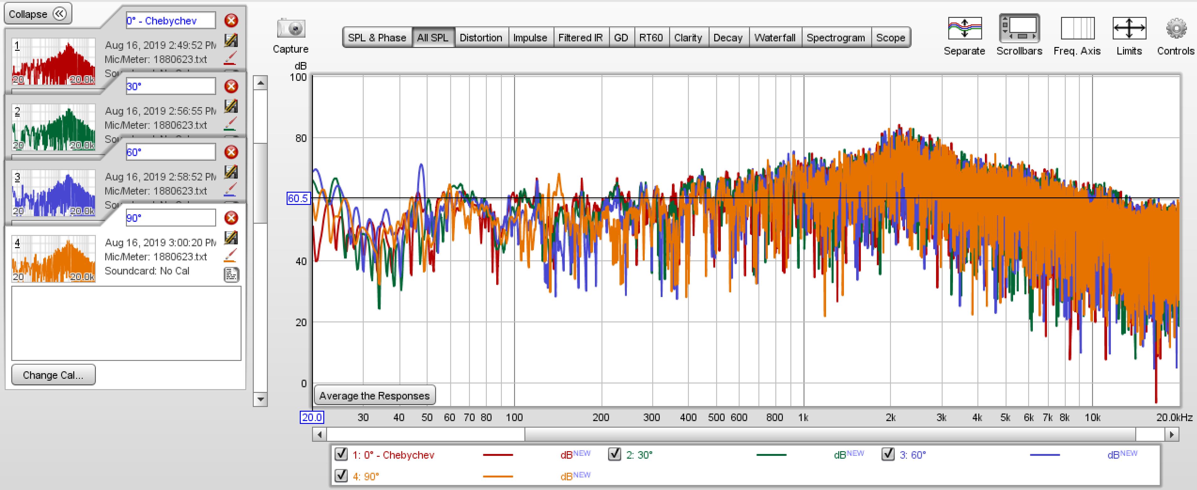

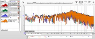

In a REW graph, I think that's recognized as an extremely jumpy frequency response. I suspect that if we could isolate the initial impulse of the drive point (or measure an infinite panel) it would look like a normal frequency response graph. I think that's what is meant by de-correlated but I'm not sure.
It's possible that the rise in my FR graph just over 2K is either a correlation between the initial impulse and the modes or it is a standing wave, or those two terms are different ways of saying the same thing.
What I want to know is have you heard those speakers in person?
A lot of speaker manufacturers will claim there product as the best. What other type of invisible loudspeaker did they compare there product to?
Second you keep on calling them Anima but it seems like they are called "AMINA". There are videos of Amina invisible speakers on youtube but most wont find them if spelled Anima. LOL Amina uses aluminum honeycomb that looks to be 1/4 or even 1/8 inch thick.
YouTube
You should audition the mobius sound board before you plan to duplicate it as you could be very disappointed.
It would be helpful to plot these at 1/12 octave filtering. Otherwise the hash just overwhelms and we can’t see the comparison.

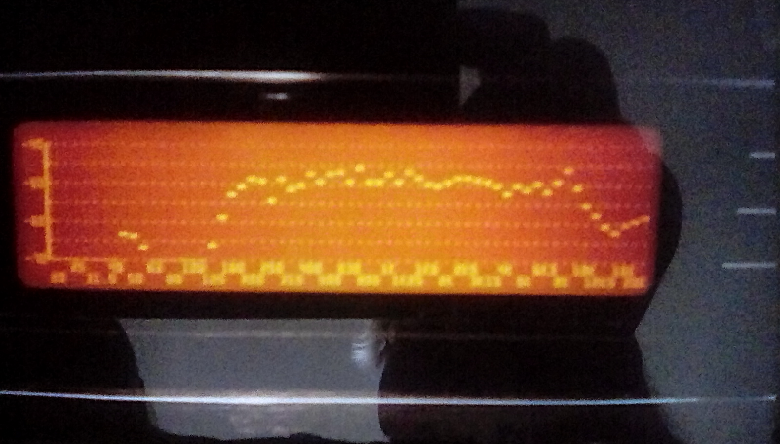

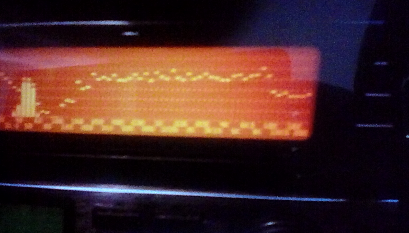

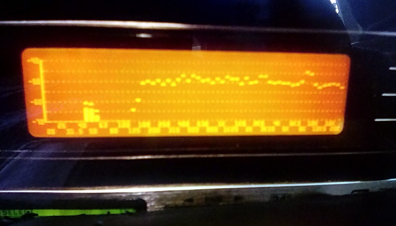

Anyway here are some pics I hope.
Yes hooray.
The first from left is a very old 170cmx60cm x25mm eps panel 70 grade I think ,I sanded down the panel but never got round to re-coting the sureface ,large panels are hard work! And messy .
Distance is 1ft approx,in front of exciter.
Second pic is the same panel but an inch of two to the left of exciter,also 1ft.
Third pic is same panel but now at least 10ft back into room near seating position,I have rolled off the response below 150hz on all pics to simplify the view ,sorry about quality of the pics as I had to take photos of my phone pictures ,too large for this site!
Steve

If you guys have a microphone, get the free REW software and collect much easier to read spectrum data vs little screens on your rack mount equipment. It’s better than nothing but would be nice to see vertical axis in 5dB major ticks and frequency labeled from 20Hz to 20kHz in log scale.
I can’t really make out the units on either axis here. Maybe -45dB to -50dB vertical and horizontal starts around 150Hz and goes up to?

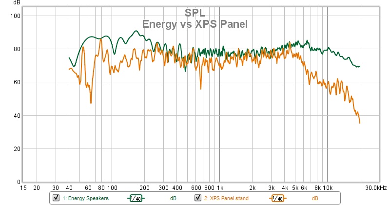

829652d1585747150-study-dmls-range-speaker-img_20200401_131152_hdr-jpg
Vs what BSP1304 posted earlier:
825288d1584307312-study-dmls-range-speaker-energy-vs-xps-panel-spl-jpg
I used this 1/24 to equalize the DSP, which does work. However, I think it's the least interesting graph in the context of a DML. Theoretically, I want to build a DML that has a solid hash all the way down to Shroeder.
